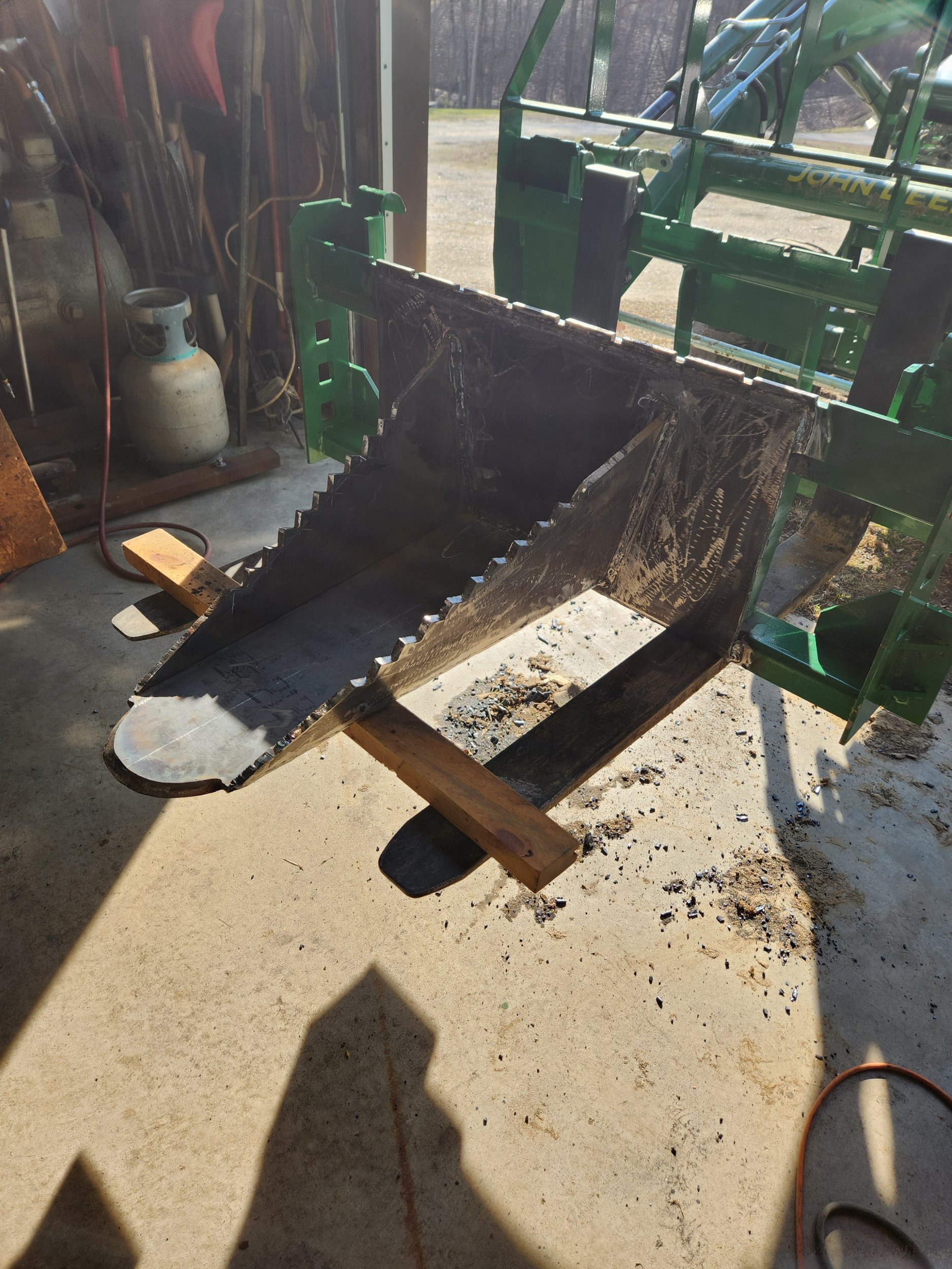

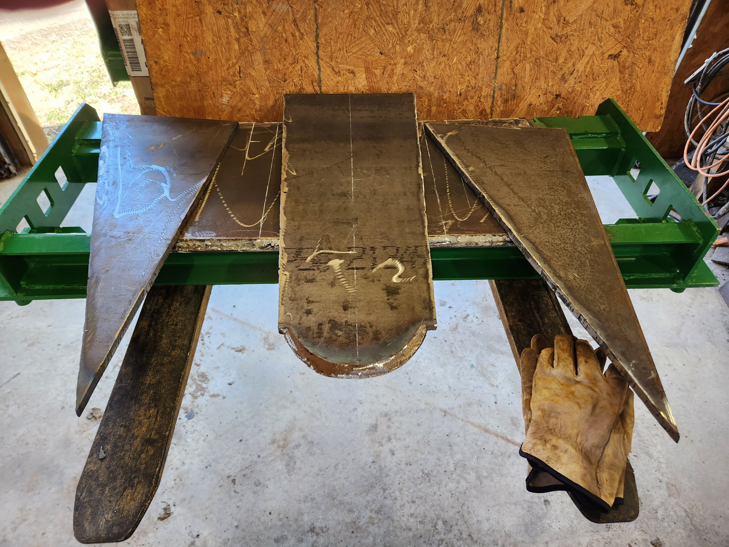

Built myself a stump bucket. I purchased a pallet fork carriage from Titan and built off of that.
1 piece of 3/8x15x30
2 pieces of 1/2x12x30 1678668303179.jpeg1678668395326.jpeg
/ Stump bucket build
The only problem I have is seeing the darn thing. So sometime this week I am ordering a backup cam with a monitor from amazon. I think that will fix that problem. I will let you know in a couple of weeks.

^ A machine that size might be able to make good use of a longer curved bottom stump bucket like a skid steer would use. Either way, maybe consider a ripper tooth for the backhoe?
Loghomeguy, i like the bucket! One thing you might try (can also do this with forks) is just lift the loader higher and tilt the bucket way down so you can see it ‘under’ the fork frame, and once it has made contact in the desired spot drop the loader and curl bucket up simultaneuously. This is basically what we do with a handheld spade shovel anyway.

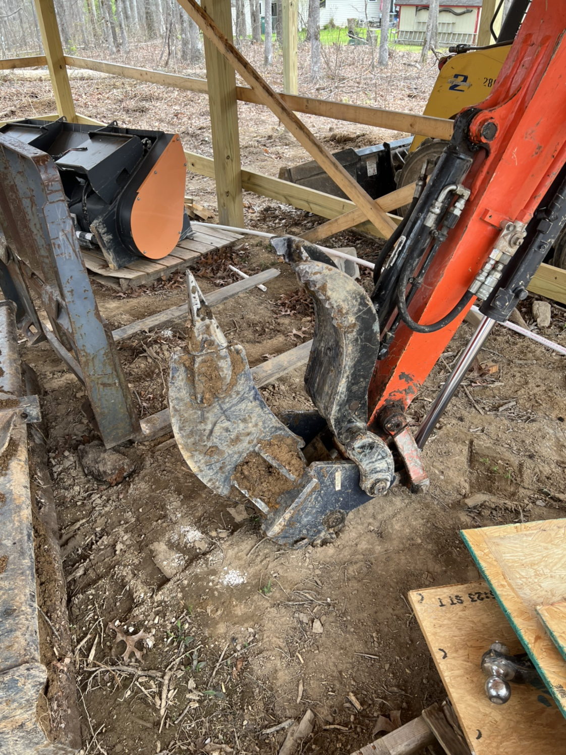

Vigo327,
Like this? Playing around earlier this year.

does that thing have multiple teeth on it? Trying to figure out what's made onto the side there..
Vigo327,
A different pic for your viewing pleasure. I modified the M59 to accept attachments that fit the Kubota mini excavator (including KX121, KX040,KX71,KX91,KX033, U35 ) so I could buy and use all the many different quick attach attachments ( buckets, ripper, rakes, SSQA plate, Post Hole Auger... ) designed for the very common Kubota mini ex machines. Costs for the mini ex tools are much lower than M59 specific tools because the quantity of mini ex's in use vs the small number of M59s. Kubota's quick attatch coupler, specific for the M59, is unique and does not couple to the mini ex tools. The ripper tooth has single 1 inch thick blade of AR 400 steel with replaceable tooth.
I have my backup camera installed and love it. It is not only good for seeing the stump and the stump bucket, but also good for hooking up the attachments to the bucket. I highly recommend it to anyone that can't see over the hood.

Vigo327,

Vigo327,
It took a little bit longer than expected but my dealer got my ripper in today.
/ Stump bucket build #18
I keep looking at that custom quick attach and wondering if it could be made so that implements could be attached pointing either way. Not sure exactly why one would want a ripper tooth pointing the other way, but maybe.
rScotty,
I am currently looking at what is involved with being able to couple up attachments in "reverse". The custom quick attach coupler is a standard KX 040 coupler with "custom" pin bosses to fit the M59 and the coupler does not change the leverage arms so the "custom" coupler is not less or more powerful in its curl force. The problem with "reversing" an implement is the hole for the manual pin no longer lines up. Changing the coupler by adding an additional pin hole to line up with "reversed" attachments would limit curl in due to linkages and adapter trying to occupy the same space. I would like to be able to use buckets in "reverse" position so the bucket mouth is facing away from tractor when working at the face of a dirt bank.
Smokeydog recently purchased a SSQA plate that attaches, in reverse, to the custom M59 coupler, which opens up a whole new realm of attachments. I have a McMillen X1475 that mounts to SSQA and I use on the FEL. Mounting the auger on the hoe, using the reversed SSQA, would allow me to drill holes much further away from tractor. Installing fence on steeper slopes and banks now can be done by machine.
