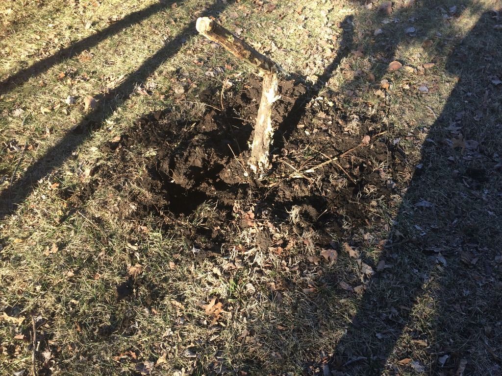

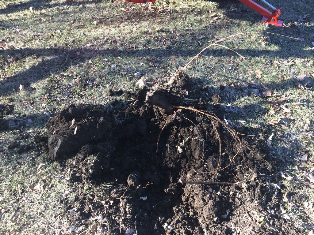

Yesterday, I did my first small project. I cut a small locust last spring and decided to dig it out. I have summarily destroyed all the grass within two feet of the stump, but it's out, now! I was a little disappointed in the digging power compared to another BX25 I have played on. Some of that is likely the roots, other is the operator. The rest might be low PSI in the PRV. See below.
After about 20 minutes, I had to go get the grease gun. One of the joints started squeaking, so I filled it up, more. They were all already filled, to where I could see some coming out, but this joint was quickly ready for more. It was the joint on the bottom of the boom. I hit them all, again, and found a few took a few squeezes, before I could see movement.
Here's after scratching the surface:
When first removed. The stump is sitting on top.
