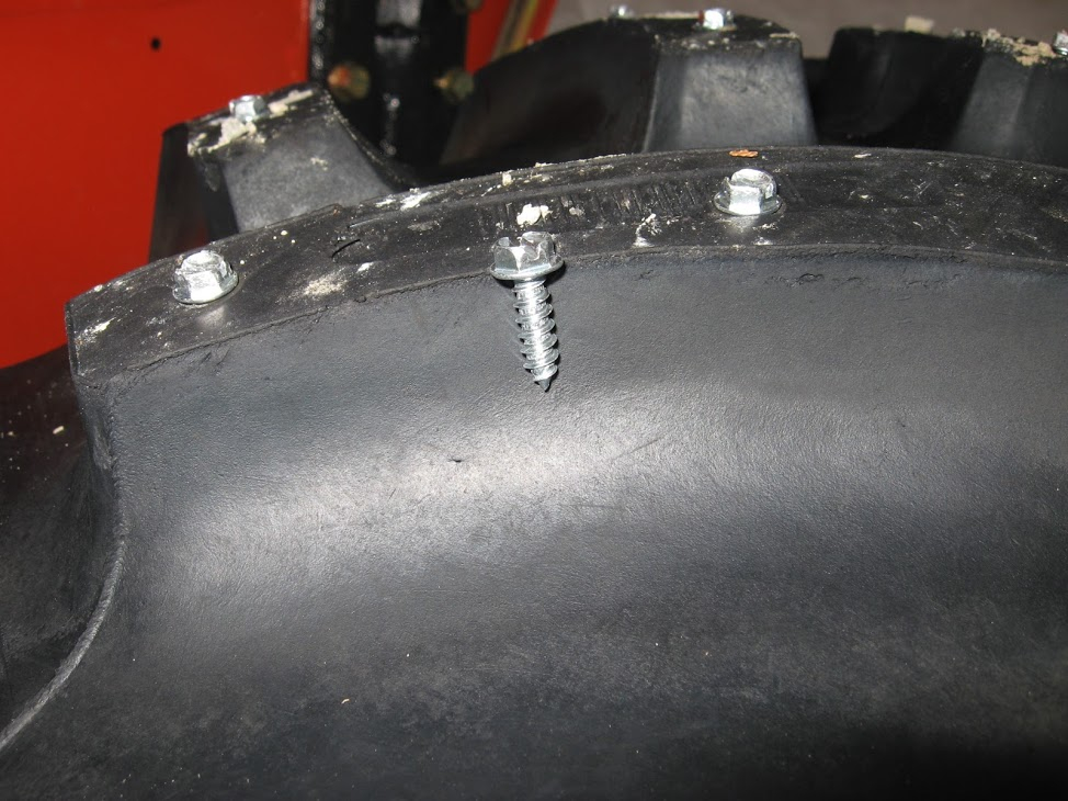

   / Studs vs chains for tires #24
I just use hex head sheet metal screws for my driveway, $20 box of 100 per rear tire, and I use smaller ones in the front. They don't seem to wear enough to matter so far in the 4 or 5 seasons I've used them. I think they are hardened a bit as they are self tapping. No need for carbide studs IMO unless you road it a lot. I haven't lost one yet either that I know of. I think if I used them in the woods in the winter I would have to careful spinning and catching them in roots, but I don't take my tractor into the woods in winter. I have one section of my driveway is maybe 10-12% grade and I can go up and down that on glare ice, not with a whole lot of traction to spare but I have dragged my car up the hill to get it to the road.
