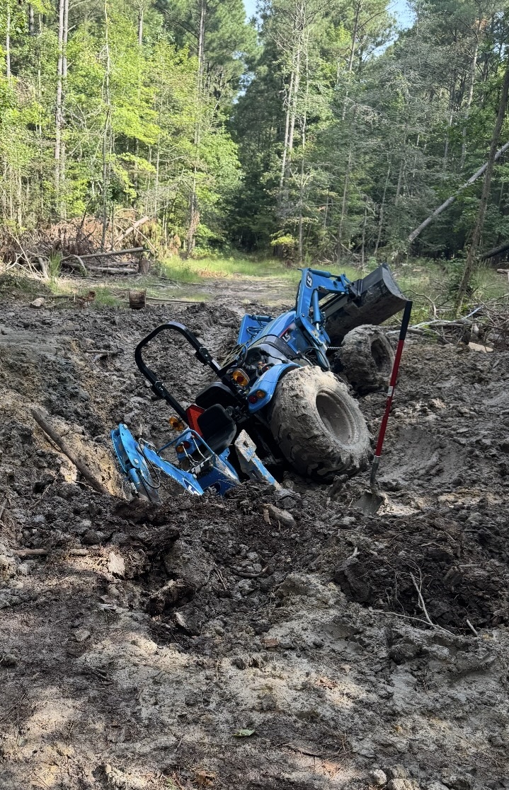

And for everyone else waiting on pictures. The rain came through Sunday and fortunately I managed to backfill the spring I dug on Saturday so it didn’t go submarine. In fact it looks like the rain managed to wash out most of the soft stuff.
My wife got down today to check on it - I will have to wait until Saturday to get the winch and snatchblocks down…View attachment 4044142
Is the ground to left to soft for backhoe to lift the left rear up out of the muck? Presume yes but hard to tell from picture.

Any concerns about it rolling over as it gets extracted? Looks like it will right itself as it is pulled out.

Can't you put down the outrigger to help straighten things up?

Kind of read most of your predicament, your stuck in a wooded area, correct? You have lots of hydraulic operated equipment on the tractor itself, I'm I missing something? Why can't you build up the soft ground under these hydraulic attachments with logs so either your fel, bh, or bh stabilizers will lift the wheels enough to put wood under them? My methods worked for me in the past it requires some manual labor and a chain saw but at least you don't have to shovel mud much, if at all, plus you don't have to worry as much about damaging tractor or vehicle with winch, if trying to break it loose to pull it out.

Digging a watering hole for deer (low lying land, water table is just six or so feet down). Going great, hit the water - now to clean up the dug out slop. That’s where the “fun” started. Using the bucket to smooth it out and 1.5’ from the hole was too close, all tires stuck and just a bit of spin and I slide backwards/left into the hole. Three tires are out of the hole - but rear left and the backhoe are in the hole. LS 342 shuttle shift
Tried hooking a chain to my 2500 Cummins but couldn’t get enough traction.
Debating whether my 12k warn and a snatch block will do it. Oh! And now it’s raining so move quick before half the tractor starts practicing to work as a submarine… 🤦‍♂️

you can't pull it out using the backhoe & loader?

Your 12K winch with as many "snatch blocks" as necessary will work!

Load the 2500 truck with something.

Would it be possible to attach a 2x12 to the the buried wheel face and slowly rotate that wheel to "paddlewheel" your way out?

Boards are your friend. Get as many boards and pieces of plywood you can find. Lift the outriggers and put wood under them to spread the pad out. I've done this with a full size backhoe that was nearly rolling over in the mud hole. The last thing I did was slide the outrigger along boards using the hoe, the bucket and reverse.

Using snatch blocks is a good possible solution. For each line part you add (a snatch block) you gain almost the winch rating in pulling force. So 2 lines/1 snatch block=24,000 lbs of pulling force; 3 lines 2 snatch blocks=36,000 lbs. The drawbacks to using snatch blocks is to move 1 foot of distance for the stuck vehicle is you 1 foot times the number of lines of cable, and having enough cable to keep the rescue vehicle safe from getting stuck also.
