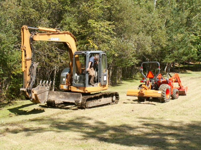

I have an old Case 580CK. It's a two wheel drive machine. I have gotten it stuck plenty good several times and I was always able to get it out using the hoe and the front bucket. One thing that really helped was lifting the rear wheels free of the ground and then shifting the machine sideways using the hoe. Then setting the rear wheels on better ground. Then push with the hoe and pull with the bucket. Rinse and repeat until the machine was completely free.

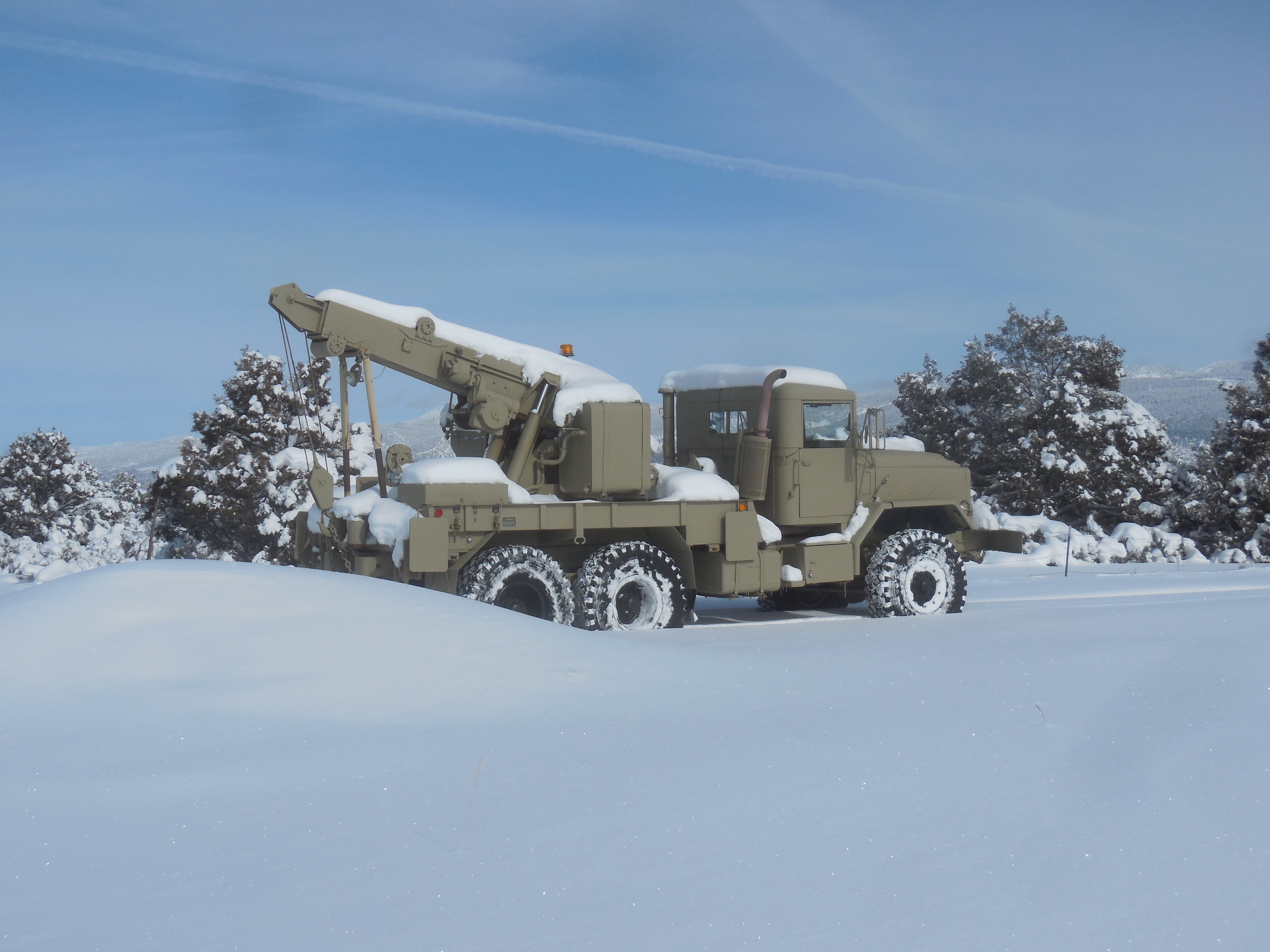

Does that truck have some kind of anchoring system, so it doesn't just pull itself toward the stuck vehicle?
Bruce

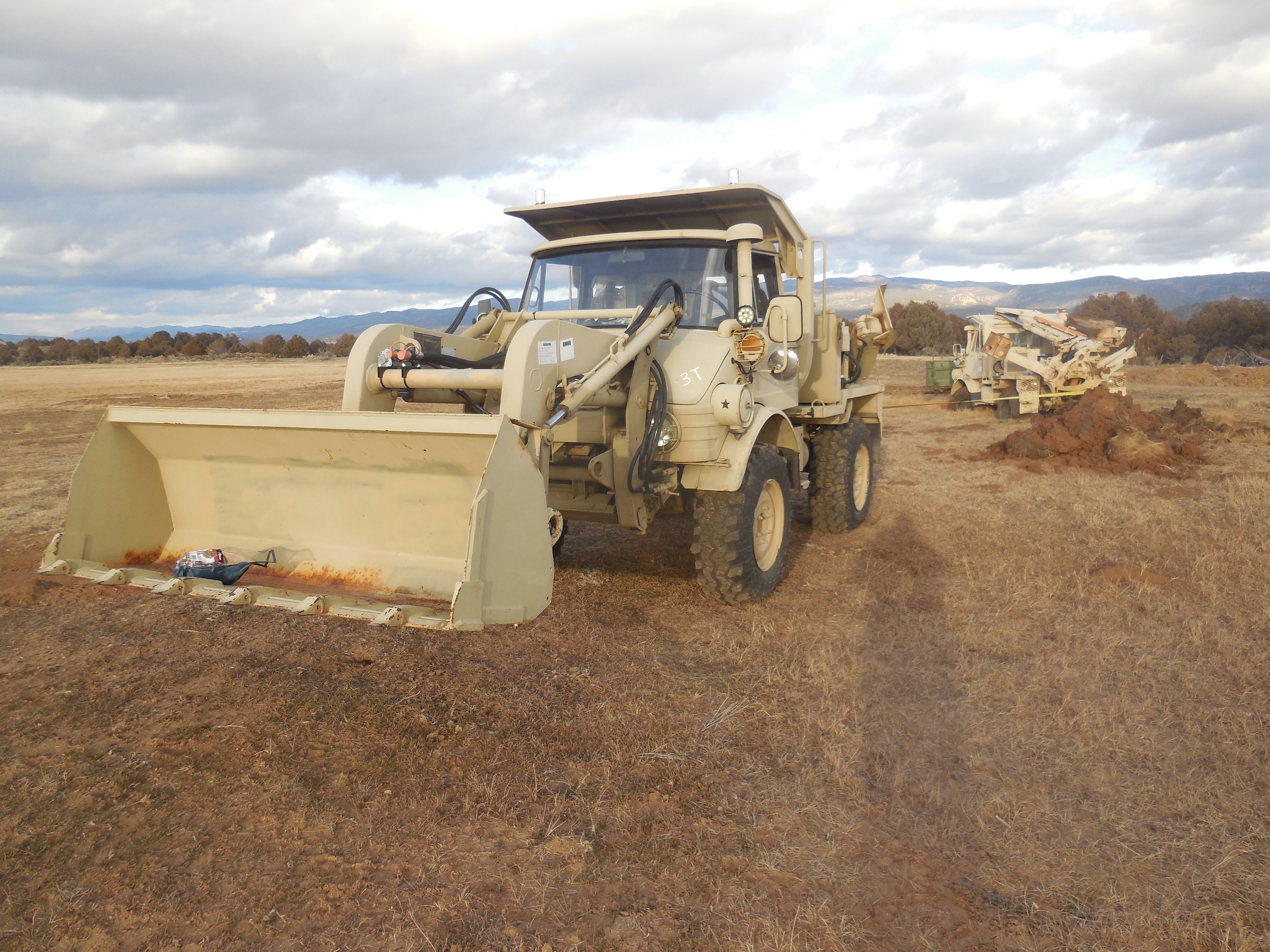

It does, but I've never used it. It'd be easier to hook the front winch or a strap to something, like one of the 16,000-lb. Unimogs.
Besides, with good tires and weighing some 40,000 lbs. it can surely pull quite a bit before starting to move. Haven't reached that point yet.

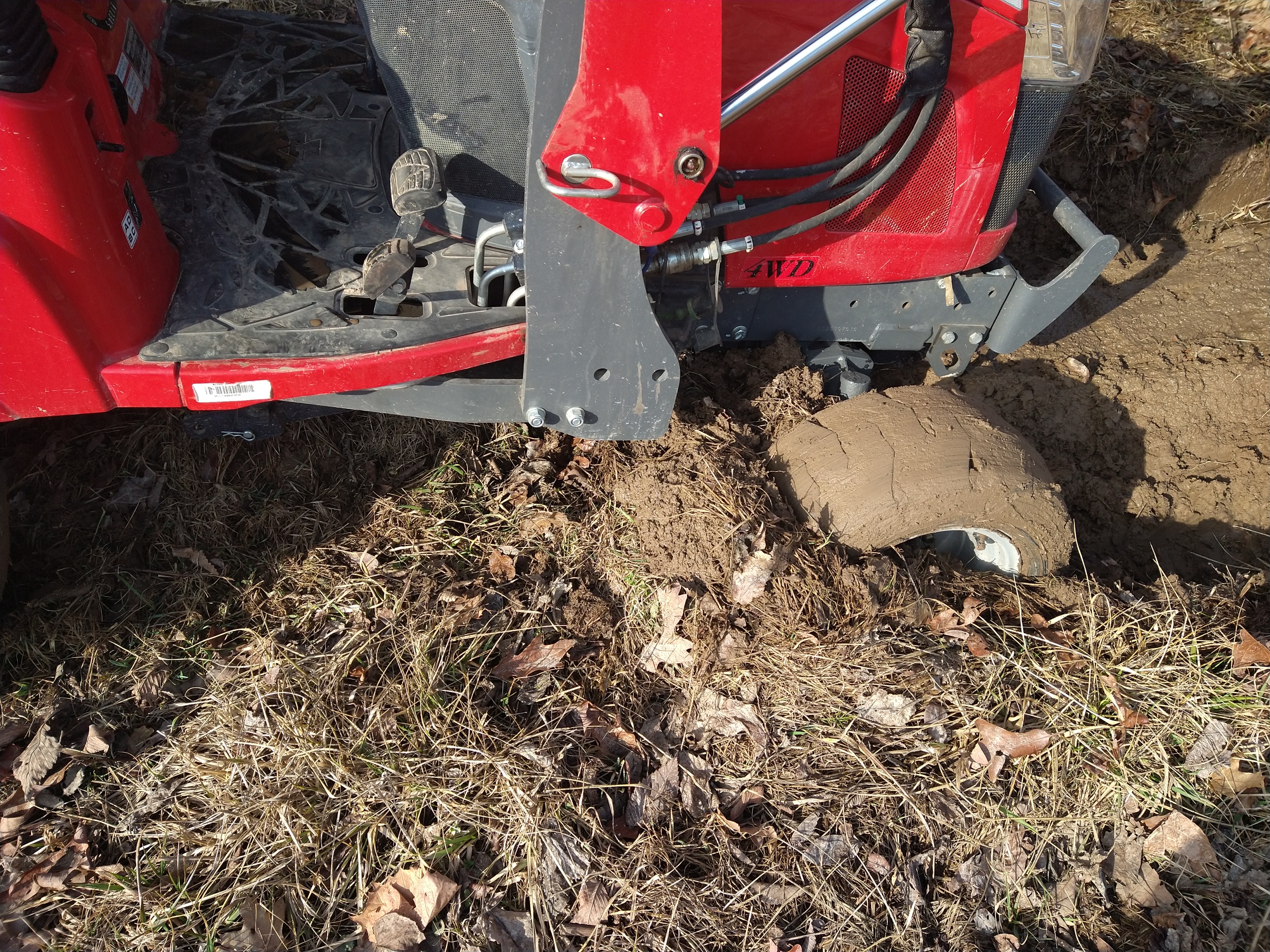

Have we even seen pics of the OP's predicament? How do we even know he is stuck without pictures? I low-key enjoy seeing pics of people hopelessly stuck. Not because I revel in their misfortune, but it just blows my mind the situations people put themselves/get into.

Waiting for the picture.
And for everyone else waiting on pictures. The rain came through Sunday and fortunately I managed to backfill the spring I dug on Saturday so it didn’t go submarine. In fact it looks like the rain managed to wash out most of the soft stuff.
My wife got down today to check on it - I will have to wait until Saturday to get the winch and snatchblocks down…
