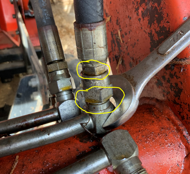

I have to rebuild my bucket curl cylinders due to leaks. Of the eight connections I have to remove to also change four hoses, one is stuck.
The 7/8" wrench pictured is just there to keep me from twisting the tubing while trying to figure out how to loosen the fitting.
I've tried a soaking with PBBlaster and putting both a 7/8" and 11/16" wrench on the two nuts and trying to pull them together.
I tried a rubber mallet which had no impact on loosening the fitting in the lower yellow area.
I sure would appreciate any guidance on how to get this off while still on the tractor.
/ Stuck loader fitting - how to loosen #2
Those look like swivel connections but possible someone over torqued or added locktite. Maybe a little heat but have to be careful to not burn the oil.

Going out to try both ideas now ...

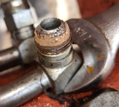

Well, both worked. I'm not sure which one. I tapped it with a ball peen hammer and then heated it up for no more than 15 seconds and I was able to get it off.
Unlike the seven others, it turns out this has rust on it which explains a lot.
I couldn't afford to break that aluminum tubing so, as always, thank you!!
/ Stuck loader fitting - how to loosen #6
That's not aluminum tubing, its steel. That dry ring of rust is also why putting oil on it wasn't going to work. Wack it with a hammer or as a last resort heat it.

Well, in that case, how would you remove the rust from the fitting?
/ Stuck loader fitting - how to loosen #10
When hammering on something like that using a backup hammer may be a good idea.
/ Stuck loader fitting - how to loosen #11
Plug the hole with something like a piece of cloth and use Scotchbrite first. If that doesn't clean it use some emery cloth.
/ Stuck loader fitting - how to loosen #12
I have just used a wire brush to clean the rusted male JIC fitting. Dont go to aggressive as the chamfered edge is the seal.
/ Stuck loader fitting - how to loosen #14
If you have a next time hold the lower nut and try to loosen the top nut in your highlighted post. If you have a Dremel tool insert a home made from a wooden stick, wooden peg in the opening at the top and clean away with the Dremel round wire brush wheel. Or use a wire brush wheel made for a electric drill.
