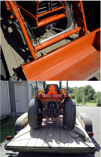

So where do you run them?
Chains, with regular binders, don't use a cheater bar. D-rings on the front and into a stake pocket on the back.
On the rear of the tractor I insert a big clevis ring into the draw bar. The front goes thorough the pipe in the frame for the FEL. That's where my dealer said they put them when they transport. When I'm hauling my landscape rake in the front of the trailer, with the FEL bucket upside down and resting on it, the FEL frame pipe is to high to easily run it through there, so I run it over and behind the frame bar that is in front of the grill that joins the two sides of the frame together. I'm not happy with this because it beats up the frame piece. I'd like to use a clevis here to, but there is no place to put one.
Where are you guys running your chains and straps?

Turfman,I run my chains thru a clevis on the drawbar in the back and a clevis thru the front frame on the front. I had to drill a large hole in the frame front for the clevis to fit. (See photo attached) I have been using some old chain and binders that my grandfather gave me years ago. Broke one binder, and the chain has been spiced together many times, and of unknown grade. So I went out and got two 20' grade 70 5/16" chains and two ratchet binders. I was hualing around over 20 grand worth of equipment with junk chain and binders because I was too cheap to spend the $100.00 to get the good stuff. What conviced me to do it was when I broke a binder. The pin where it hinges wore right out. Thank god it happened when I was putting it on, and not while transporting the tractor! Buy the good chain and binders now and you will have them for the rest of your life, and will not have to worry anymore!

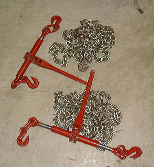

<font color=blue>"I was too cheap to spend the $100.00 to get the good stuff"</font color=blue>
Look <A target="_blank" HREF=http://www.mrproducts.com/combotiebacks.htm>here</A> at the bottom of the page to see what $85 will buy you.

Gary, Those are nice, but they only have a working load limit of 3300 lbs. Where the chains I got have a working load limit of 4700 lbs. Plus I don't have to worry about cuts or fraying with the chains. I keep them inside, so rust and dirt will not be a big issue for me. Total cost was under the $100.00 for all and they will last me for ever, I can't say that about the straps. (see attached photo)
