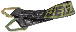

I use straps for the very reasons you prefer chains. At the end of the day I'm hot and tired and don't feel like messing with heavy, loud, dirty chains. My straps are light, clean and don't sound like a load of bolts in a metal box when I toss them on my diamond plate trailer bed.
I have eleven D-rings so finding an attachment point is simple. My sleeved axle straps make contact with the loaded vehicle (my straps do not). I pull the excess strapping through the ratchet and then ratchet it tight. I only need to use the ratchets on one end because the other doesn't need to be ratcheted down, only strapped down. <A target="_blank" HREF=http://www.mrproducts.com/combotiebacks.htm>Tie back straps</A> are ideal for this. With those, especially, I find straps far quicker to use.

<font color=blue>"I was too cheap to spend the $100.00 to get the good stuff"</font color=blue>
Look <A target="_blank" HREF=http://www.mrproducts.com/combotiebacks.htm>here</A> at the bottom of the page to see what $85 will buy you.
   / Straps or Chains (or is this too personal?) #49
Re: So where do you run them?
Gary, Those are nice, but they only have a working load limit of 3300 lbs. Where the chains I got have a working load limit of 4700 lbs. Plus I don't have to worry about cuts or fraying with the chains. I keep them inside, so rust and dirt will not be a big issue for me. Total cost was under the $100.00 for all and they will last me for ever, I can't say that about the straps. (see attached photo)

I'm under the impression the 10,000 lb. rated straps have at least a 4,700 lb. WLL, but I could be mistaken. I know that 5,000 lb. rated straps have a WLL of 3,300 lbs. If the percentage holds true, then the 10,000 lb. rated straps would have a 6,600 lb. WLL.
   / Straps or Chains (or is this too personal?) #53
Gary, You may be right, I'm just going by the Northern catalog. In there the 10,000lbs. straps have a working load limit of 3300lbs. But It could just be the brand that they sell has that rating. Yours may be way different. But I still like my shiny chains, and new binders!/w3tcompact/icons/smile.gif
