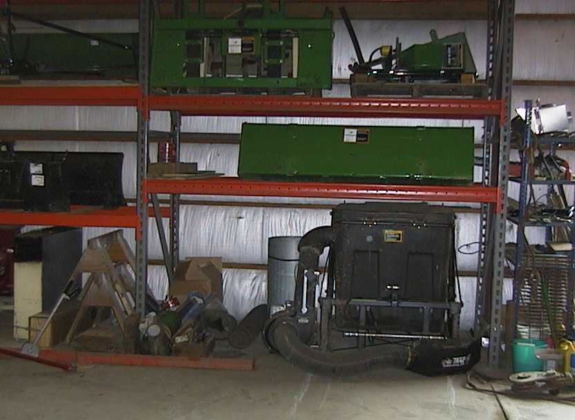

With storage space such a concern for most of us and the number of implements always increasing I had a thought I'll throw out for discussion. Has anyone considered going up instead of out for additional implement storage space?
Currently, when we aren't using an implement we set it on the floor of the barn and tie up whatever square footage it covers. For the sake of discussion lets look at a finish mower as the largest piece and say it's taking up an area of about 50 sqft. (approximately 7'x7'). Worse than that it's taking up 700 cuft. if you have 14' truss height inside.
My idea is to use something like industrial pallet racks so you can store implements ABOVE that. /w3tcompact/icons/clever.gif The mower is only going to take up 4' of height at the most. If you put the first shelf at 4' then you have a place to put your brush hog secured to a pallet. Another 4' up is another shelf on which you store your box blade secured to another pallet and your tiller on yet another pallet. Viola' You have stored four implements in a 7' x 7' corner of your barn! Pretty cool, huh? /w3tcompact/icons/cool.gif
Of course, there are more than a couple assumptions or prerequistes here. One is that you have a FEL capable of handling the weight of the palletized implements. Another is that your FEL will reach high enough to get to your top shelf and lift that pallet off. Yet another is that you have a set of forks for your FEL.
Assuming your FEL is up to the task I'd think the cost of the racking and the cost of a good set of forks (which, of course, could and likely would be used for any number of other tasks) would more than outweigh the cost of adding an additional 100 square feet to your building.
The "economy" version of this would eliminate the forks, the pallets and the need for much working height on the bucket. You could just use a single shelf and store two levels. The implements on the floor you could back to and hook up to pull them out before completing attachment. The ones on the shelf you could lift off with your bucket and some chains or straps. It would still save half the floor space you're now using.
Any other thoughts on this? I just thought it would be something I'd like to do when I have the slab poured. /w3tcompact/icons/smile.gif

that is exactly how I store my implements and anything else I can put on the pallets. I have pallet racks set up against the side walls of my building, with 2 levels of shelves, which gives me 3 storage spaces. Right now I use pallet forks to set everything on the racks but have thought of attaching the JD Imatch quick coupler to the FEL, and use it to set the implements that way. Now doesn't that give you thoughts of using 3 point implements on the FEL? Storing implements this way, opens up a lot of floor space and does not take that long to put up or take down anything stored on the racks.

Now let me ask you if you can post some pics of your set up. I'd really be interested in details of what you used and how you set it up. Thanks.

   / Storing Implements #18
Gary and Phred,
Here is a picture of my pallet rack. I have 9 implements stored in a area of 18' x 4'. The posts are rated at 18,000 lbs and the beams are rated at 6,000 lbs. The beams in one section are 8' long and in the other section they are 9' long. You can get beams 8' 9' 10' and 12', long so you can set up these racks as you need. The tiller and spreaders are on wood pallets that i pick up at a local manufactoring plant that was giving them away. Pallet forks are stored in the pallet that the tiller is on. The bucket is sitting on four 2 x 4, the front blade is also sitting on four 2x4, the blade edge is sitting on the wood right on top of the beam, so the wood does not carry that much weight. The drop spreader is sitting on 2x4 with a sheet of plywood on them. As you can see I set up each shelf for what is stored on it. On another rack I have the wooden pallets with loads of two to three thousand pounds on them. So far no problem with the skids handling that weight. Depending how you picked up your brush hog, it could set on the beams without any pallets, using the side rails of the brush hog.
