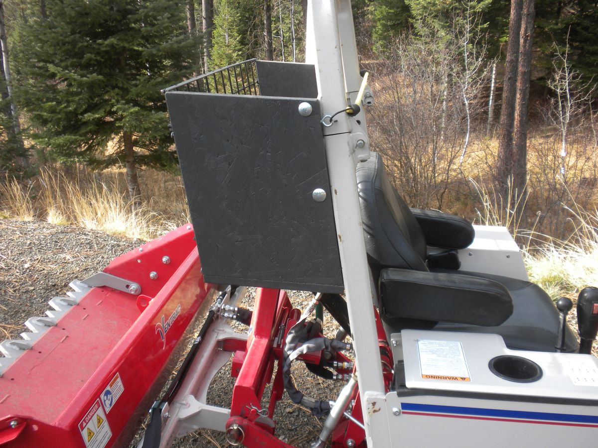

After carrying my seeder around in the bucket and successfully running it over when it fell out, I decided I needed a more secure place for the new seeder and bags of seed as I traveled around the hilly terrain cultivating and seeding.
The sides are 1-1/8" subfloor material only because that's what I had laying around. They bolt to the roll bar using the holes that are already there for securing the roll bar when it's folded down. The 3 x 3 x 1/4" wire grid material I bought on amazon. I wanted to be able to see through the box at least when I don't have anything in it. Seems to work pretty well so far.

I looked at the first 2 pictures and thought, "That bungee is never gonna hold that box in place!" :laughing: Looks good man!

Hah! Never noticed that when I took the pics but it sure looks like the bungee is supposed to hold it.

Yes its a beautiful thing, but in the even of a rollover, that box corner will dig into whatever material in on the side of the hill you flop over on. If it catches, the machine may be tripped instead of it sliding. If tripped, the tractor will/may keep rolling and go over more that once. That being the case, you may be ejected in spite of a seat belt because the roll velocity is so high. This is a problem discovered on specially equipped PU trucks that we tested when aftermarket head-ache racks, etc are installed. I'd keep the corners inward of the roll bar as much as possible.

I can picture the scenario you've described but the box would have to be really strong for that to happen. In my case there's not a lot of wood between the bolt holes and edge of the OSB sideboards and I have no doubt the box would break away as soon as it hit something. It would be something to think about if someone was building a box with steel plate sides though. Thanks for bringing this up.
