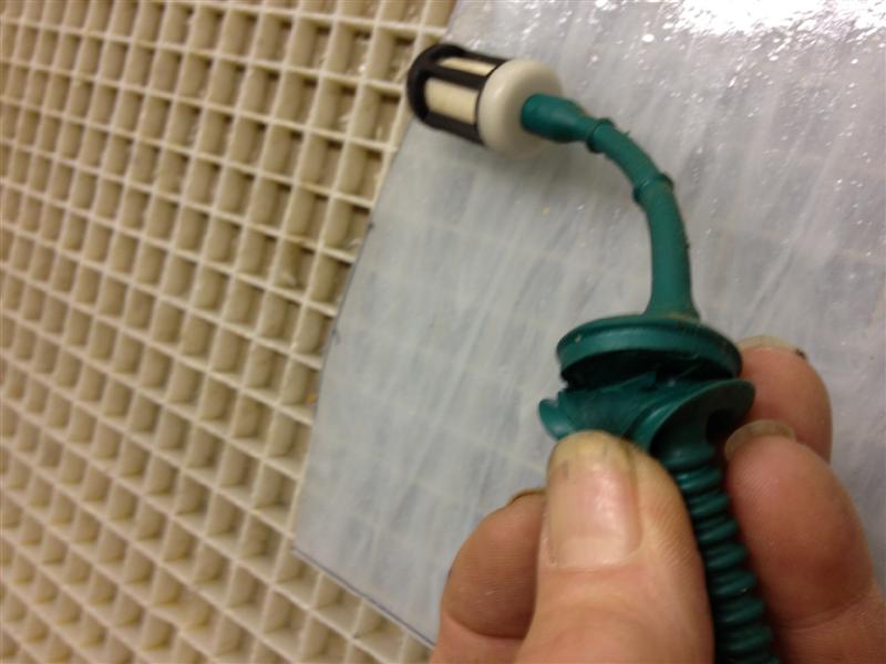

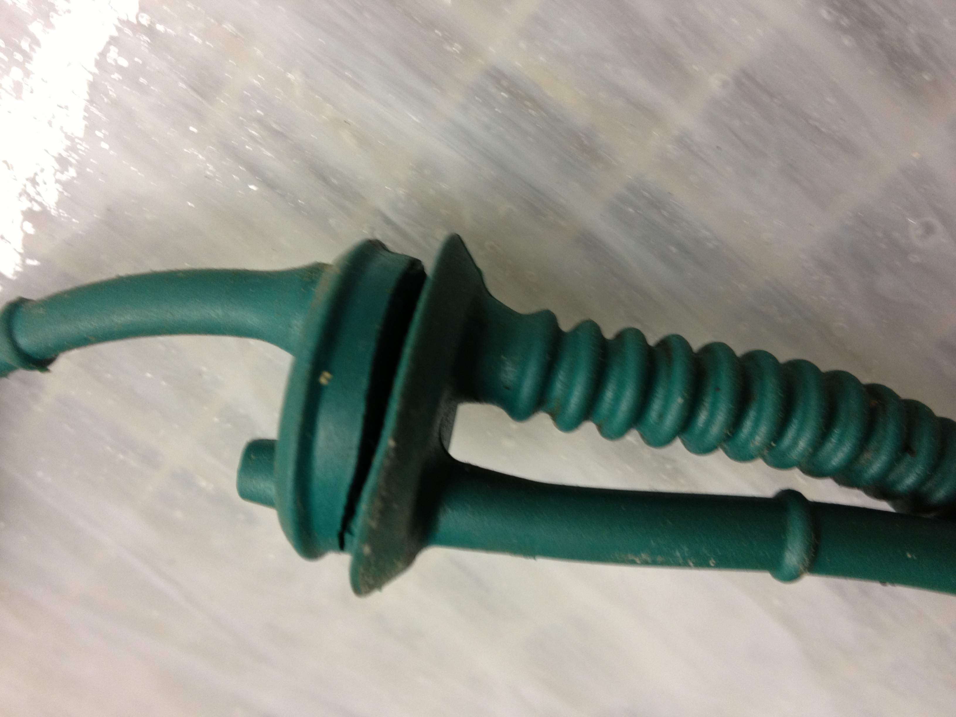

I put the new cap on along with the new gas line,super simple. Replaced several carbs & gas lines on other brands and Stihl has done the gas lines a lot better than anything that I have worked on. It took me all of 10 min. and this is the first time tearing into a Stihl. Started on second pull! I'm still in awe at the 8 week wait for a 10 min. fix.
My gas leak was not all E-10 related. (Still don't like E-10) Found out that the grommet where the gas lines goes in the tank split. And the new cap don't leak. Was there a recall on the caps?
