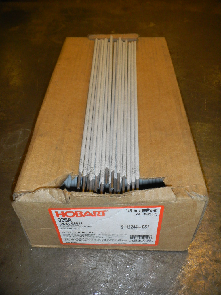

/ stickweld 140 review #34
I was just curious about the price. You are right about the flux getting knocked off. When I first started to use 7018, that's the second thing I noticed. The flux is so much easier to knock off compared to 6011. The first thing I noticed was how much larger the deposition rate was! LOL
/ stickweld 140 review #35
Nearest TSC is in the next state. Too far to go just for that. But i think I pass by when I go to my friends farmhouse in ME. I'll have to remember to stop in next time.
I don't think TSC carries the 335A. From what I can tell the packaging only says Hobart E6011.
I noticed also that their picture of it shows it as a very light color. The picture of the Hobart E6011 335A that Airgas shows on their website, is a dark gray.
Shield Arc, what is the color of the 335A that you bought?
On the Hobart Brothers website, they show the plain E6011 (made by McKay??), as well as the 335A and 335C versions.
Stick Electrodes - Hobart Brothers Performance Welding Products
I'm thinking that maybe TSC carries only the plain Hobart E6011 that's made by McKay. :confused:

/ stickweld 140 review #38

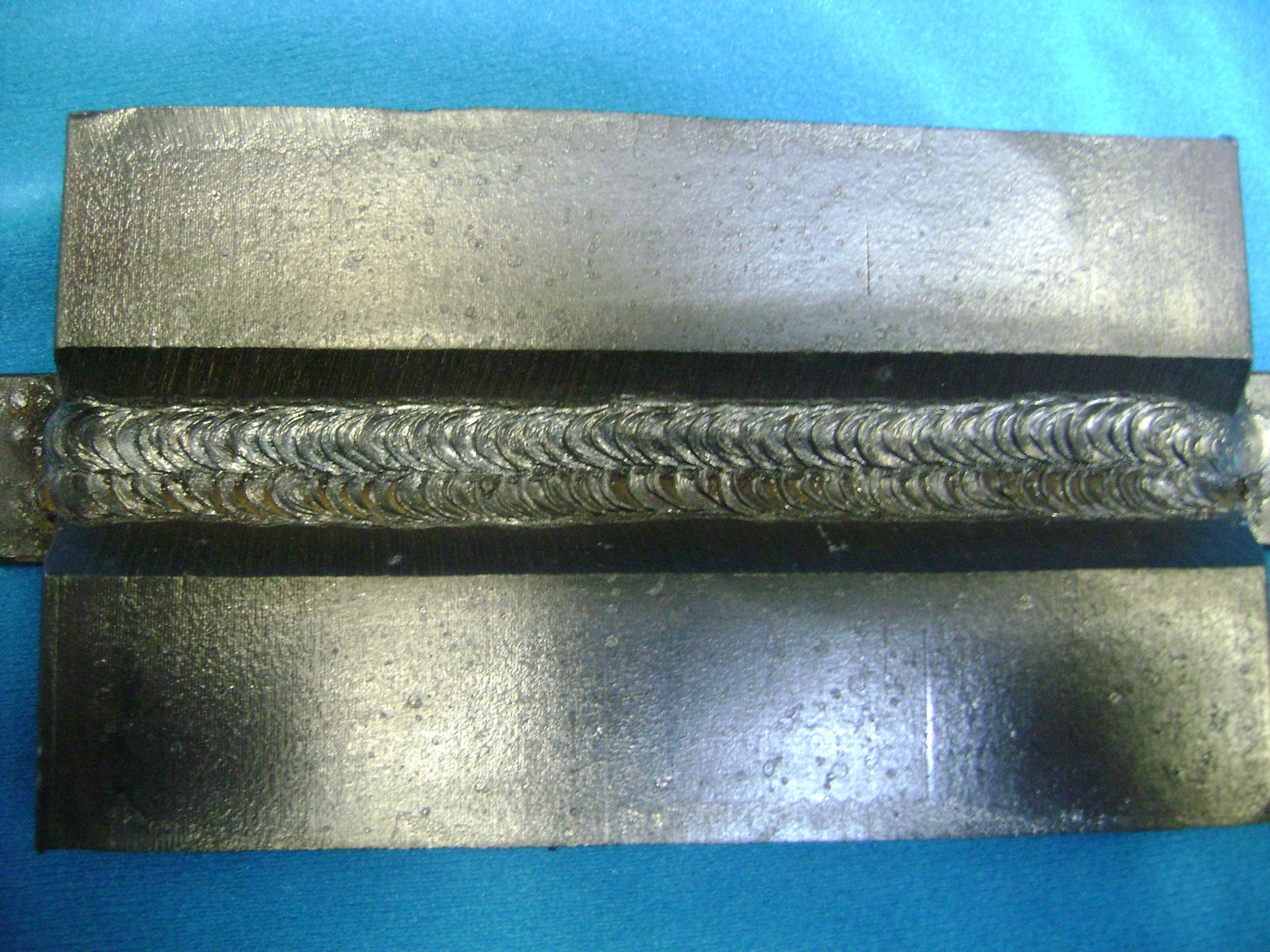

/ stickweld 140 review #40
