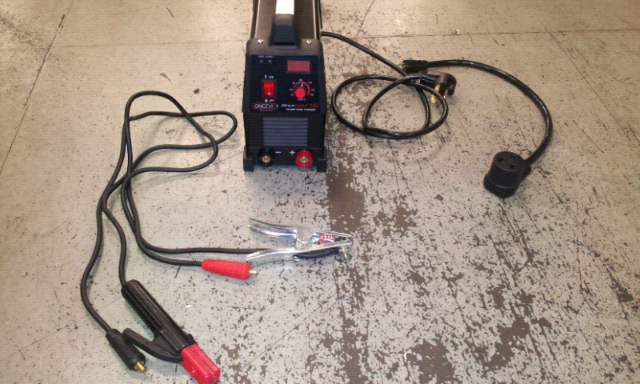

The input cord has a NEMA 6-50 plug on it, witch was a surprise, as the manual has a whole section on putting your own on. It also comes with an adapter pigtail to convert to a NEMA 5-15 plug. Nice touch. The cord has markings that indicate that it is 12 gauge wire, but when I cut off the plug and switched to what I needed, the wire seemed larger. Perhaps it is the closest metric equivalent.

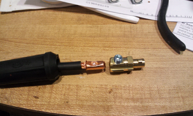

The welding leads are attached to the welder via 25mm dinse connectors. The cables dinse connectors seem to be made in Germany and are of high quality.
The ground clamp seems a little light to me, but I am used to much larger welders. It will likely be fine for 140 amps. The electrode holder is good and heavy enough, with copper construction. I cant tell what gauge the leads are, but thay are plenty big enough for 140 amps. The only negative thing I can say is that the leads are too short at about 5ft. But you can bring the welder to the work easy enough. But it is easy to change them out too, as I have already done.

The welder and leads:
The DINSE connector:

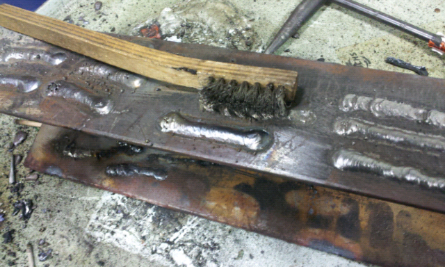

6011 top and 7018 bottom:

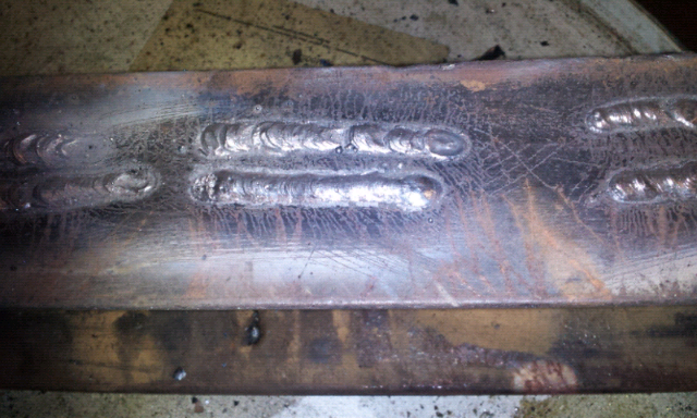

Best weld I did that day, 7018:

Those don't look bad at all, little cold though. I say this all the time, it is hard for anybody to make a weld on a flat plate look good. Do some lap joints, or some fillet welds.

Cold indeed. I measured 75 OC volts but I think the arc volts are so low that even at recomened amps there isn't that much heat. If I can get someone to help watch the voltmeter while I weld, I'll post the results. If I can I'll do the same with my Miller Dynasty 200DX an see what the diferance is.

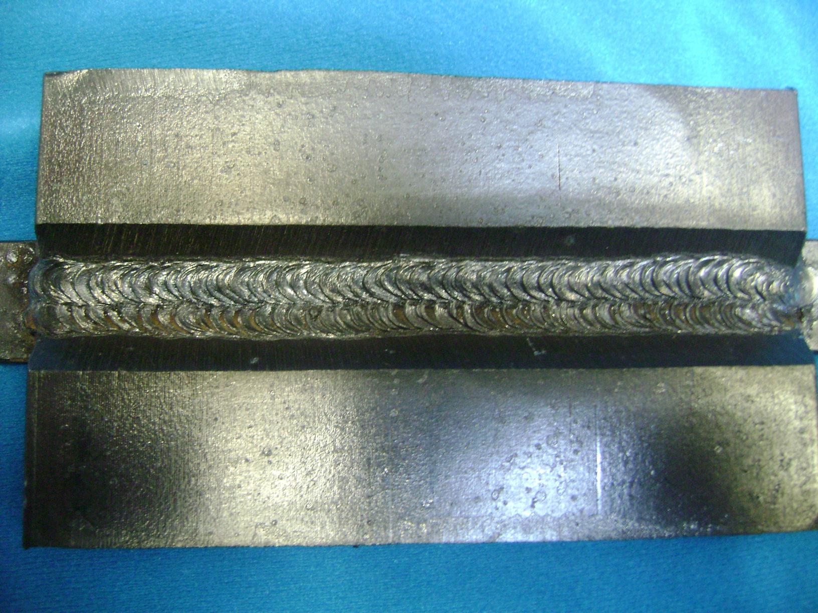

Either to cold, or your travel speed is to slow. See how your 7018 welds are humped up?

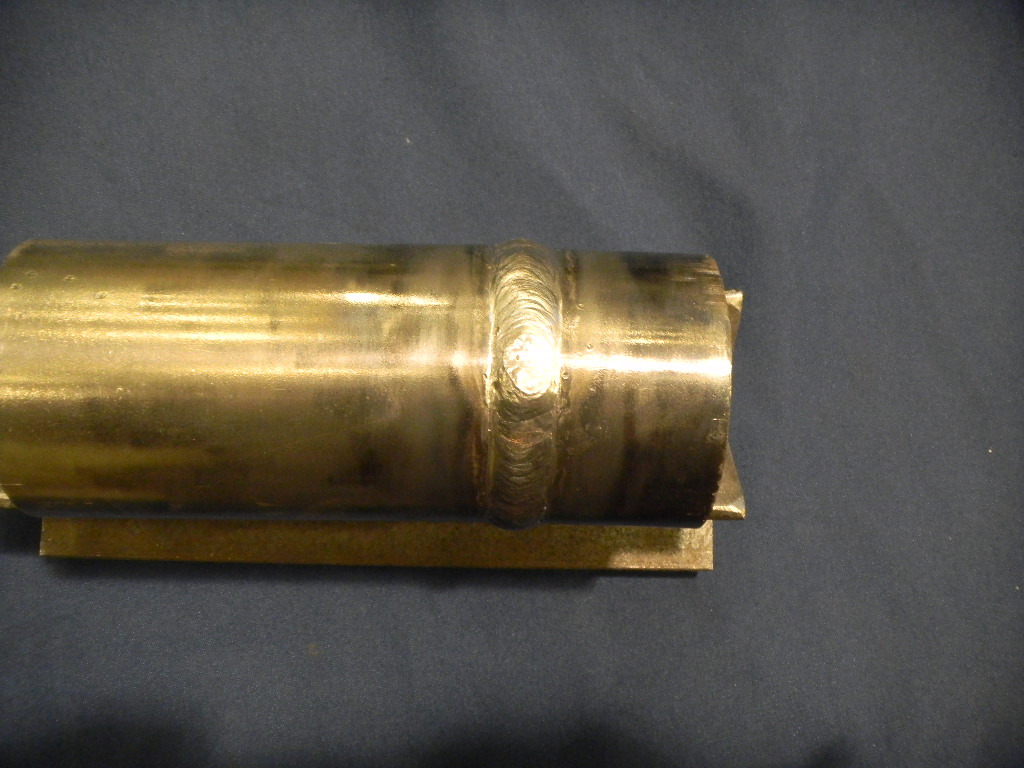

Look at this 7018 weld I made.
Too cold. Too short an arc length.
I suspect low arc volts. Tried going faster, but had lots of pinholes when I did. Plus I'm not used to 3/32 rods.
With the 6011 I had to bury the arc below the surface to keep it lit at the recomened amps. If i turned the amps way up, the rods started to cook. Or if I tried to weld like I usualy do the arc would go out 1 second out of every 4.
Drove me nuts.
