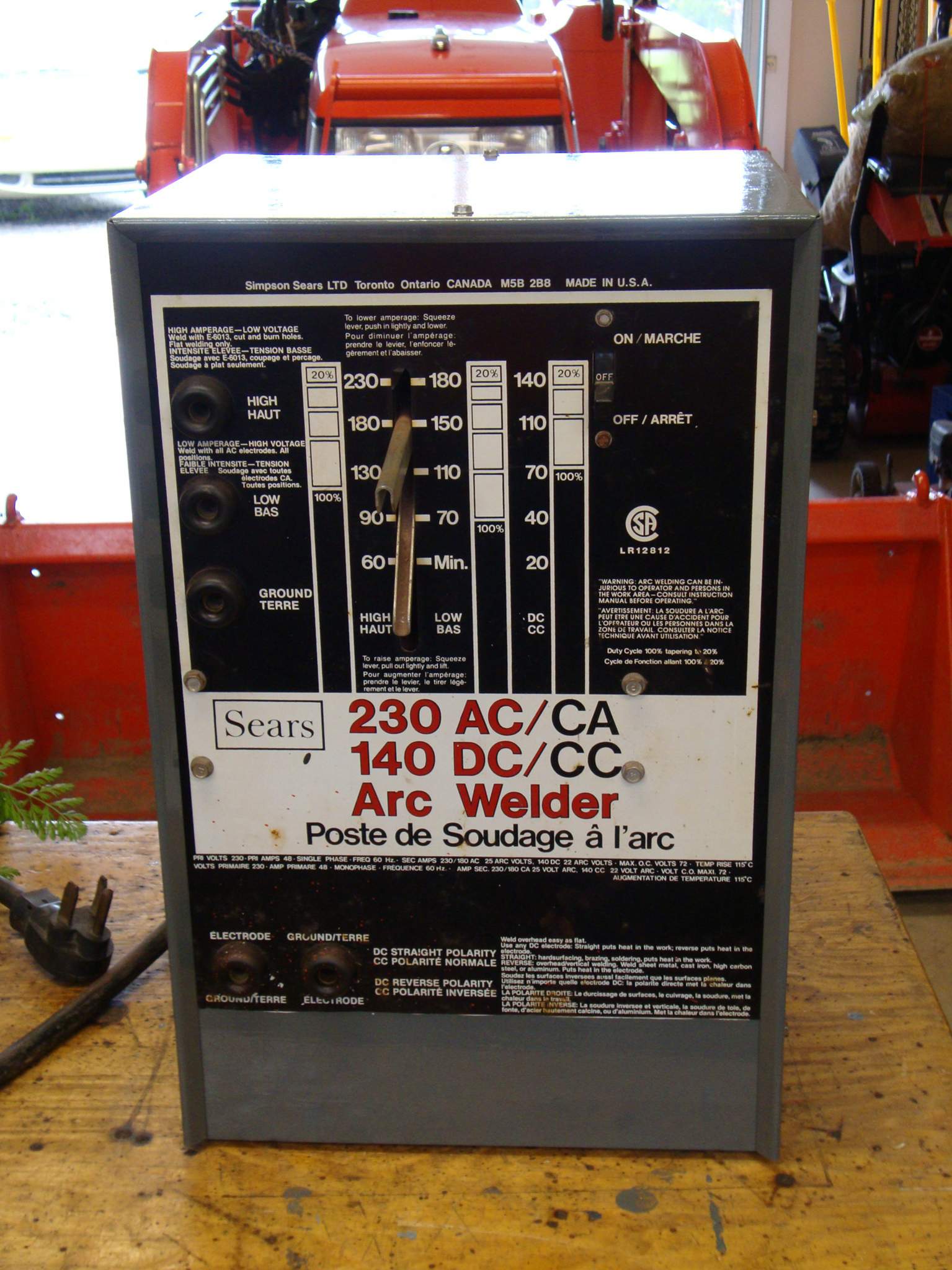

I've got one of the Sears branded Century AC/DC welders as well. I got it well used, and the price was right. Nice little machine for the money. About the only complaint I'd have about it is the adjuster. It's a nuisance.
