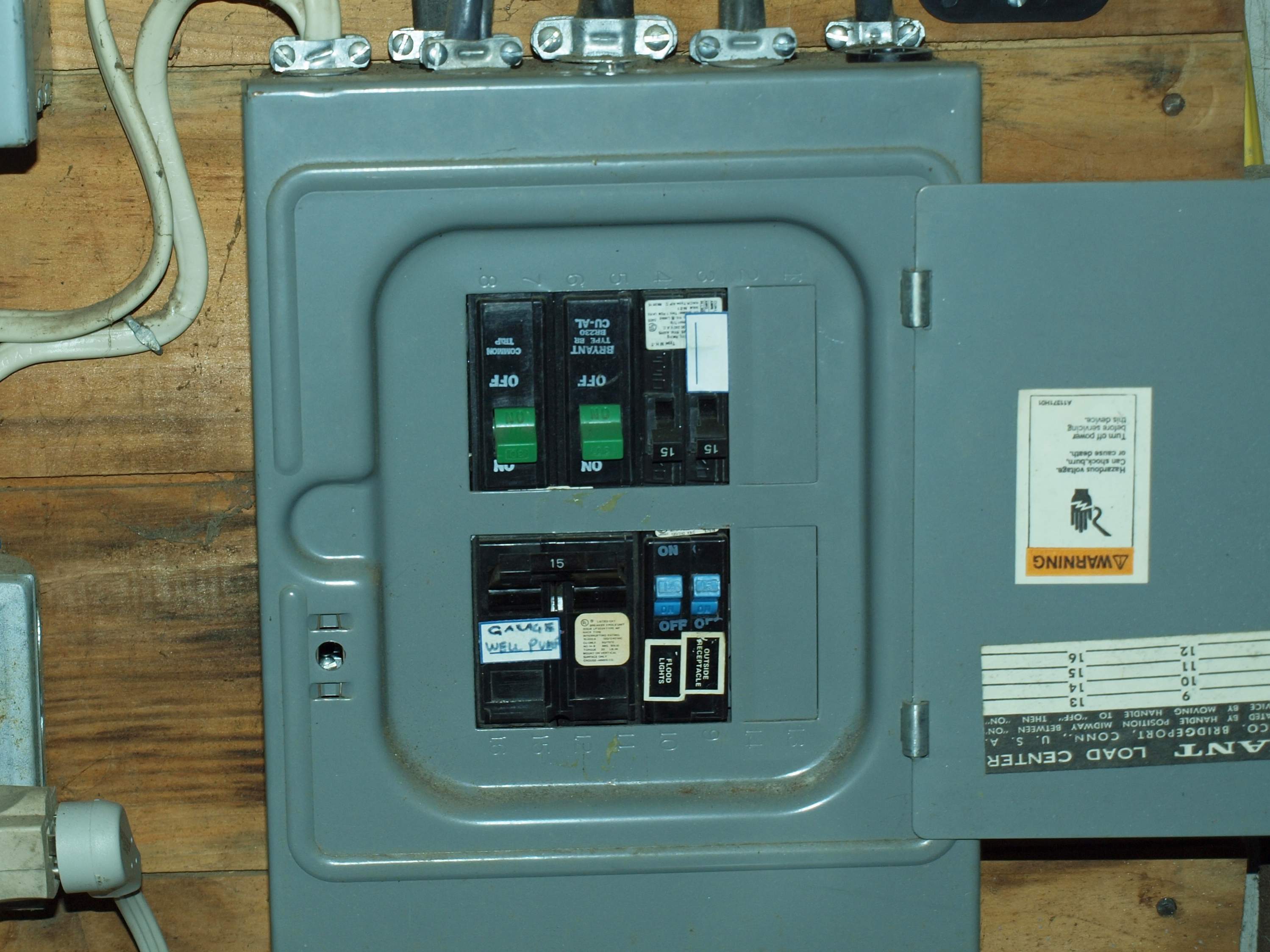

Since I m a "visual" learner, allow me to proceed. Here you see the box at the house going to the garage. The two 30 amp breakers are connected to the #10 wire going to the garage being fed from the main with a 50 amp breaker acting as a service disconnect. Why is this not 220 already? The box in the garage is all 110 volt with 20 and 15 amp outlets connected. If indeed I have 220 going out to the garage, isn't it simply a matter of putting in a 220 30 amp breaker at the garage with a wire lead dedicated to the welder outlet?

Since I m a "visual" learner, allow me to proceed. Here you see the box at the house going to the garage. The 2 30 amp breakers are connected to the #10 wire going to the garage being fed from the main with a 50 amp breaker acting as a service disconnect. Why is this not 220 already? The box in the garage is all 110 volt with 20 and 15 amp outlets connected. If indeed I have 220 going out to the garage, isn't it simply a matter of putting in a 220 30 amp breaker at the garage with a wire lead dedicated to the welder outlet?
Arrow, go out to the garage, and open the electrical box. Take your voltmeter set on an AC scale over 240 volts. Measure between the 2 wires coming into the box from the house. If they are between 220 and 240 volts you have your answer. If they are between 110 and 120 volts, you still have your answer, just not the one you wanted to see.
Well the puzzle for me here James is if they used two 30 amp breakers from the house to the garage. 110 +110 is 220 no? How is it reduced back to 110 at the garage if indeed this is the case? Unless the two breakers were not bridged? Why put in two if they weren't going to be as there is no other separate circuit? its just the one wire going out.
Well unless they are running current on the bare ground wire as if it was a Nuetral wire, I dunno.. Would need to see the installation. Why not spend some money, and have a trustworthy electrician come out and look over the install and advise you.? Your install is somewhat of a mystery. The only way to know for sure is open the boxes and take a look. If you have 220-240 out in the garage, then the only way to get the 110-120 is by using the bare ground wire to pull current as if it was a nuetral wire and that is a no no. So I guess I am puzzled as well. I guess I am also puzzled as to why the sub box leading that feeds the garage is mounted upside down?
Can you take a picture with the lid off the box (and possibly a similar one in the garage)? Do both the breakers with green levers go out to the garage?
Looking at the panel pic, it would seem that the breaker at the bottom left is a 240v 15amp breaker, so you should have 240v in this breaker panel, unless someone is only using one side of the breaker as a 120v circuit. Are both of 2 green breakers supplying power to your shop?? If so, and you are sure your buried wire has only 2 insulated wires and a bare wire, something is really screwy. Typically, to the best of my knowledge, breakers mounted side by side in a panel are usually on seperate hot legs. If this is the case in your panel then it would seem that whoever wired it is supplying 240v to your shop panel already. I have seen single breakers for 240v before, but they are usually pinned together at the switches so that if one breaker trips, it trips the other breaker as well. Maybe I am looking at this all wrong, but I think it is time you bring in a electrician to actually look at what has been done. Your pics dont jive with what I have seen even jackleg electricians doing.
yep, time to call in for some help.
