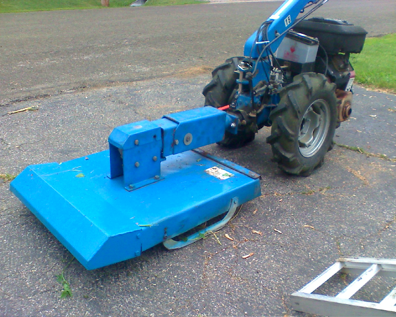

Hey Mike,
They're way outta my price range as well, but I still have them because I buy used. I bought an 850 with two tiller boxes and a finish mower for $1300 off craigslist and put 200 in parts in it. I sold the spare tiller and mower for $600. I then bought a rough-cut mower for 200 bucks and put another 300 bucks in parts into it. I have $1400 in the unit so far. I'm gonna buy a new Kohler Diesel by spring to mount on it. That'll be a new purchase for 1700. I'll have a $5750 machine for $3100 if I buy the Diesel.
You just gotta have patience and prowl craigslist for a couple months.
