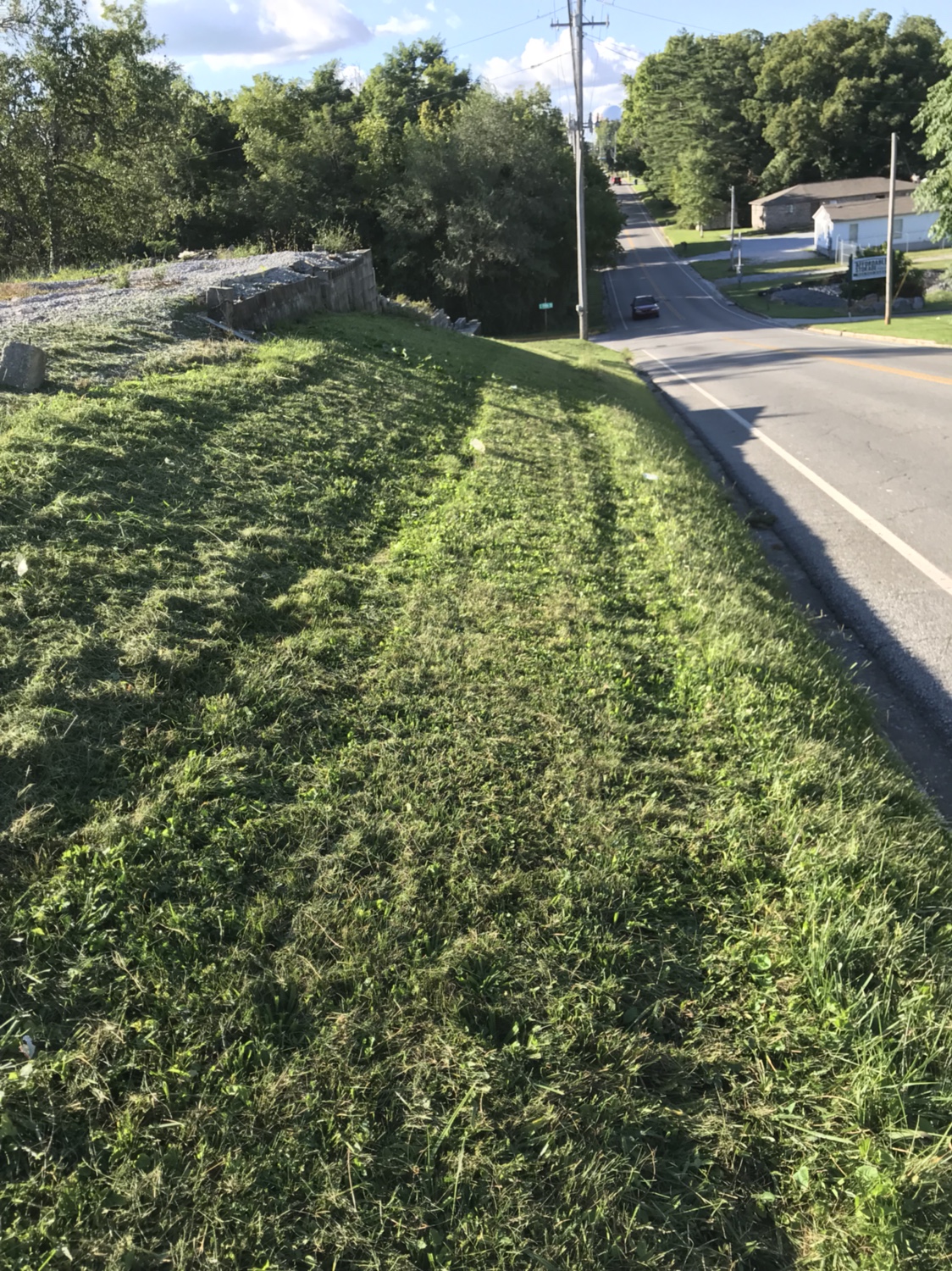

I mow double that or more on my ZTR. A commercial ZTR with bar tires and an experienced operator is a pretty capable slope mower. Get a light duty ZTR with turf tires and an inexperienced operator and it’s easy to see why they have a bad rap. This hill is pushing the limits of what I’ll do with a hazard at the bottom. If the bottom transitioned into level area I’d go steeper. IMG_0107.JPG

4570Man - do you know the % grade of that slope (or degrees of grade if that is easier)?
BTW - if anyone is interested, there are a couple of good smartphone apps to measure % grade, Degrees, or roof pitch (rise:run). I used both the Clinometer and the Theodolite apps when I was doing solar installations. Clinometer is available on Apple's App store and on Google Play. I know Theodolite is in the App Store, but not sure if it's out for Android OS at this time.

I’d guess it’s 20-30 degrees. I might be able to get an actual measurement in a couple days.

I have a similar slope with a measured angle between 20 and 25 degrees (not % of slope) that I have to mow, but it has a pond at the bottom of the slope.
Would you mow that with slope your zero-turn with a pond at the bottom rather than a road?

The bottom of the hill towards the road is a lot steeper and has a curb on it. As long as you could access the hill without having to drive down it and the pond wasn’t really deep right at the start I’d probably do it.

Well I can access it from the side, but its about 7' deep right at the edge.

I got a chance to measure it today. The steepest part I mowed is 23 degrease. The bottom towards the road is 28 degrees. 20 degrease is well within rollover range. Most people are terrible at guessing the slope of a hill. Anyone claiming to operate sideways on more than a 20-25 degrease hill is probably wrong about the angle or made substantial modifications for better stability.

It’s the hill pictured in post 24. The narrow way which is the up/down the hill part is wide enough to make 2 passes with my 72” mower and not hit it all and the other measurement is probably 150 feet.

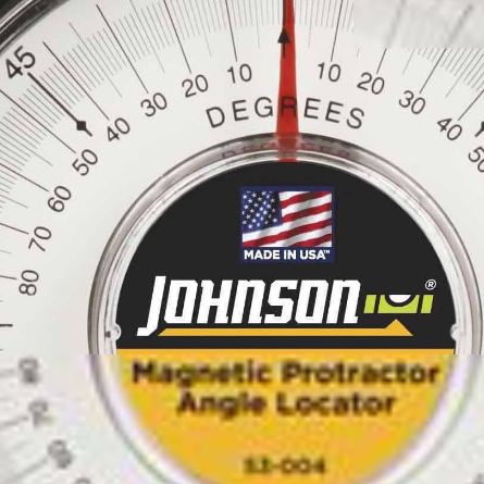

I measured mine with a angle gauge set on a 8' chunk of angle iron laid on the slope and it measured between 20 and 25 degrees. I don't know that its a perfect measurement, but its not just a guess.
