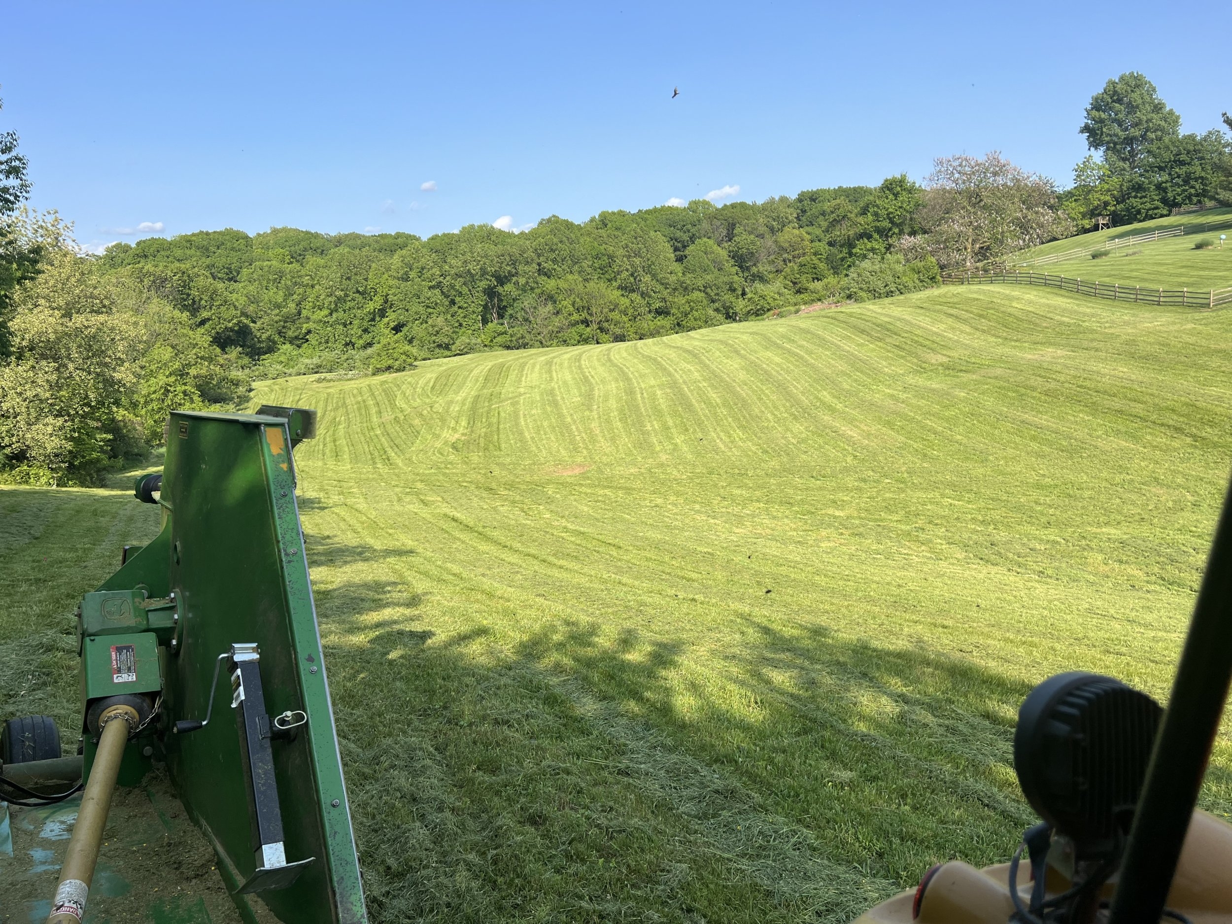

I bought a used 7 foot landpride finish mower awhile ago for $600 that needed tires, blades and belts. After replacing all of those things, I pulled it with a 37 hp open station 4x4 tractor with R1 tires.
Compared to what my 6 foot rotary cutter did, it was a huge improvement. It was great for mowing my walking trails, and around my pond. It was horrible around trees, or anywhere that I had to make a lot of turns. It was slow and cumbersome. My tires tore up the ground, and I just made a mess of things. I only used it for a year before buying my 5 foot zero turn.
The zero turn was faster, left a much better cut and it's great going around trees. It's biggest drawback is how much it beats you up on rough terrain.
Last year I bought a bigger 70 hp cabbed tractor and a 12 foot batwing. In my opinion, I think that they 12 foot batwing gives me a better finish then the finish mower did when mowing my trails and around my pond. I'm really amazed at how well it looks!!!!!!
My neighbor has a 15 foot batwing and it does a nice job, but the finish isn't anywhere as nice as my 12 foot batwing. It could be that his blades are worn out, I don't know how old they are. My blades are just a year old and still cutting nicely. But it also could be that my mower has a 5 foot deck in the middle and 4 foot decks on the wings that contour to the ground a lot better then his much bigger decks do? Or I'm just biased and I like mine better then his. :)
Now I just use the zero turn around the house and my driveway. The batwing does everything else.

It’s the blades, not the width.
New batwing mowers with sharp blades can do an almost finish mower lawn-like appearance.
As far as your mower scalping less, yes. 4’ decks have less chance of scalping than 5’ decks.
