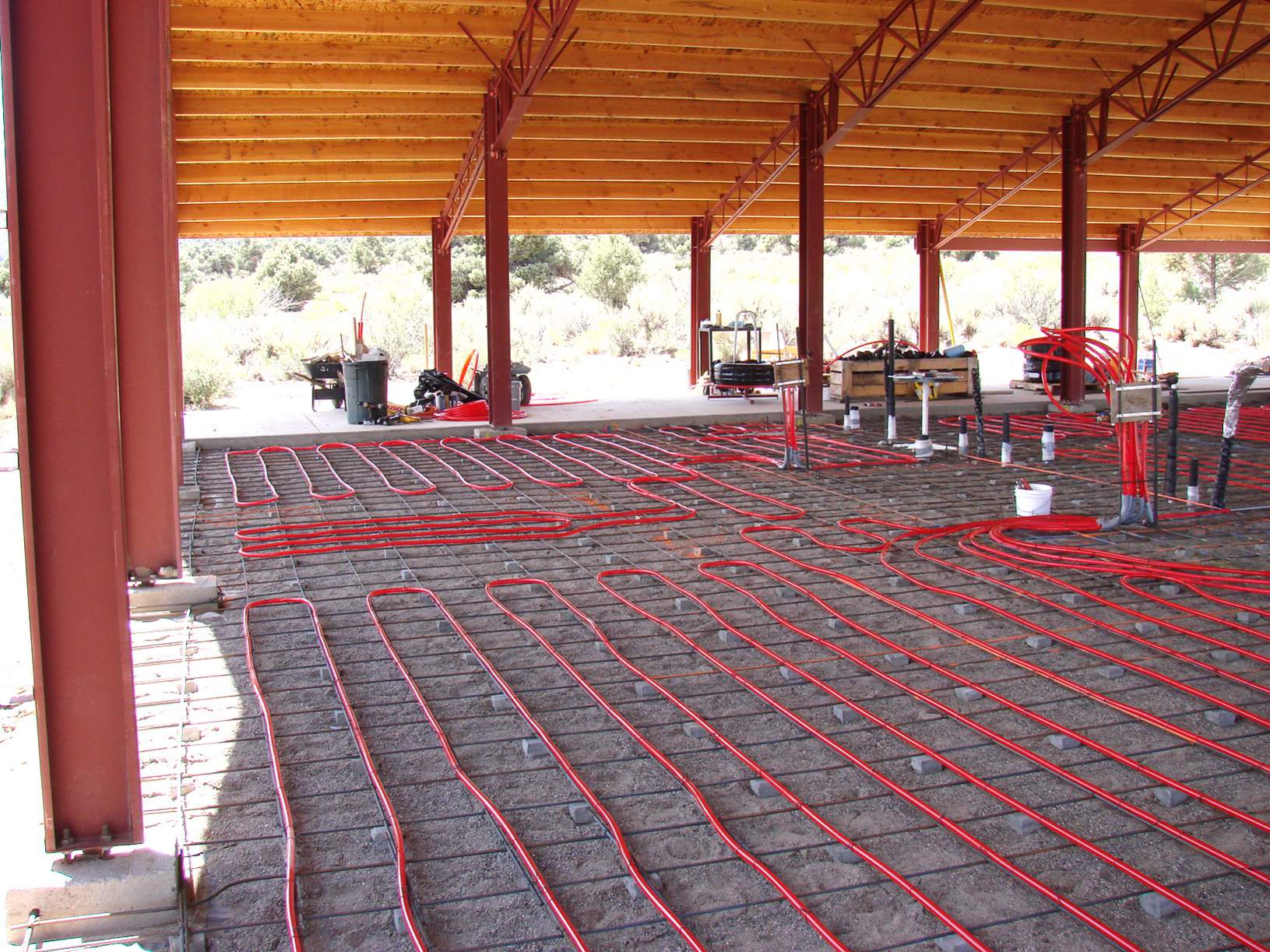

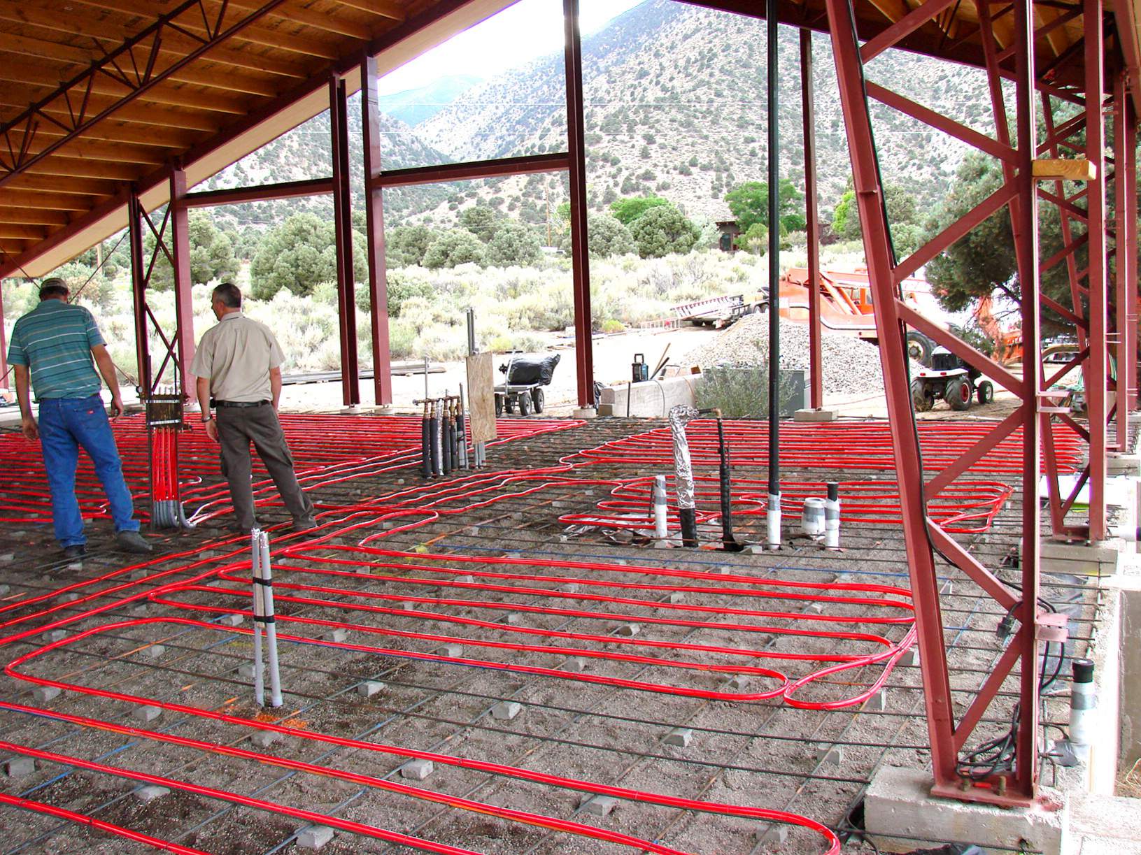

Mine were made by Miracle Steel. Very impressive, and they could certainly be made with a cutoff and a welder. In fact, I am going to make some for my detached carport.
Only problem I see is if you need a certification for a building permit.
Here are a couple of pix, that I happened to have with me, of the steel, and a picture of Sandy just for fun.
