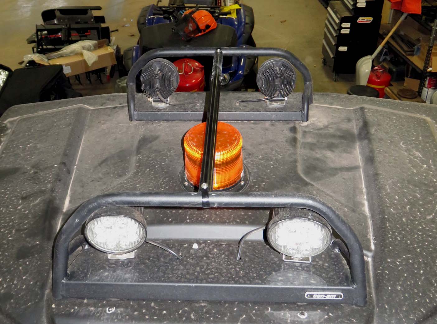

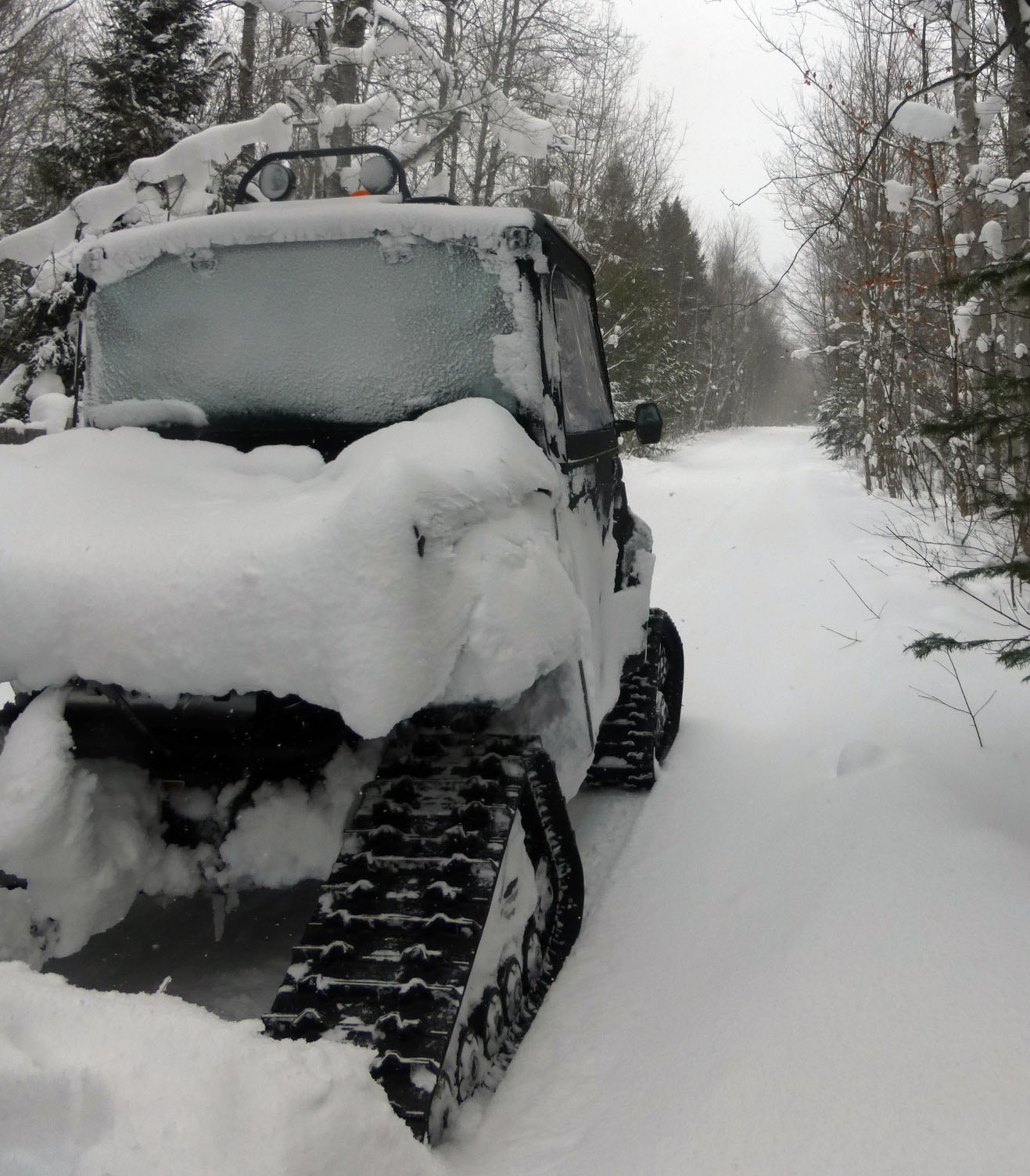

Here are 5 lights mounted on a plastic roof. 6 years later and many, many branches pushed away with the guards, they are still there and never been repaired. How can we improve on this design??.

Looks like a great design Arly, no complaints. Being here in Fl the rate at which plastic detiorates pretty fast and becomes brittle, I am sure there are probably excellent plastics out there but I liked the looks of the aluminum. I would thought the temps there would have made plastic brittle
