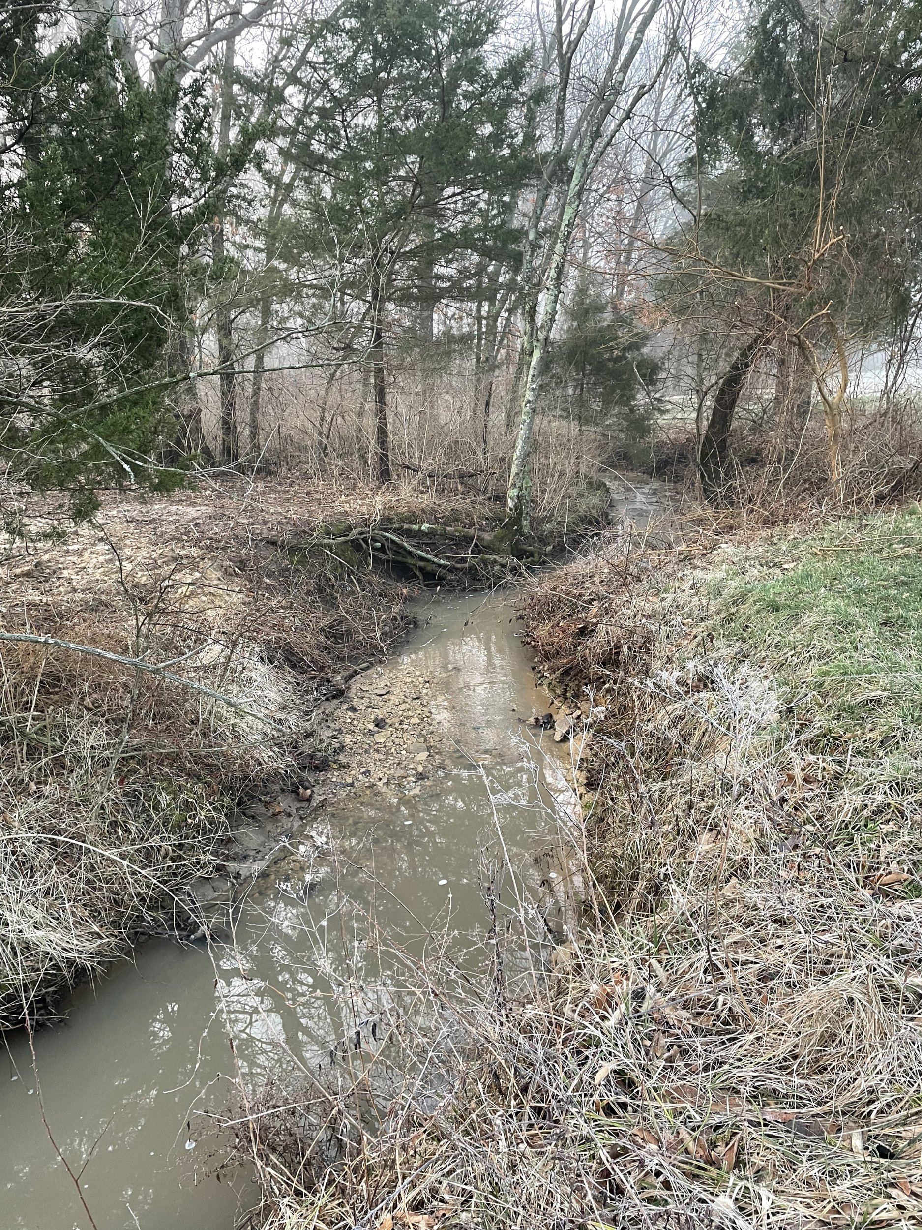

Build a great structure, but skimp on the abutment and then the creek bank will wash away underneath. Nature is going to look for the weak point.

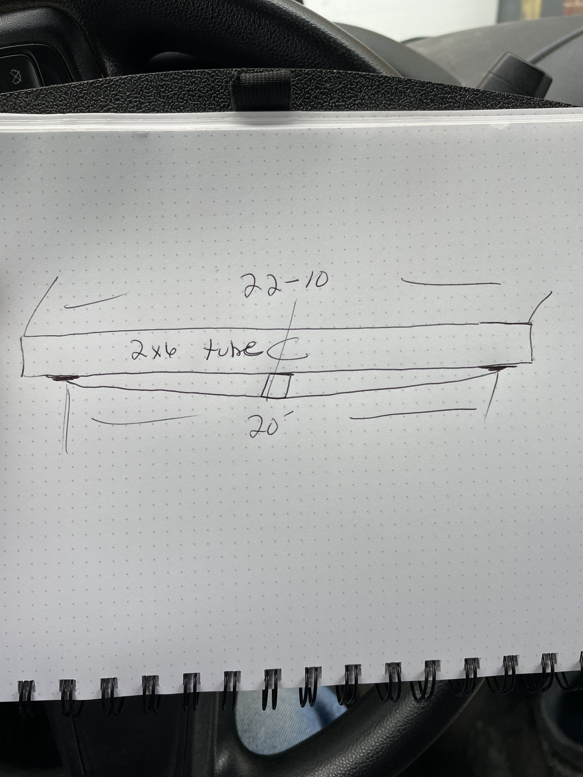

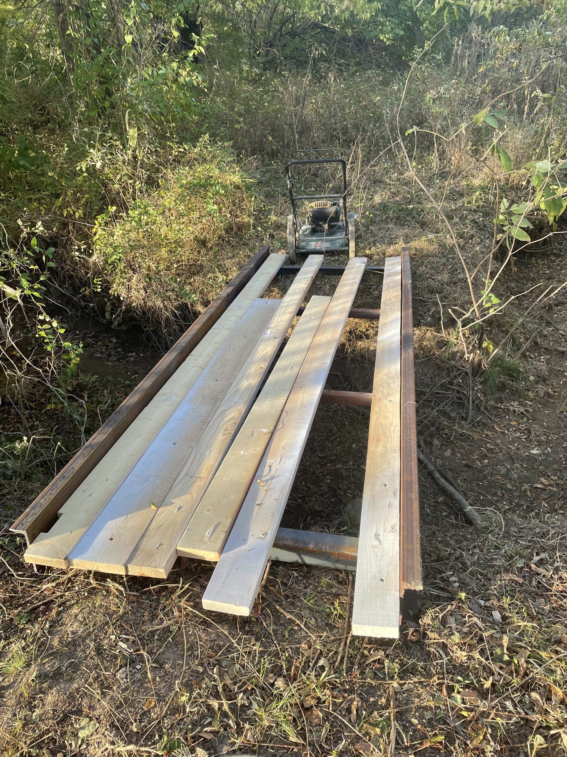

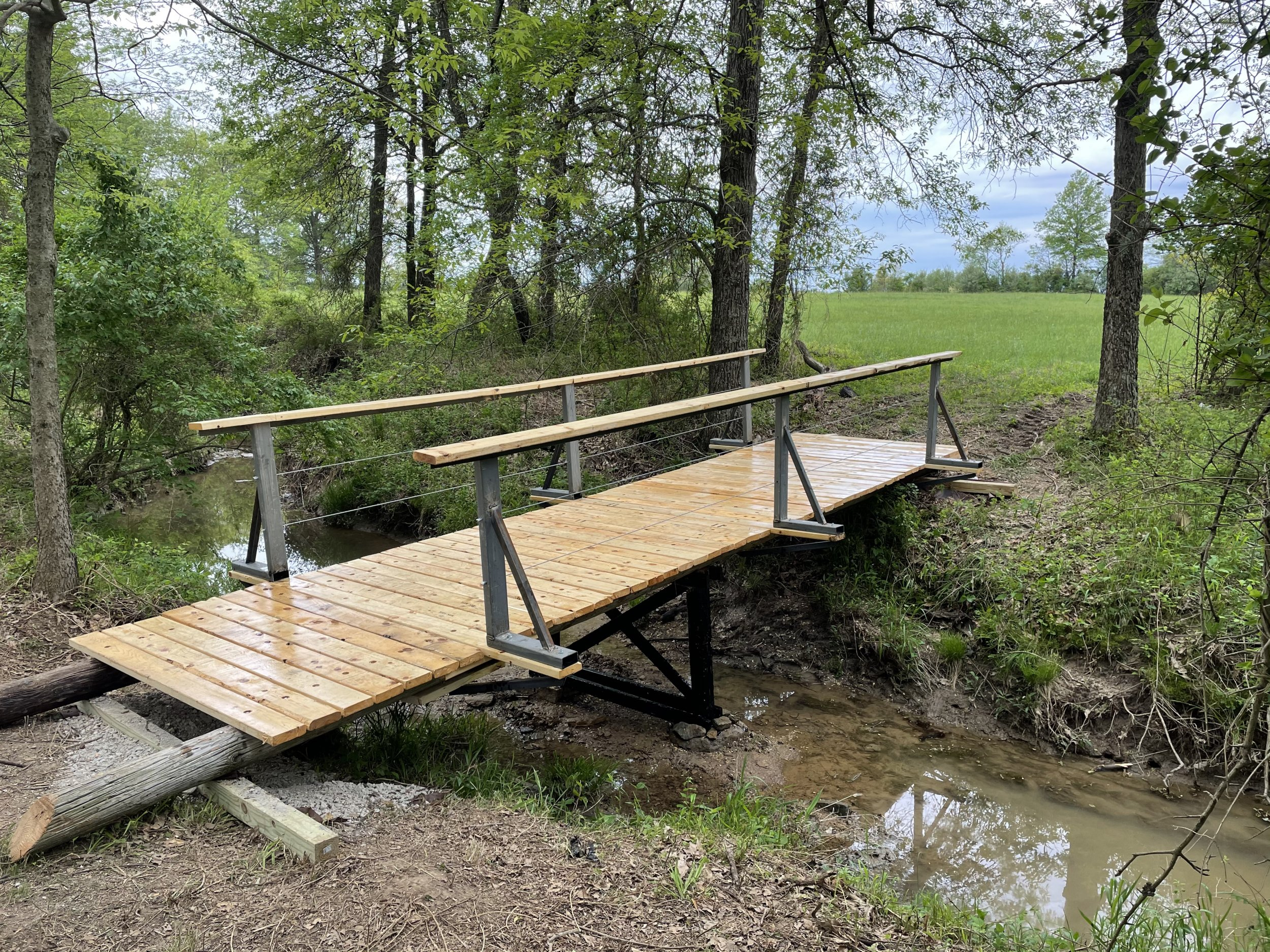

In my barn thread I mentioned a bridge build and people wanted me to post when I was building it.
Todays the day!!!
Approx 20’ span
Approx 7-8’ wide
2x6 tubes for the stringers
A center 2x6 tube under the stringers
3x3 tubes for cross members
6x6 treated timbers for the “foundations” on each end.
End goal is to drive a vehicle across!
View attachment 786740View attachment 786742View attachment 786743View attachment 786745
With the 2x6 stringers laying flat it's going to be very flexible, even with a support at mid span. What type of vehicle do you want to drive across it once completed?
/ Starting my bridge!! #88

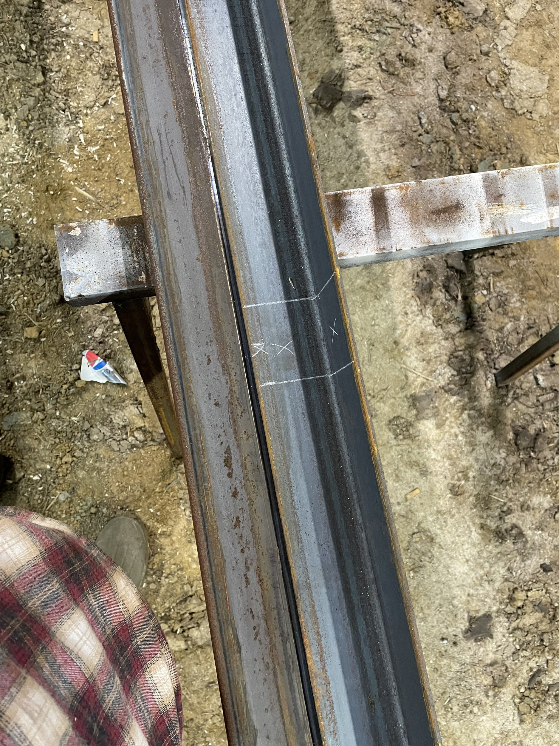

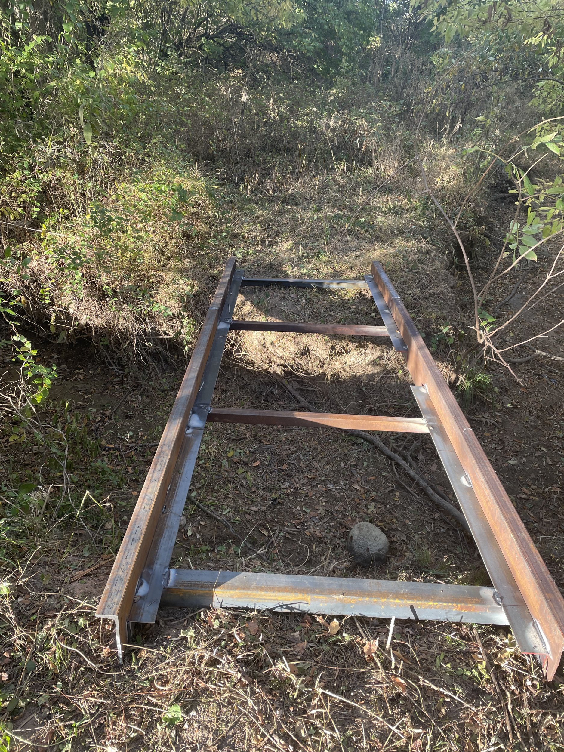

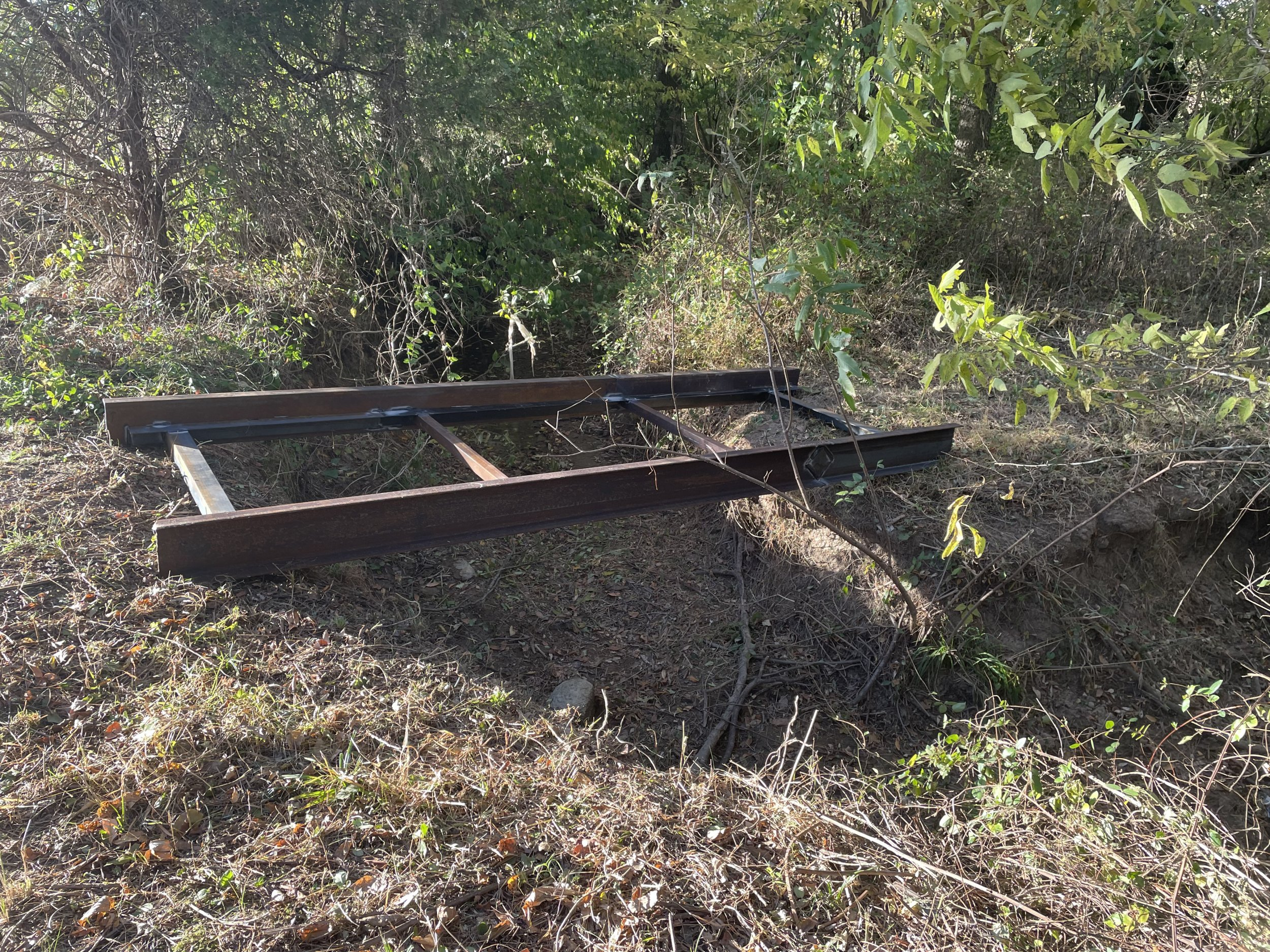

2x6 tubes are 1/8” wall.
Outside tubes have a piece of 3x3x3/16 -20’ welded to them for the 3x3 cross tubes to sit on
There’s another 2x6 tube in the center under the 3x3 tubes
Tractor weighs approx 4000 pounds
I’m going to build this under each of the stringers out of 5/8 rebar. An Engineer “assisted” me with working out the idea.
I’ll probably also build 2’ or 3’ tall truss style railing on the outboard stringers.
Just about got the ok from the finance manager (wife) for some concrete to lock down both ends of the bridge. She hasn’t actually seen it in person yet!

In stall your reinforcing king truss as soon as you can. Additional dead load of bracing and deck will help load it
2x6 tubes are vertical

Having free material is a good problem to have.

My degree is in civil engineering and I had structural engineering classes also. I am by no means a structural engineer so take this for what it’s worth.
I never studied, heard of or ever seen a steel structure pretensioned with cables. I’m not saying it won’t work, I just have my doubts. With concrete beams they often pretension or post tension them with cables embedded in the concrete.
I also think I saw someone throwing out the idea of building rails to truss up the main beams with rebar welded up. Once again, I feel that’s not going to do a thing. That’s not what rebar is designed for and I don’t feel the welds would hold. Look at through truss bridges the way the joints are bolted and have gusset’s to strengthen the joint.
I‘ll add I think you’ve got a good bridge, nice build, quality construction, I just think you want to be careful what you drive across it. You’ve got those main rectangular tubes to carry the main load and I’m not sure at this point you can improve on it. Sorry I’m trying not to be to negative.

I have multiple 50’ lengths of 3/8 crane cable (not aircraft cable). 5k capacity turnbuckles aren’t hard to get…..that’s where my cable idea came from.
I suspect that there will be considerably more than 5000# of tension on the cable - there's considerable mechanical disadvantage in resisting the collapse of an arch (or resisting a flat surface from becoming a negative arch) unless the angles in the framework resisting it is fairly large. This is why the trusses on a bridge are so tall, so that the angles are large.
[caveat - I'm not an engineer, but I understand triangles, that these triangles are barely worth considering triangles for strengthening purposes!]
With a 6" tall triangle under the bridge standing off a tension rod (or cable), and a 9' wide triangle (for an 18' span), because of the really shallow angle formed in that triangle, you'd end up with huge tension on the rod - probably 15x of the downward weight it's supposed to counter.
If you want to counter 5000# using the tension, your 5k turnbuckle would explode.... even 1/2" grade 60 rebar can only be expected to hold 15k tension (gr 60 rebar - 90k psi tension - 1/2" rebar will have ~0.2 sq in). 1" gr 60 rebar would hold about 72k tension, which is what 4800# over the bridge would put on such a system.
With a 12" tall triangle, the tension would multiplier would be about 10x (vs 15x with the 6" triangle) because the angle is larger, and the rod would have accordingly less tension on it.
An 18" triangle gets a 6x multiplier.
The taller the triangle is, the lower the tension multiplier gets; if your bridge was over a canyon and you had a 9' tall triangle so that the cable made a 45* angle to it, holding off deflection would only require about (weight + 40%) tension... but you've got a little creek and you don't want the tension rod/cable to catch stuff that's floating in high water.

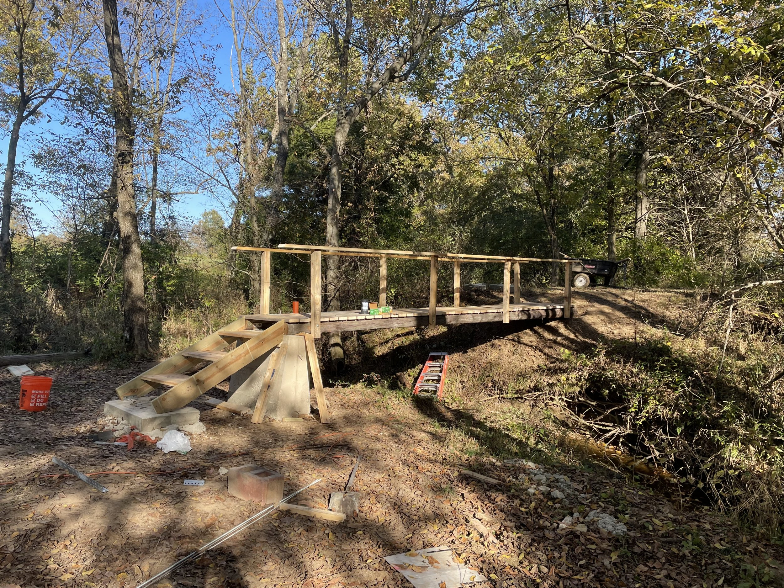

Did you ever say what you were going to use for decking?
And curious why you chose 2.5' spacing.
Car trailers and even some equipment trailers have cross members on 24" spacing......and that seems to work pretty well with 2x8 or 2x6 treated lumber. But not sure how 30" spacing would work.
IF you have some hardwood sawmills in the area.... full 2" rough sawn white oak is alot stronger and lasts just as long as treated pine
White oak much stronger and out of ground contact will last longer. I you want it to really last do what truckers used to do, after the wood has dried a couple of years pour used motor oil on it. All those carcinogens put paid to bugs and the oil seals the surface really well.
