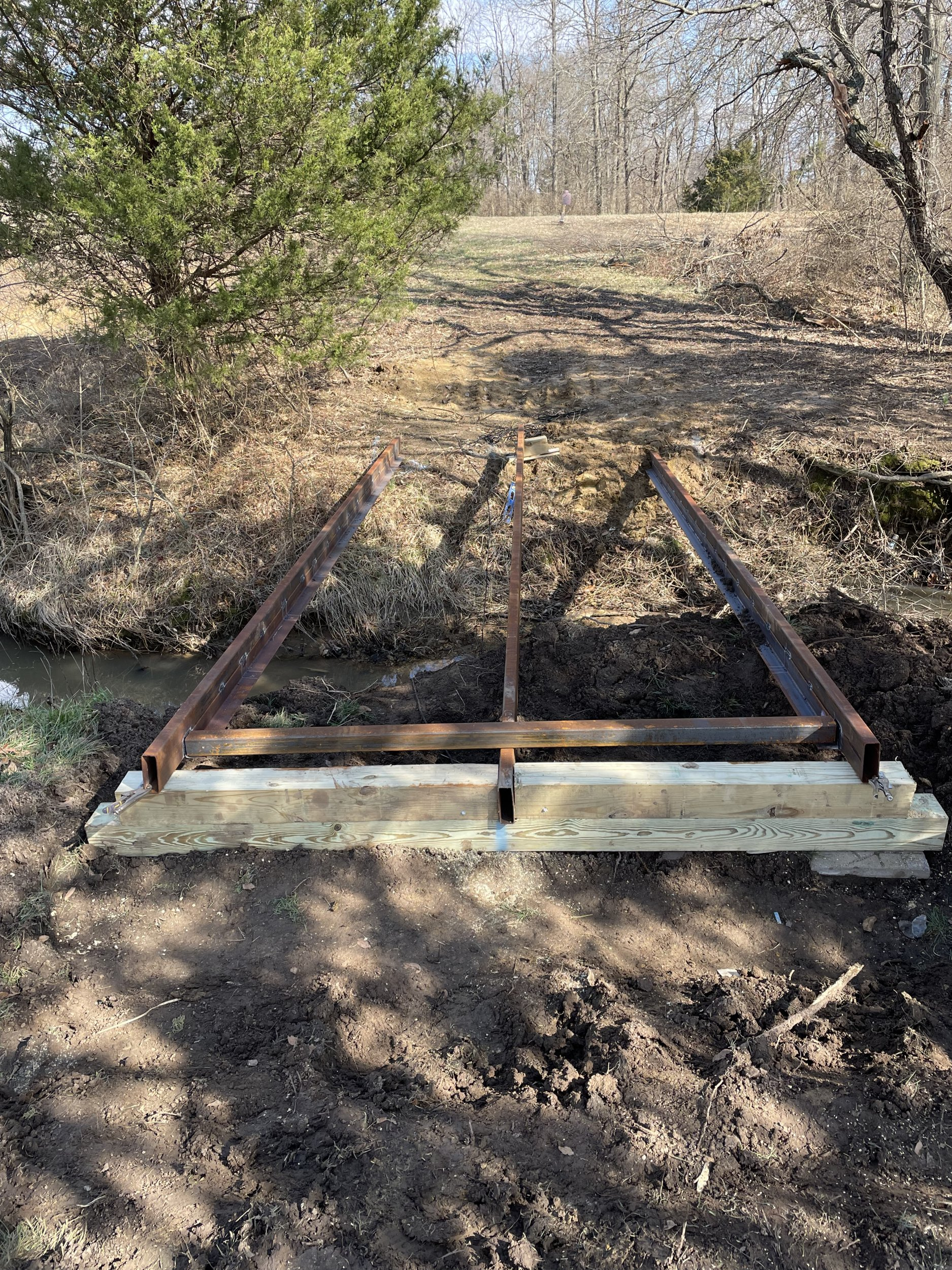

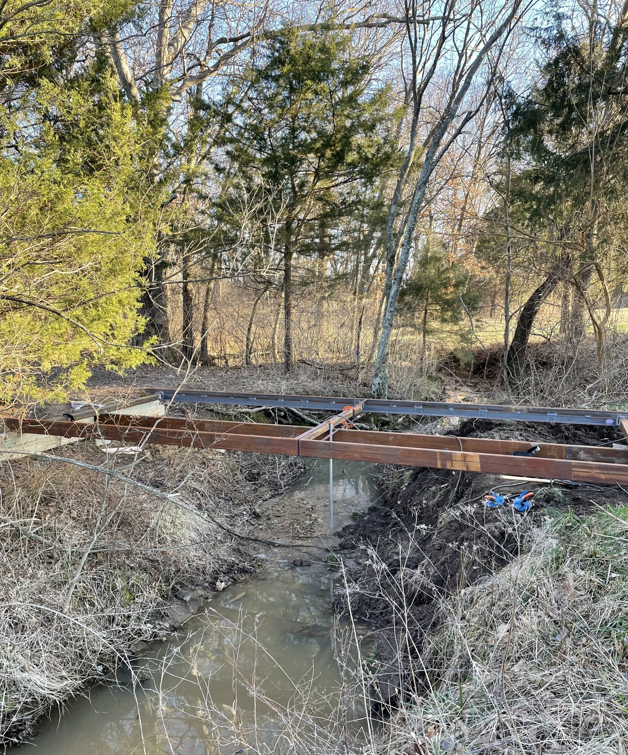

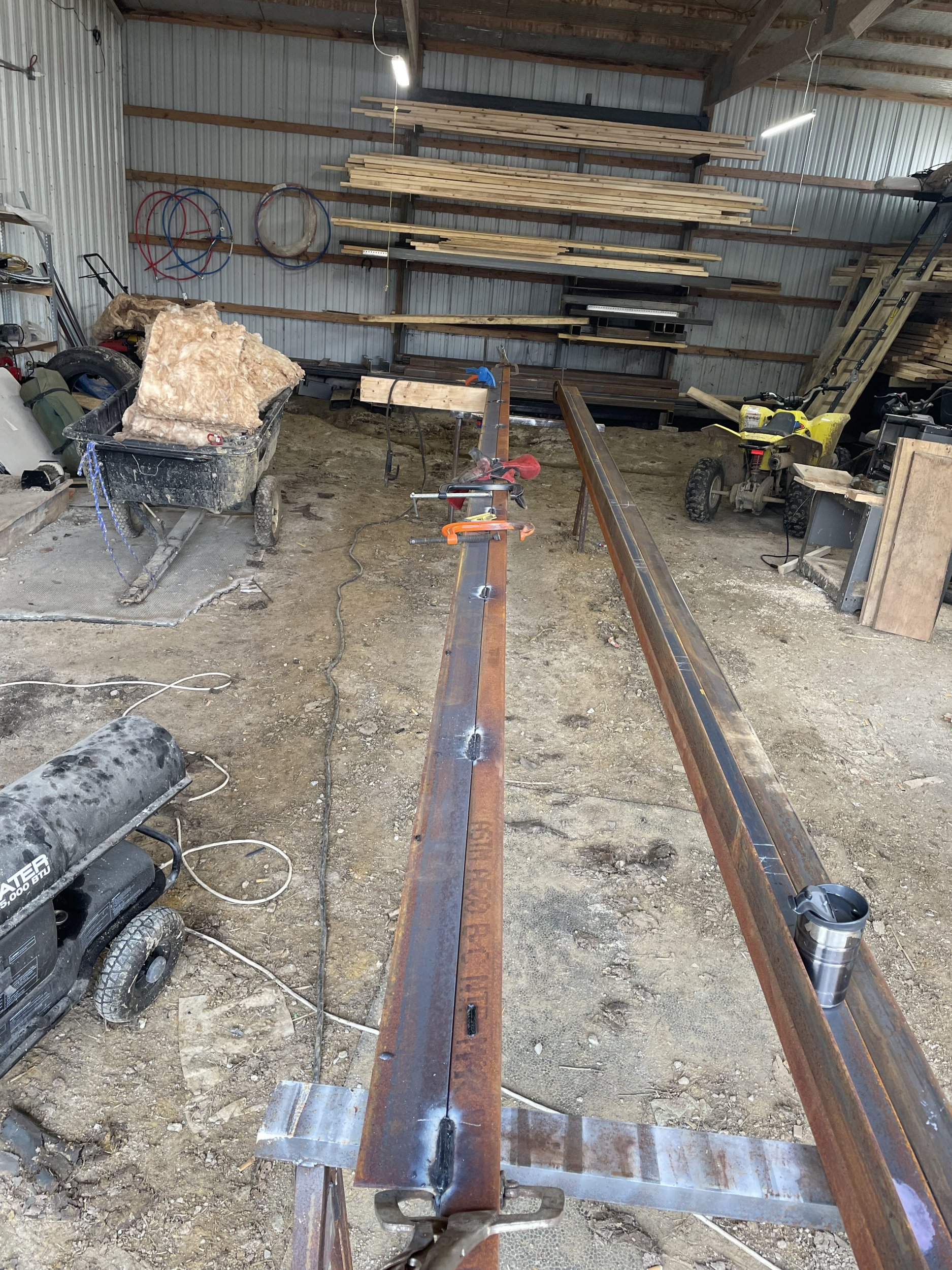

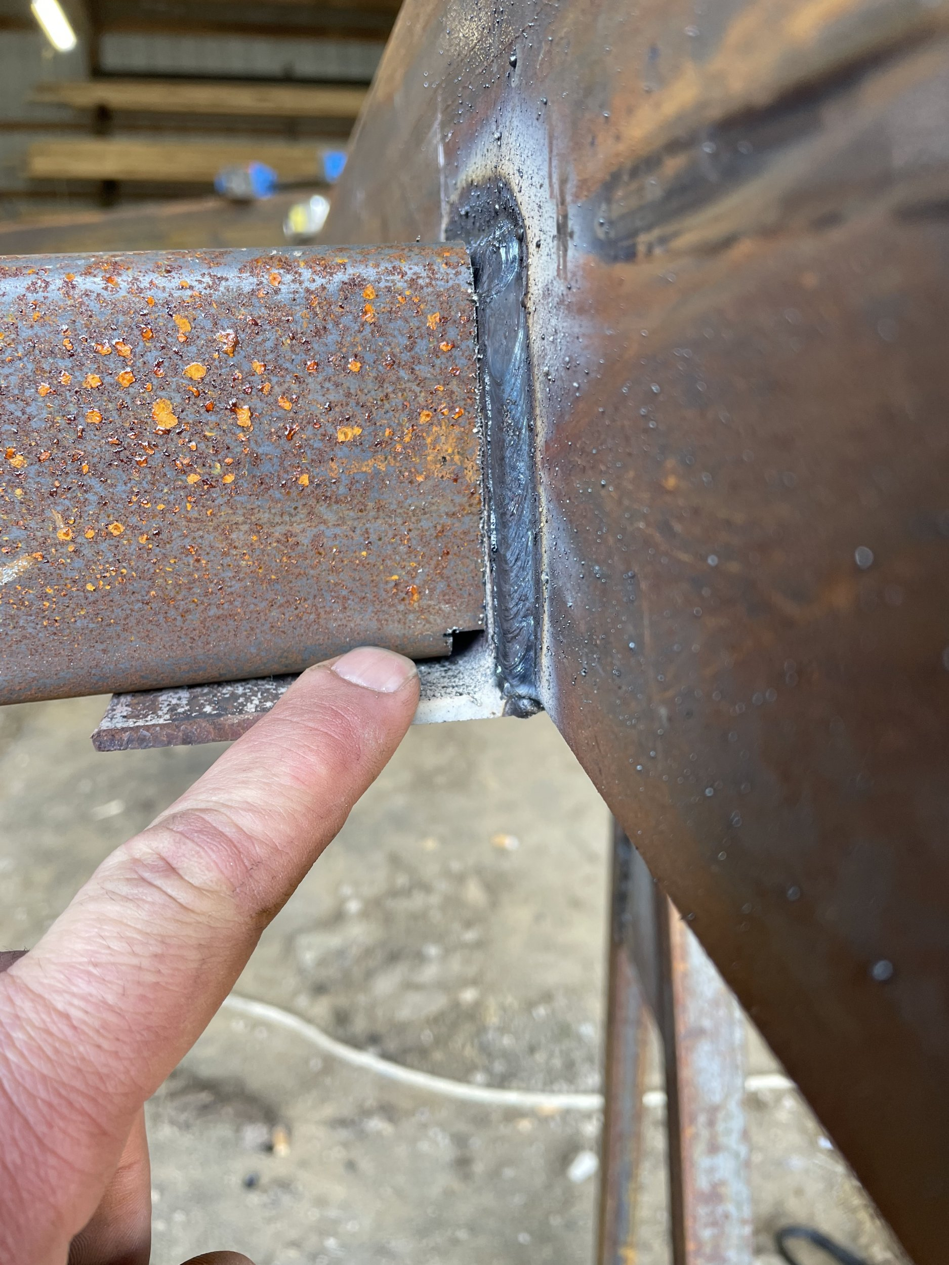

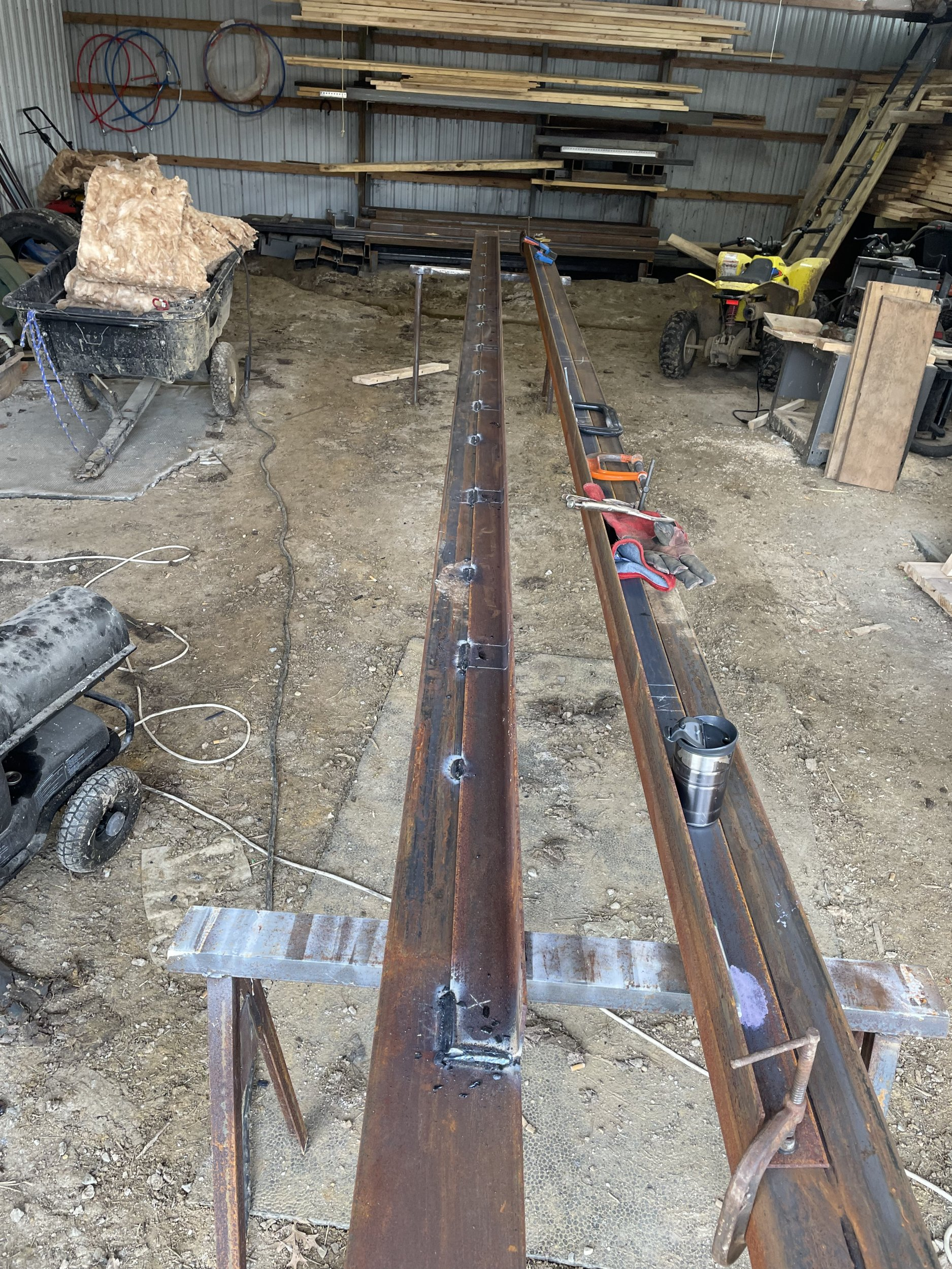

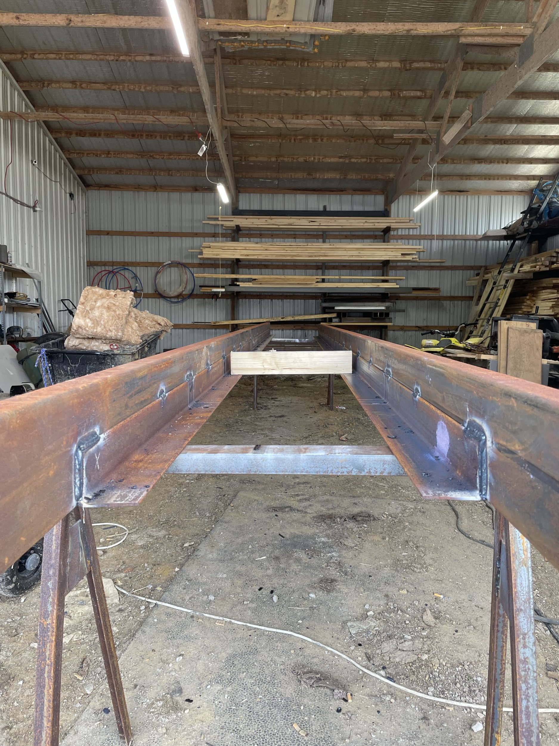

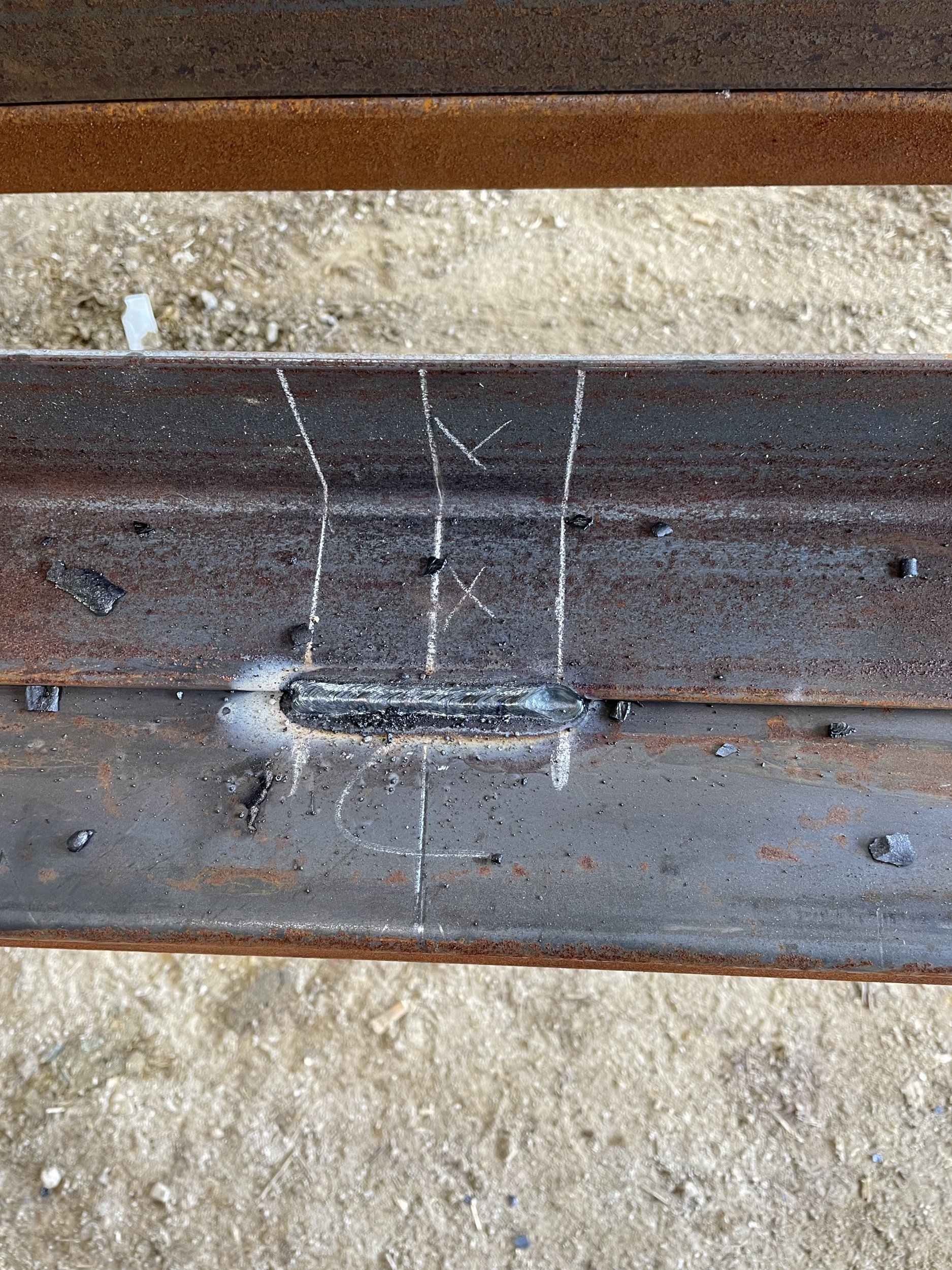

Cut and notched 4 of the 6 cross tubes last night.
Cross tubes are on 2.5’ centers
Laid those 4 out this morning…..looking like a bridge!!
Gonna cut and notch the last 2 now.
Waiting till after 8 to fire up the welderD05FCD4E-EB7C-4DBB-9CB3-A1BE36252500.jpeg

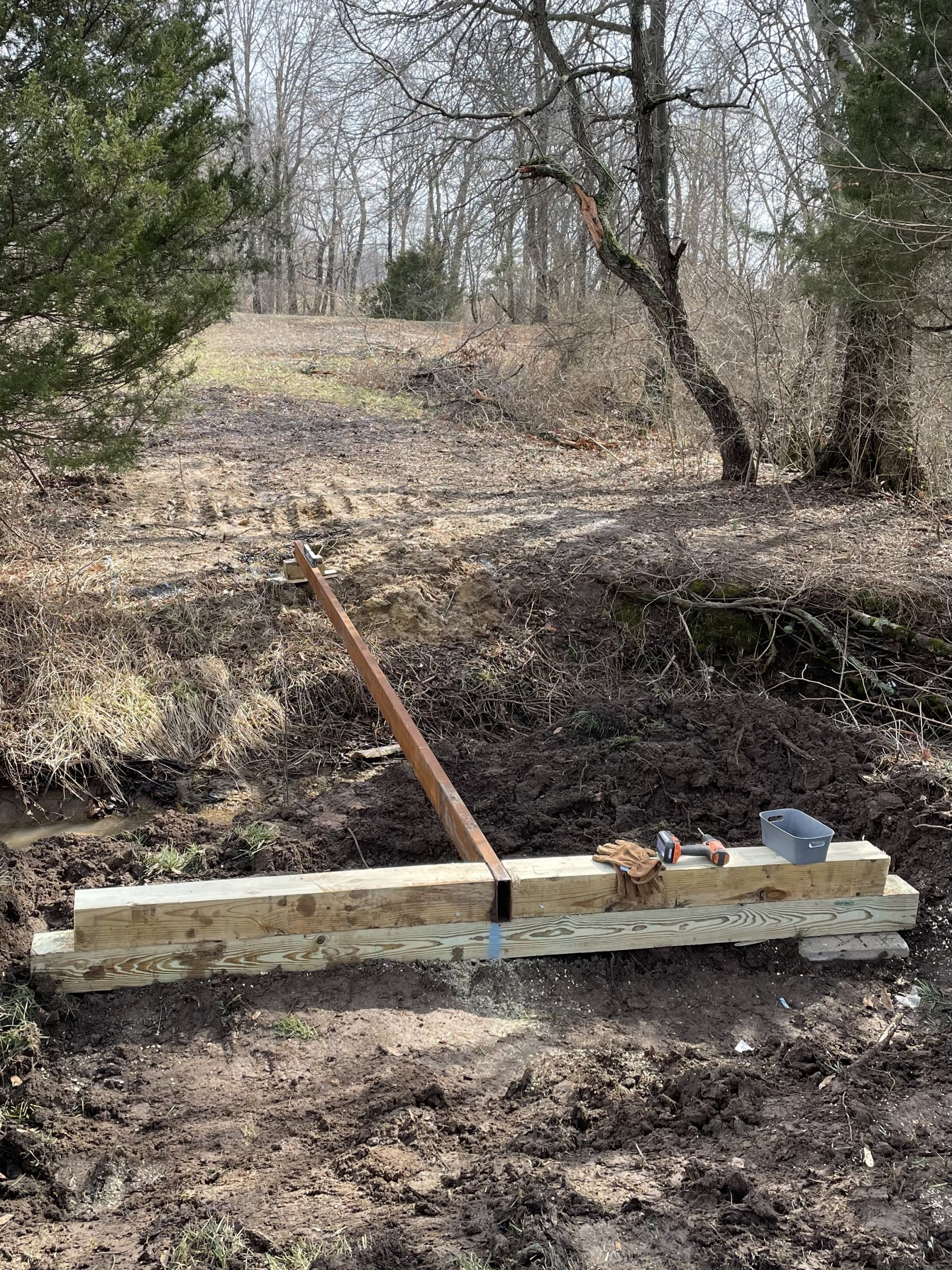

Did you put gravel or something to keep moisture off the wood supports?
The bridge is going up pretty fast, looks good, thanks for taking us on the ride.

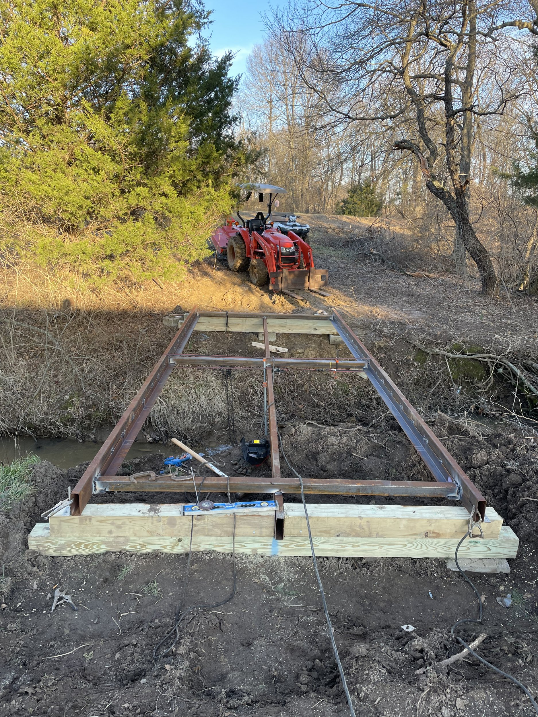

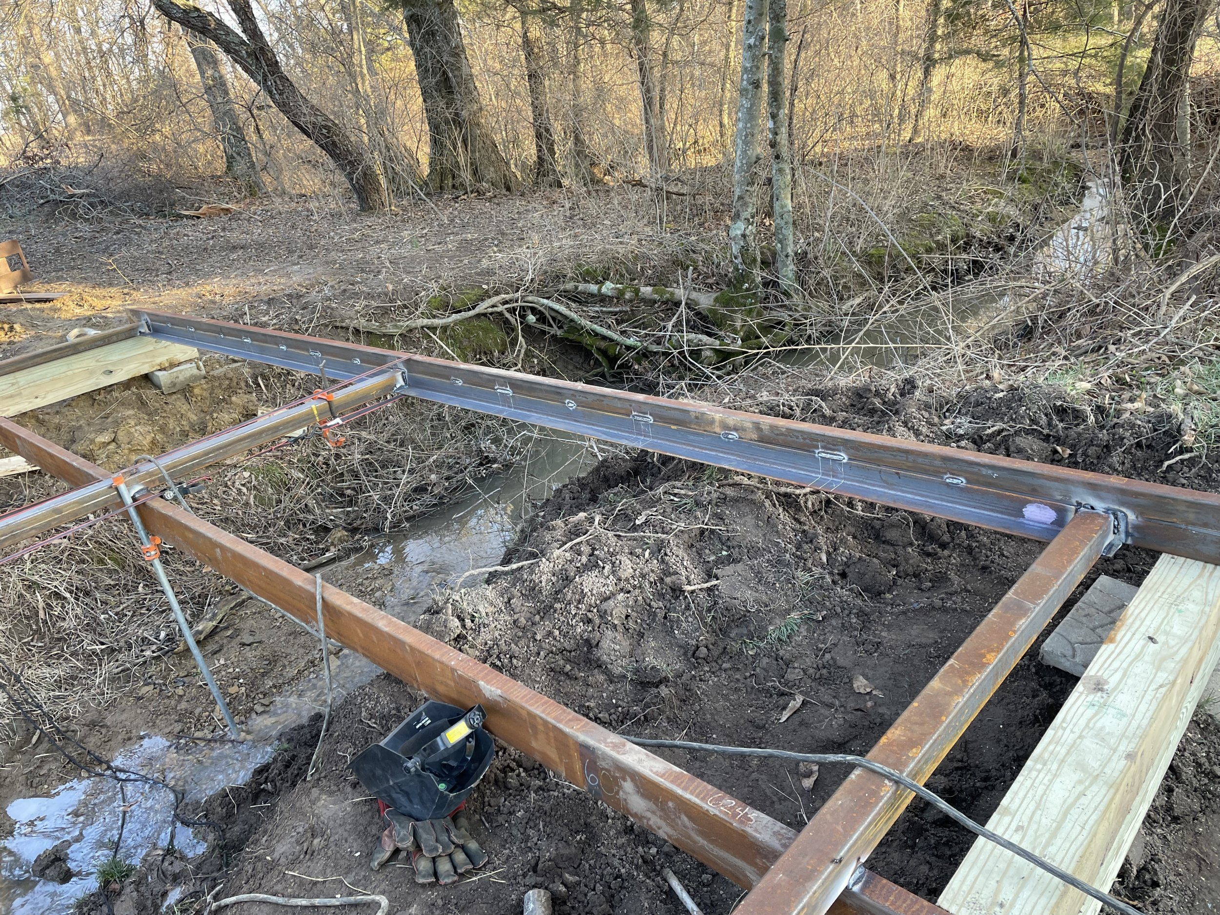

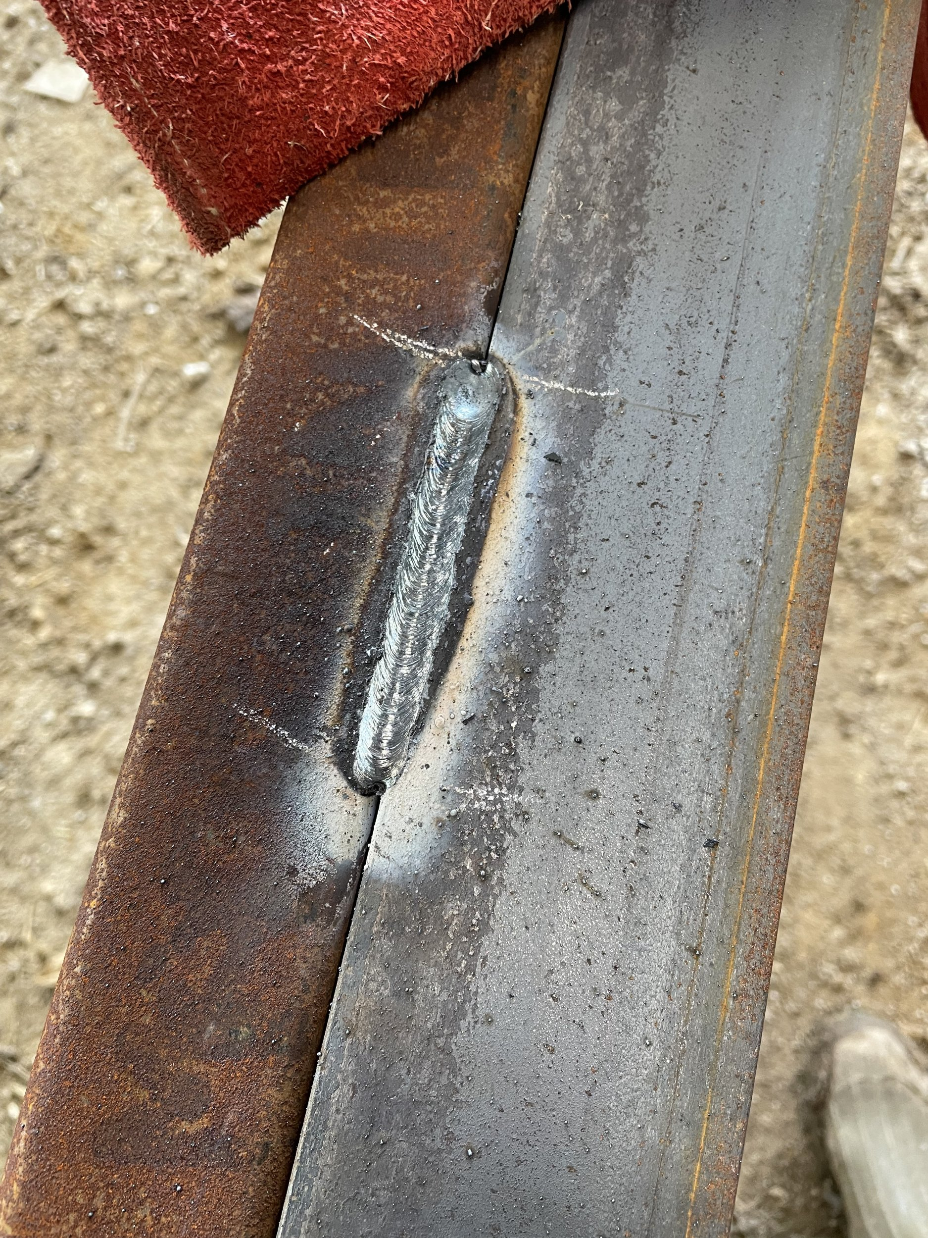

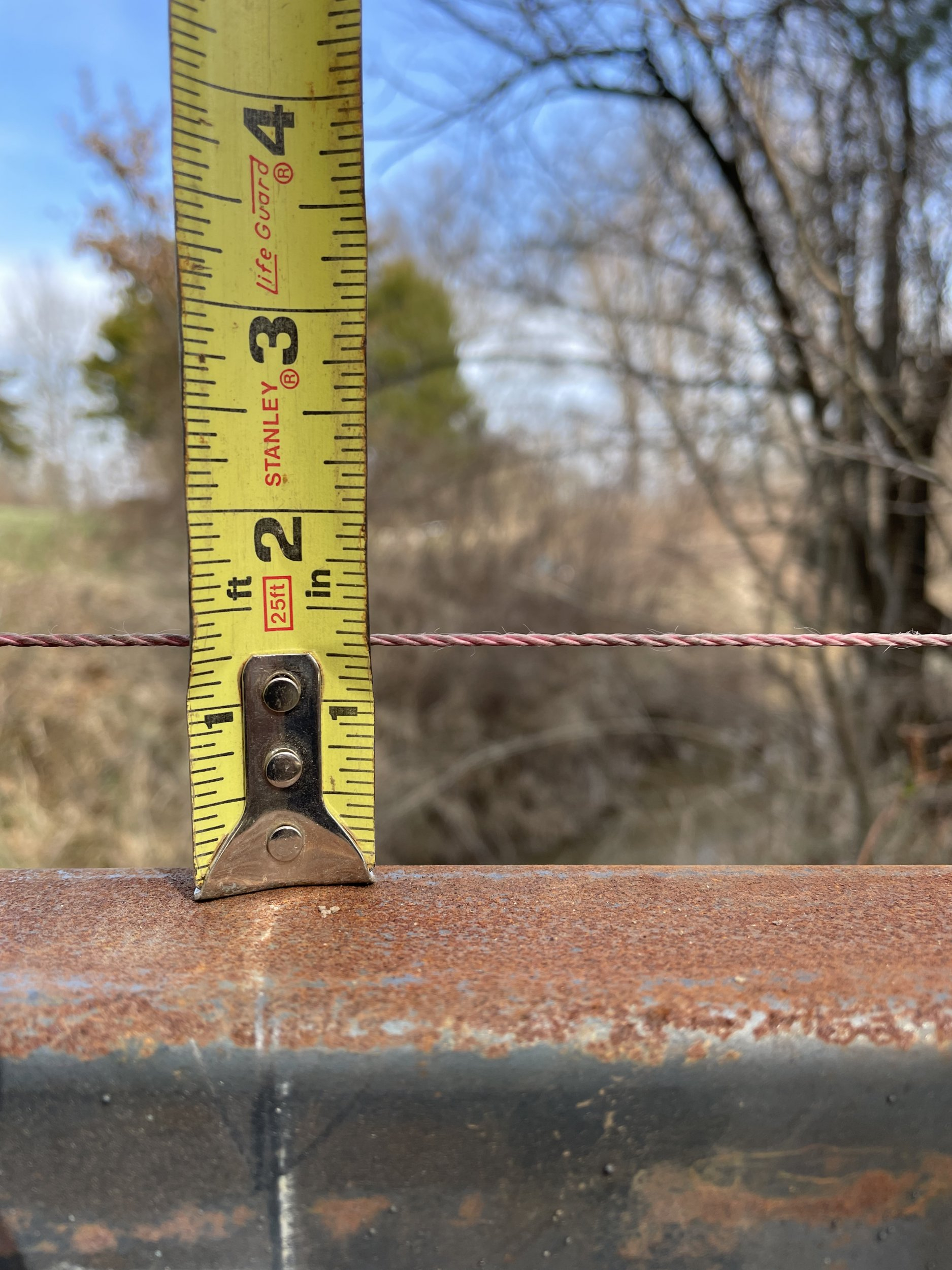

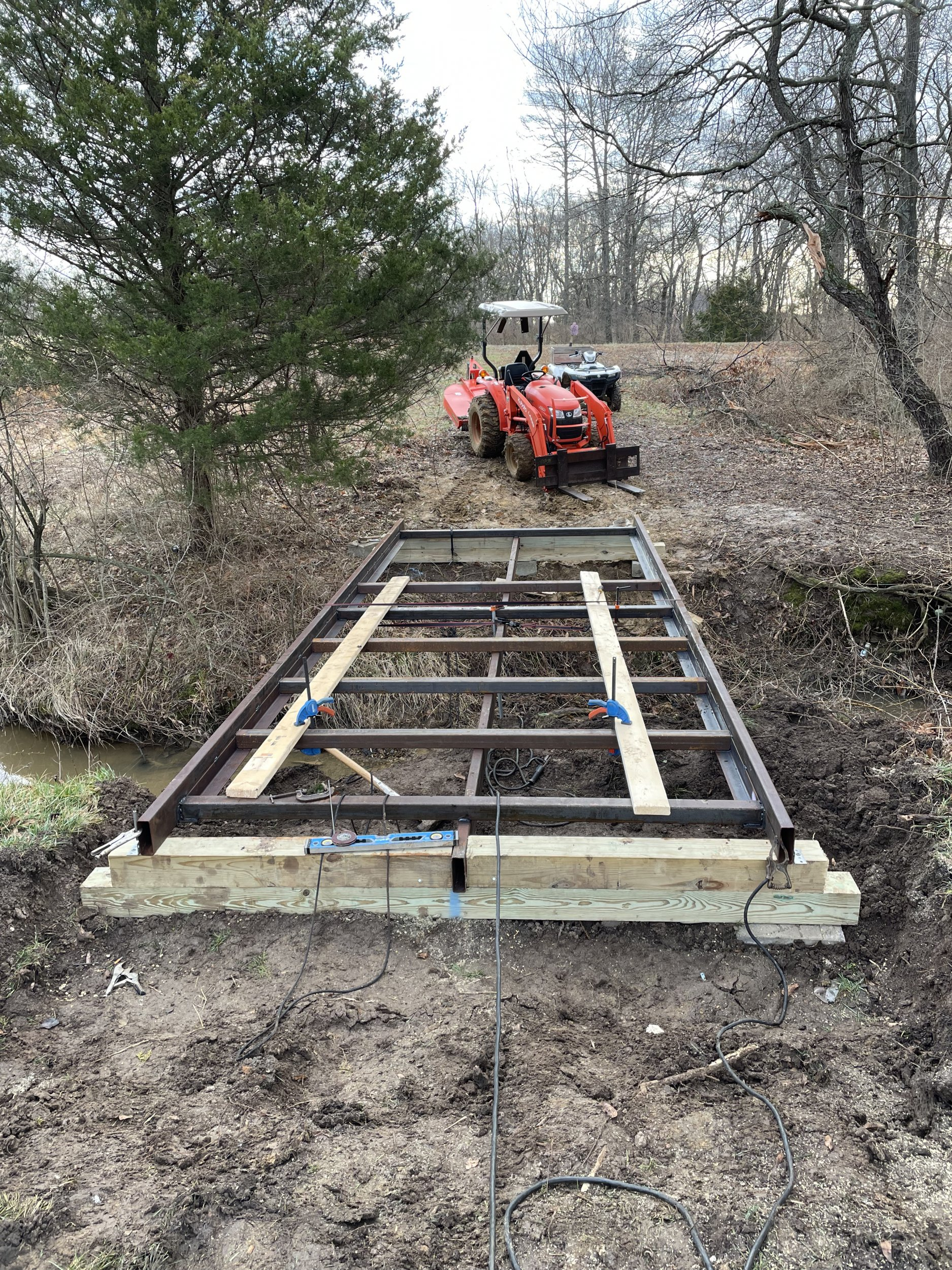

Welding is done!!!
Gonna set a string line on one side.
Throw some boards across and park both ATVs right in the middle and measure deflection……stay tuned 4600D044-DD48-49E3-BC0A-4B3BEE35D950.jpeg
/ Starting my bridge!!
#27

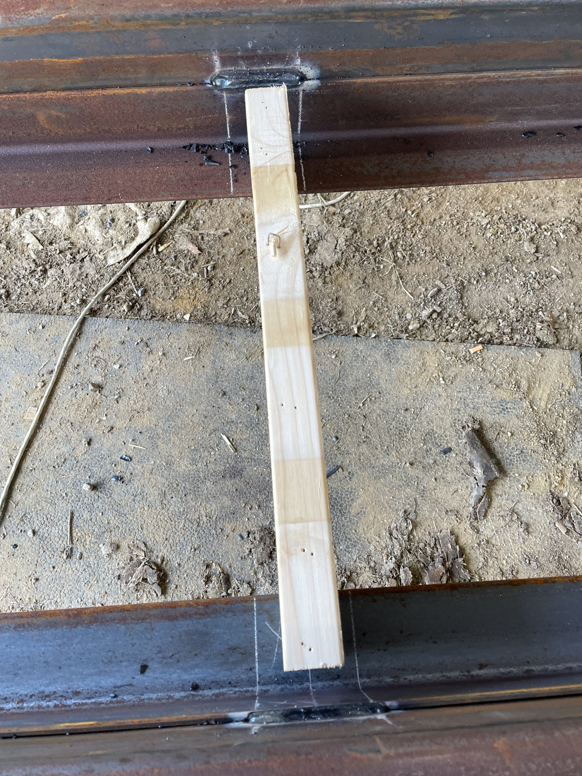

Results……
Started with a bit of a crown….approx 1/8”
I’d say there’s an 1/8” between the string and the 2x4. 1/4” sag.
I have some 3/8 crane cable….I may make a “u” under each stringer and use a turnbuckle to “arch” the bridge

The traditional metal bridge construction method was to use a truss design. From what I read, much of the strength in a utility trailer has to do with the sidewalls acting like truss members and even there, a single solid rod added as a reinforcing member to the top of the sidewall construction can add to the carrying strength. Also, having some sort of sidewall members on a bridge would seem to add to the safety factor.
#30
I plan on a railing/guardrail of some kind.
#31
An inexpensive rebar guard rail could act as a truss.
Scootr
I was gonna build that under the span with cable/turnbuckles/piece of steel center span
Tighten turnbuckle-arch bridge
/ Starting my bridge!! #33
I did find these tubing pretty thin, figured three of them with the cross members would've been sufficient... The two ATV you are about 1200lb, the average 1/2 tone truck is around 5500lb... unfortunately I don't think I would want to drive one across...
#34
Hence the cable/turnbuckle idea
I don’t NEED to drive a vehicle across.
Mostly a test of my skill to see if I can build so a vehicle can drive across
