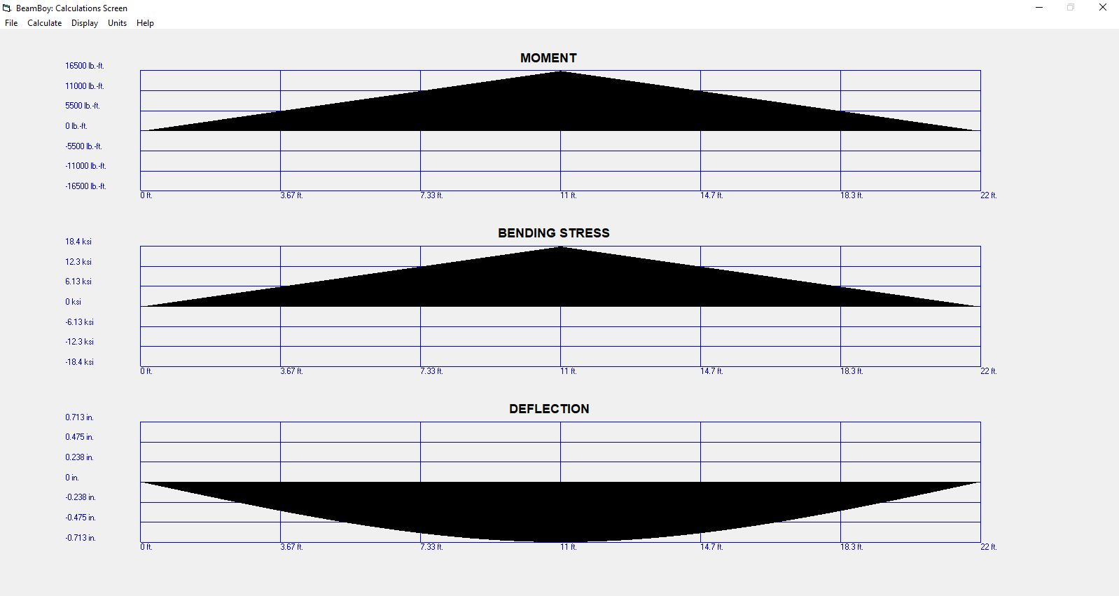

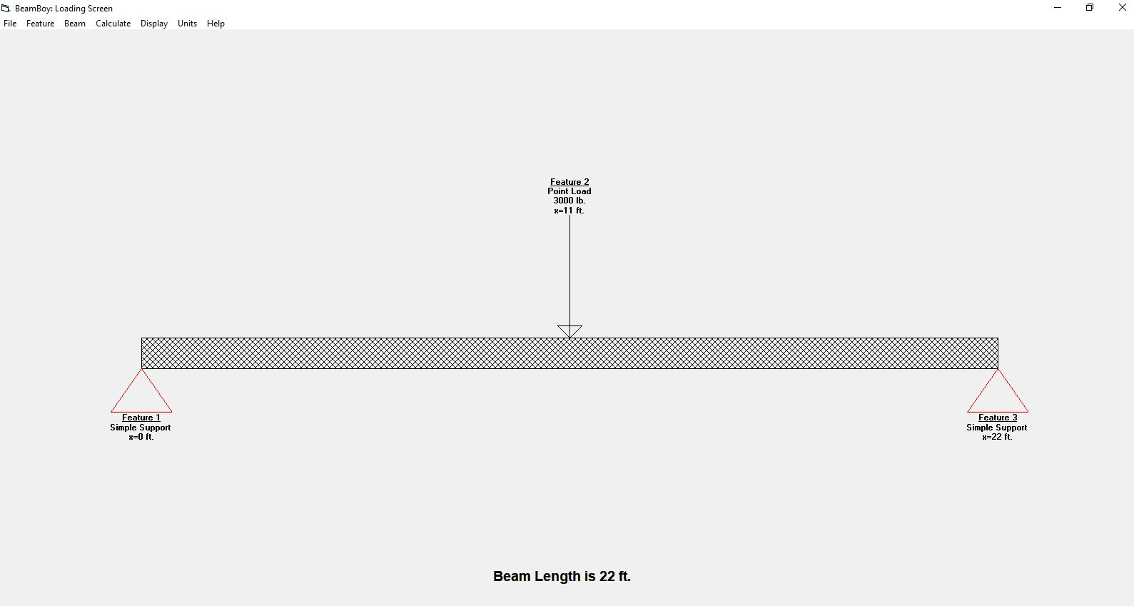

Basically the same thing as rigging.
Lifting chains and straps get derated when on an angle.
But I think your formula is sound for calculating tension for the example you give....like the car pulling on a cable tethered to anchors.
But I think why your numbers come up so much higher than mine.....is this isn't a freely flexing structure. You cannot discount the ability of the 2x6 itself to resist the load applied. Your formula of whatever weight being applied being a 10x or 15x factor in regards to tension is totally negating the strength of the main beam.
Definitely, this is to account for additional load.
If you're getting 5/8" deflection from 3000#, and your steel is basically rated for 5/8" deflection over 20' (240"/360 = 0.666), and you want to be able to put 6000# total on the bridge, you probably just need enough tension rod to hold the extra 3000" (once again, I'm not an engineer).
Personally, I'd spec out the tension rods to be capable of "holding" the entire load you want to put on the bridge and probably a bit more; in addition, I'd jack up the middle of the bridge a little bit so that when the rods are welded on, they immediately get some tension just from the empty bridge - effectively they're pretensioned a bit. If you have big enough rod to take it, you'd get a less bouncy bridge as a result.
   / Starting my bridge!! #126
I've been following these but haven't said much yet. Ning's calculations make perfect sense for the tension on the rod, assuming a specific deflection of the blue rod. But as LD1 pointed out, the loading characteristics of this are far more complex. So if the bridge deflects X in the middle, Ning's math on the tension in the rod will be generally correct. That is one important factor as you do not want to exceed the yield strength of the rod itself and you sure need to run that calc before you commit. BUT....
The bigger problem here is the materials. Yes I get the free aspect. But 1/8" wall is barely there from a structural viewpoint and attaching any point loads to it is asking for it to buckle or tear out locally. At the very least I would want to add on plates to the tube where the tension rods and center stay would connect, and probably add them on the bottom and sides of the tube (maybe top too). I would want these to extend for a significant distance to spread the load out on that thin 1/8" skin. And I have no idea how to even calculate how long those should be. And thinking more about it, the same issue is going to be there at the end supports too. And then it still might buckle at the edge of the reinforcing plates under excessive loads...
Secondly I am strongly recommending that you avoid rebar for this use. Rebar can be sketchy on composition and can be unweldable or lead to a very brittle weld or HAZ. I would stick with regular A36 steel to ensure the welds have a fair chance of working and being ductile. 7018 would be a good choice if you are stick welding this. You don't want to find out that weld is brittle when your vehicle is at center span. This is where "free" could be very costly...
The thin wall is the part that makes me cringe the most especially with the heavy vehicles you are targeting. I think your biggest risk is going to be local buckling or crumpling of the skin from point type loads. I'm not talking about Euler column buckling here but just exceeding the yield strength of the steel in localized spots.
I am not saying this design will or won't work, as I am not a full structural engineer (had all the statics, dynamics, strength of materials, etc coursework in college, but the real world is not quite the same as the books and I do not practice in that area). But there are serious concerns due to the materials at hand. That along with the unconventional methods of trying to compensate for the thin material makes it questionable. The above are my suggestions based on what you have done and are planning but I'm not saying it is a great idea to keep going this route. Foot traffic and ATVs? Sure. Tractor or truck? Yikes.

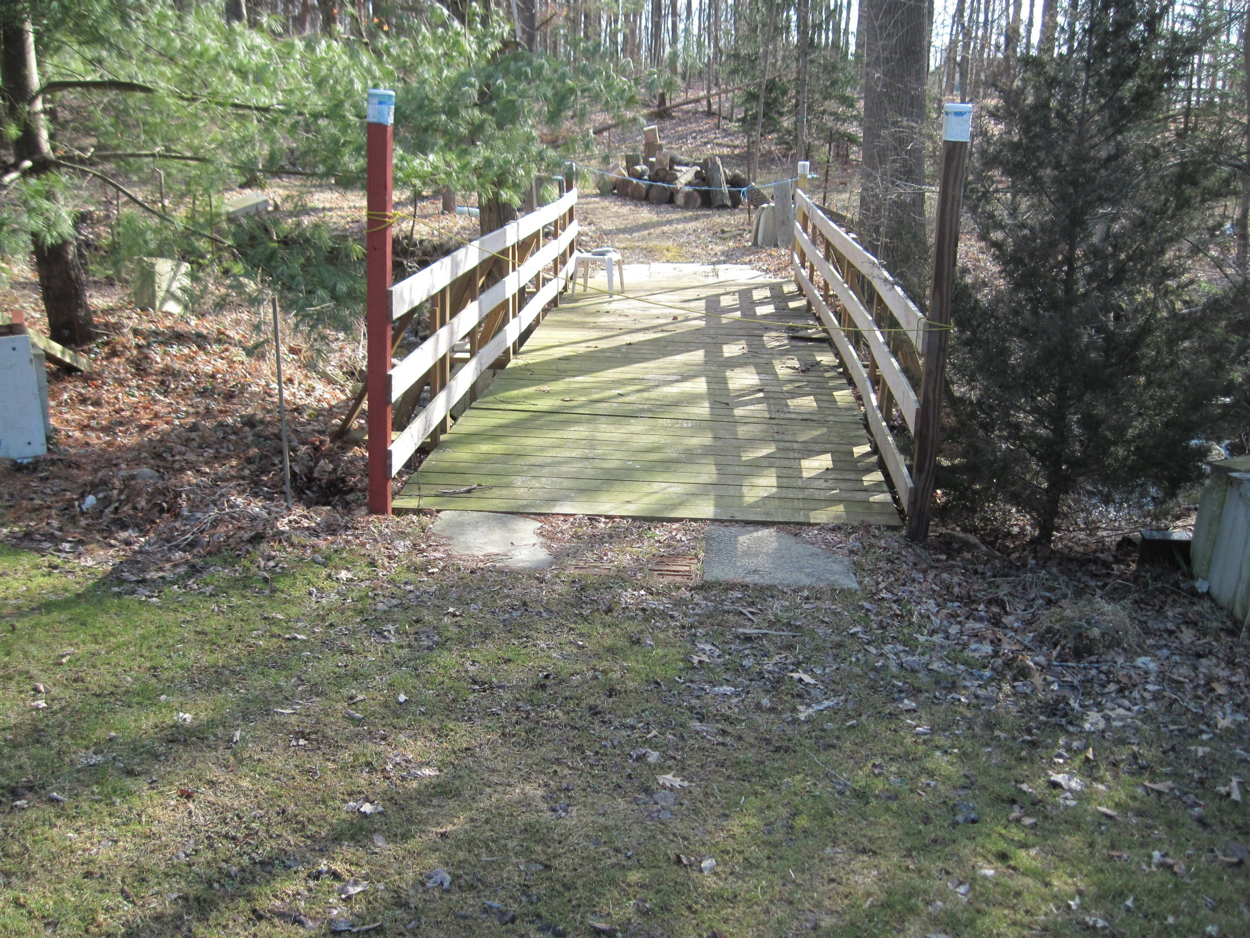

Thank you Doorman for posting. I'll have to look for your barn thread too. I never thought to look at this forum for projects. I'll be looking now. I'd like to see more pix of how the tubes are laid out.
I built a similar size bridge myself. It was one of my most fun projects ever. Hope it is for you too! A couple pix of the finished bridge. I wasn't intending to say so much, but only to encourage others to tackle what might at first seem hard. I built mine of treated wood: mostly 2x6x12's with a few 2x10 x12's. While I wouldn't hesitate to drive a car over it, if I could get it there, my goal was the Ford 8N I'm restoring. I had some free stuff. I salvaged about a 100 bolts which I used to bolt some 2x6's together. I did not bolt all of them, just those used to support the 8N width and my other smaller tractor width. It is sort of like a house floor under the 2x6 planks. I also had two I beams from my garage so those became my support ends on either side of the creek. I sunk 4x4 posts on the inside to hold in the beams which I just laid on a stone foundation. The main span was about 10-11 feet. But I extended both ends to take away the slope. I put one bolt in each of those, not two so that if it needed to rise for the water it would pivot. Only once that I know of did the water go that high. I watched the creek for a few years before this figuring out how high it would go. I used those 4x4 posts too to affix a roof truss to the center of the bridge for added support. I also looked at every bridge I came across while hiking various parks. After all this, I went on-line curious if there was any strength formulas. I guess that should have been my first step. But I was happy that what I did exceeded the expected weight. To relieve my erosion concern, (the bridge is in the middle of a horseshoe) I lined the creek edges with numerous 250 pound blocks that the local recycle shop had for free. But water is powerful. After several washed away, I then pounded rebar stakes through a few fortunate holes in the blocks and then bent over the ends.
