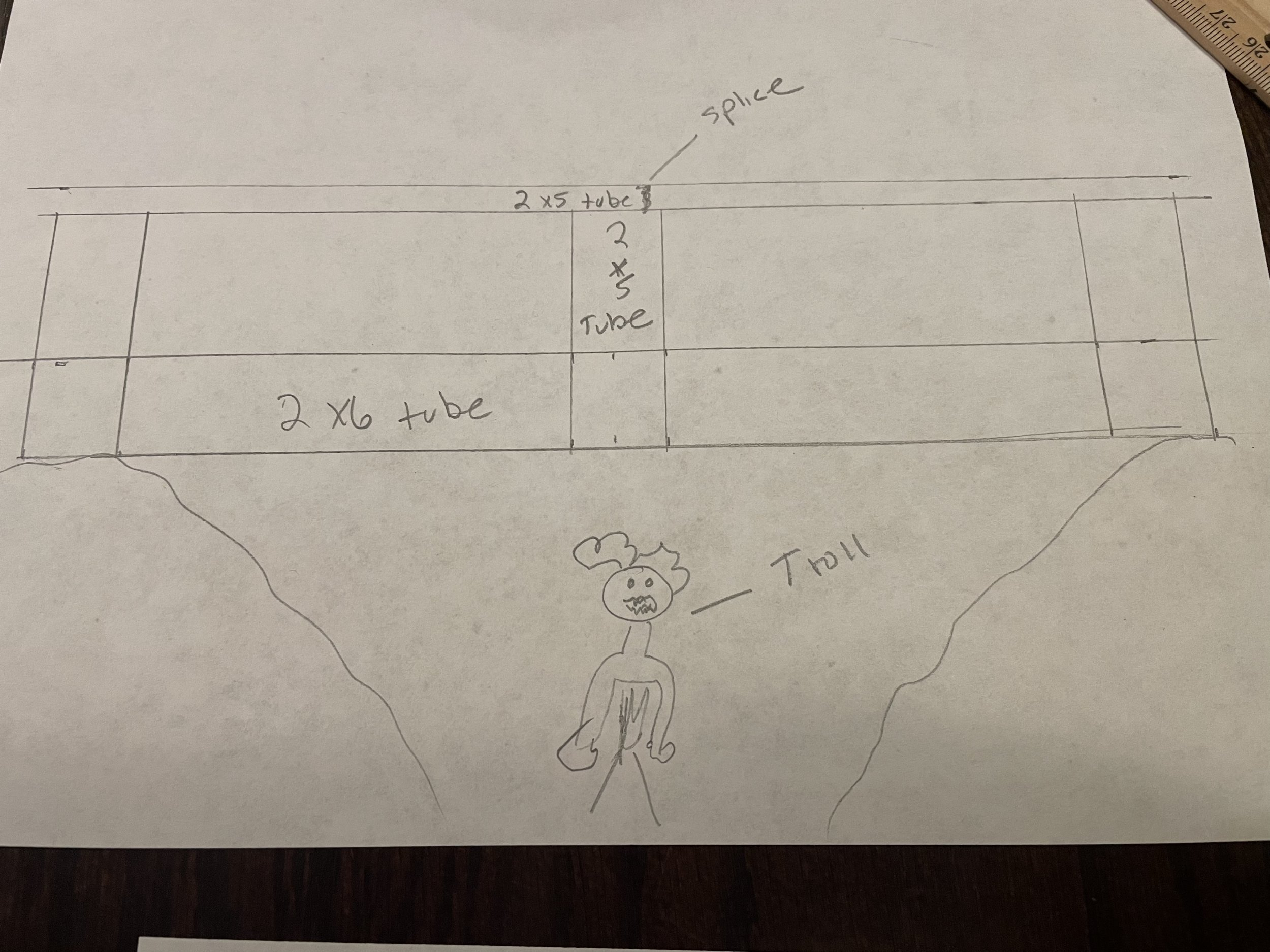

Put a couple angled pieces in that handral and you have essentially built a 40" tall truss....which will be ALOT stronger than just the 2x6 bottom tube. Maybe to the point of needing nothing more
I kinda figured that’s the route to go.
Any particular orientation for the “kickers”?
I’ll most likely notched the ends of the kickers to lap onto the vertical tube. Lots of surface to weld set up like this.

The railing doesn't have to be that strong. The end supports need to be able to carry whatever weight you're transferirng to the tension rods (easy, that's not much) and the railing needs to be sturdy enough in compression not to buckle. Neither of these are dealing with a multiplied force like the tension rods.
A couple of wood 2x6's is probably sufficient in compression if you can stiffen them, that's why I suggested that if you had more of the 2x6 tube that filling it with concrete would stiffen them. If the end supports are well anchored that would also help, but really this is the lightweight part of the design, just put something between the uprights that'll stay between them.
if the king truss is used above the deck you are making the railing a main structural element. Below the deck the deck is the compression member. You are also inducing a lot of stress in the end post connection. In former career I was lead bridge inspector

Hard to say.
Upside down V.....going from bottom of middle post out to the top of the two end posts puts that angle brace in tension. Angles the other way going from bottom outside to top of middle post puts them in compression.
Gut feeling makes me think either will be fine....and the ultimate yield strength of the structure will be limited to localized connections of the thin wall tubing.

Crappy mark up I know.
I’d notch the ends of the angle and have then lay on the face of the post. That would give me plenty of surface to weld too

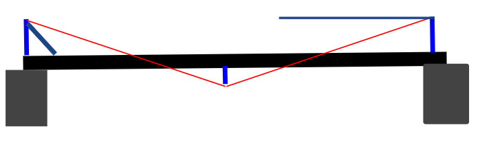

Truss or tension rod both have the same foundation needs, unless you're sinking an end post into the ground (unnecessary).
Either (right side post in drawing) there needs to be a member between the two upright end posts that can stand your load in compression, or (left side post in drawing) a diagonal brace serving the same purpose (can still have a light handrail).
Neither affects the foundation; all load on the foundation is as it was when you started this thread. Anchor one end of the bridge, maybe both ends (one side have slotted anchors? idk), with some way to account for thermal expansion of the bridge and it flexing under load.

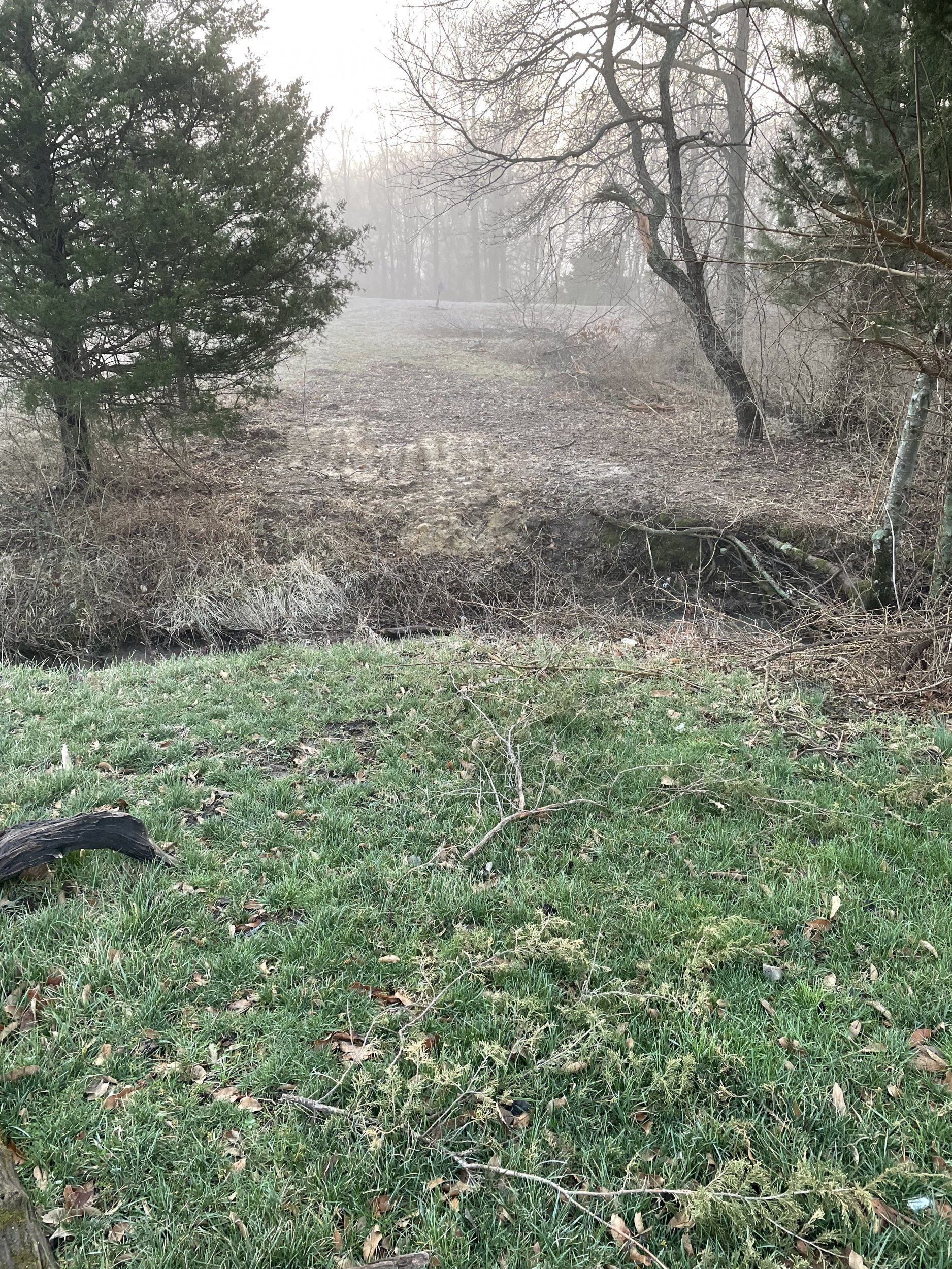

I’m planning to pour a concrete approach/abutment on one side for sure.
The other side is more difficult to get concrete too. I could fab a chute to get concrete across the bridge. May end up being some old Schlub mixing it by hand…….
Maybe some sort of grade beam/small slab on the far side with some slotted tabs for anchors in the concrete.

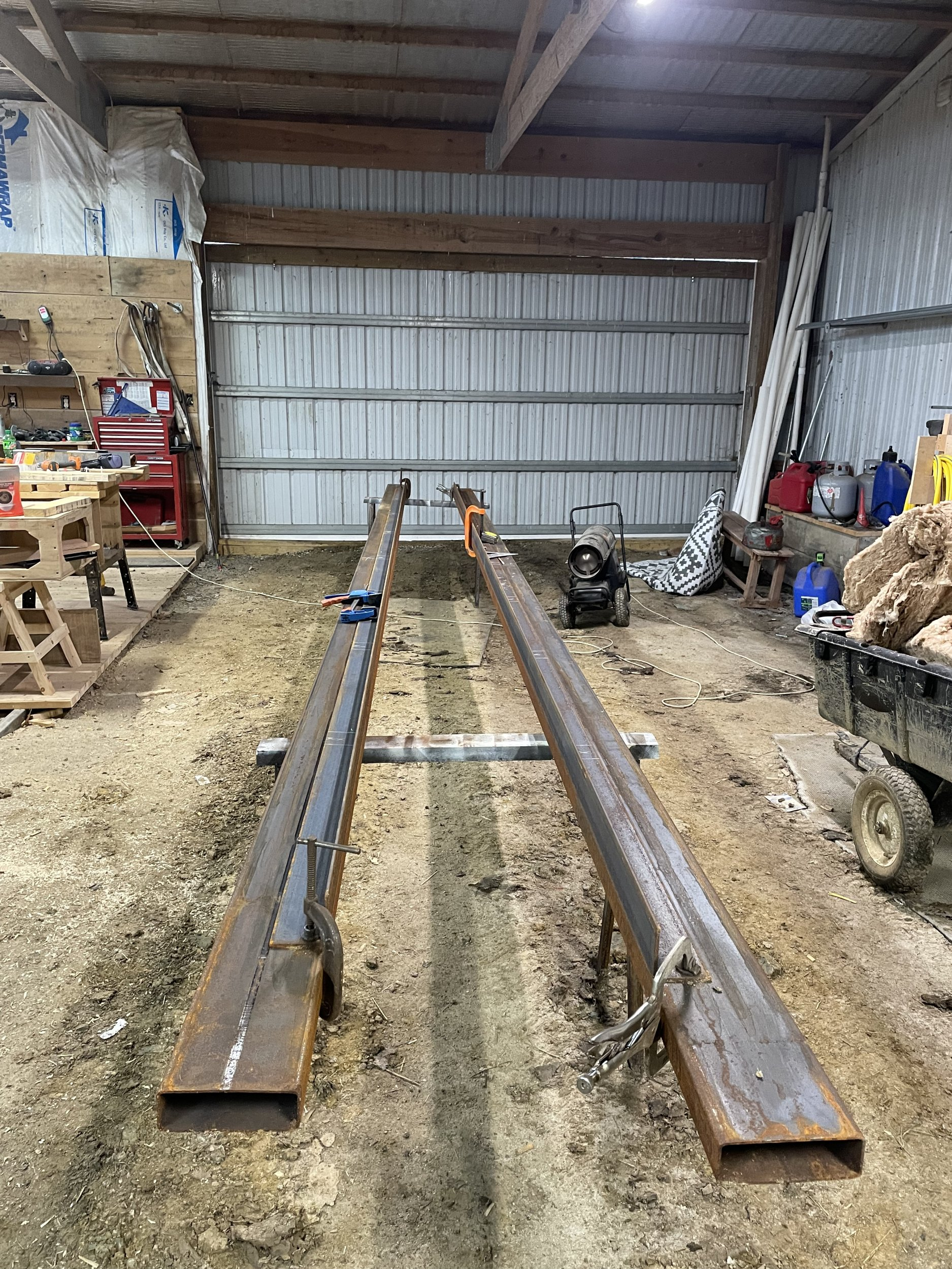

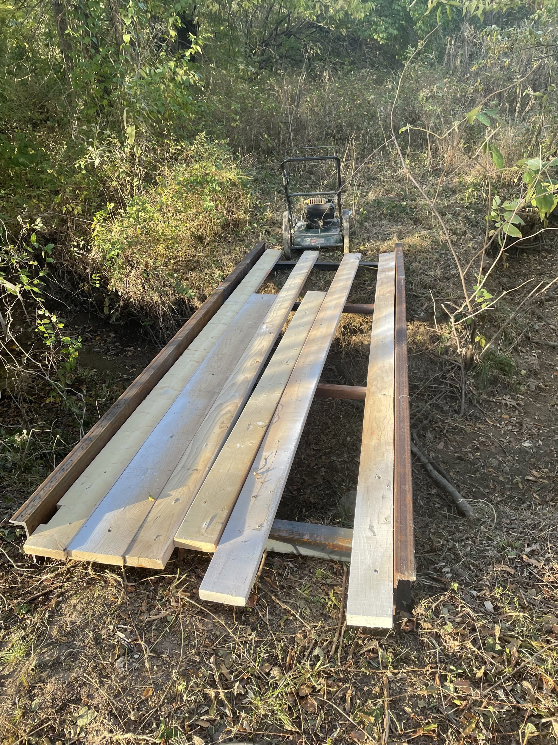

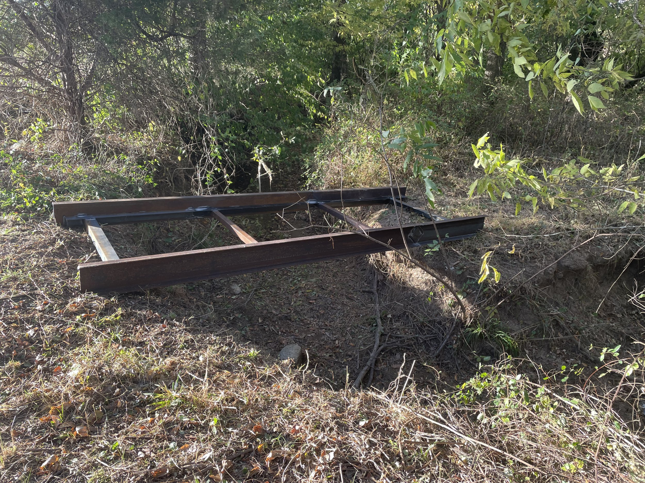

Back at the farm by myself with my work truck, welder, a truck full of steel “stuff” and a decent weekend weather wise to work on the bridge
Was chatting with a fellow ironworker today and my bridge came up.
He and another guy built a bridge to support a 11,000 pound truck.
They made “trusses” for the spans similar to what I’ll do.
He recommends cutting the end posts short and “bowing” the railing when I weld it. Then weld in my bracing.
Any thoughts on this idea?

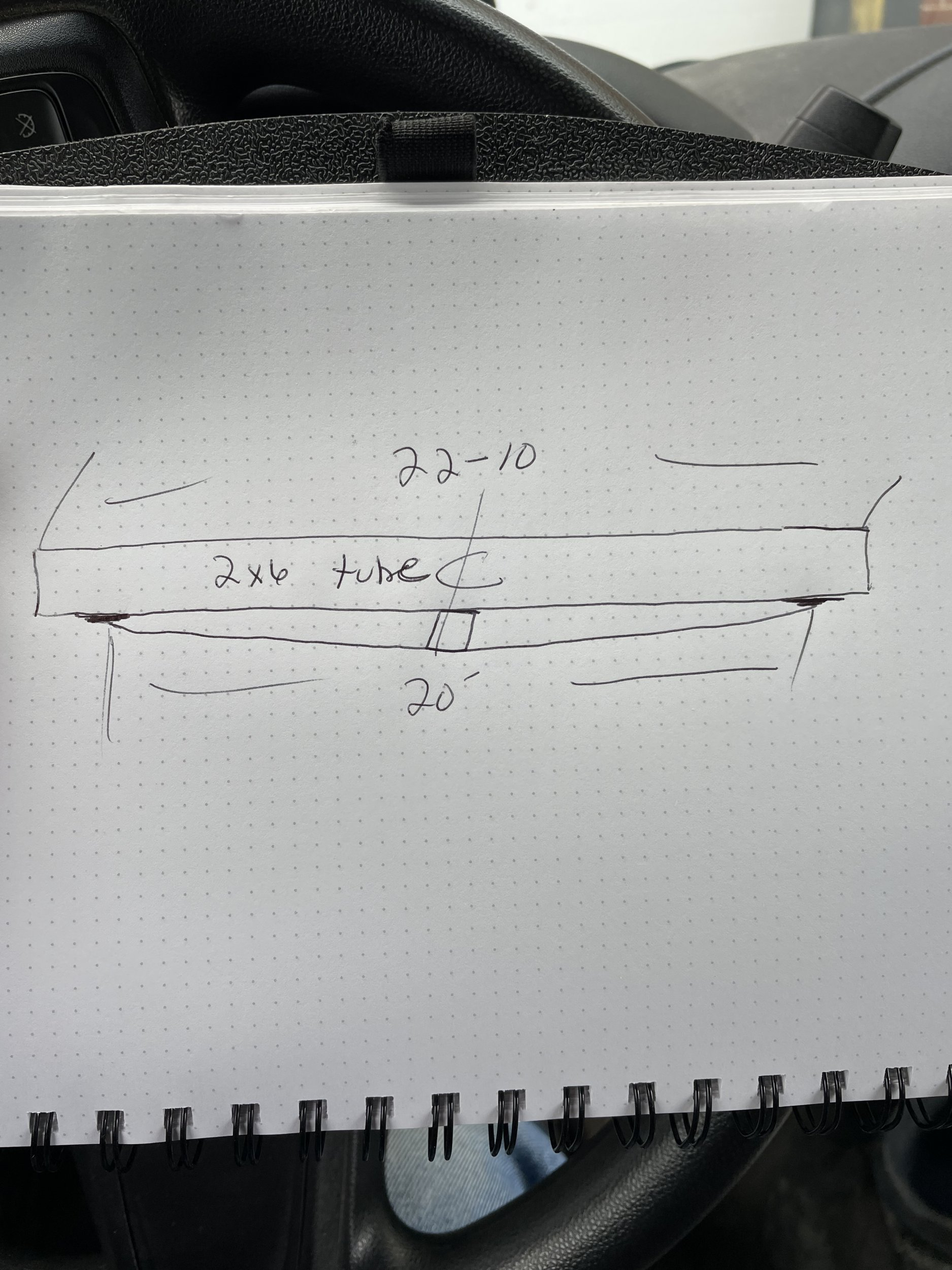

/ Starting my bridge!! #176

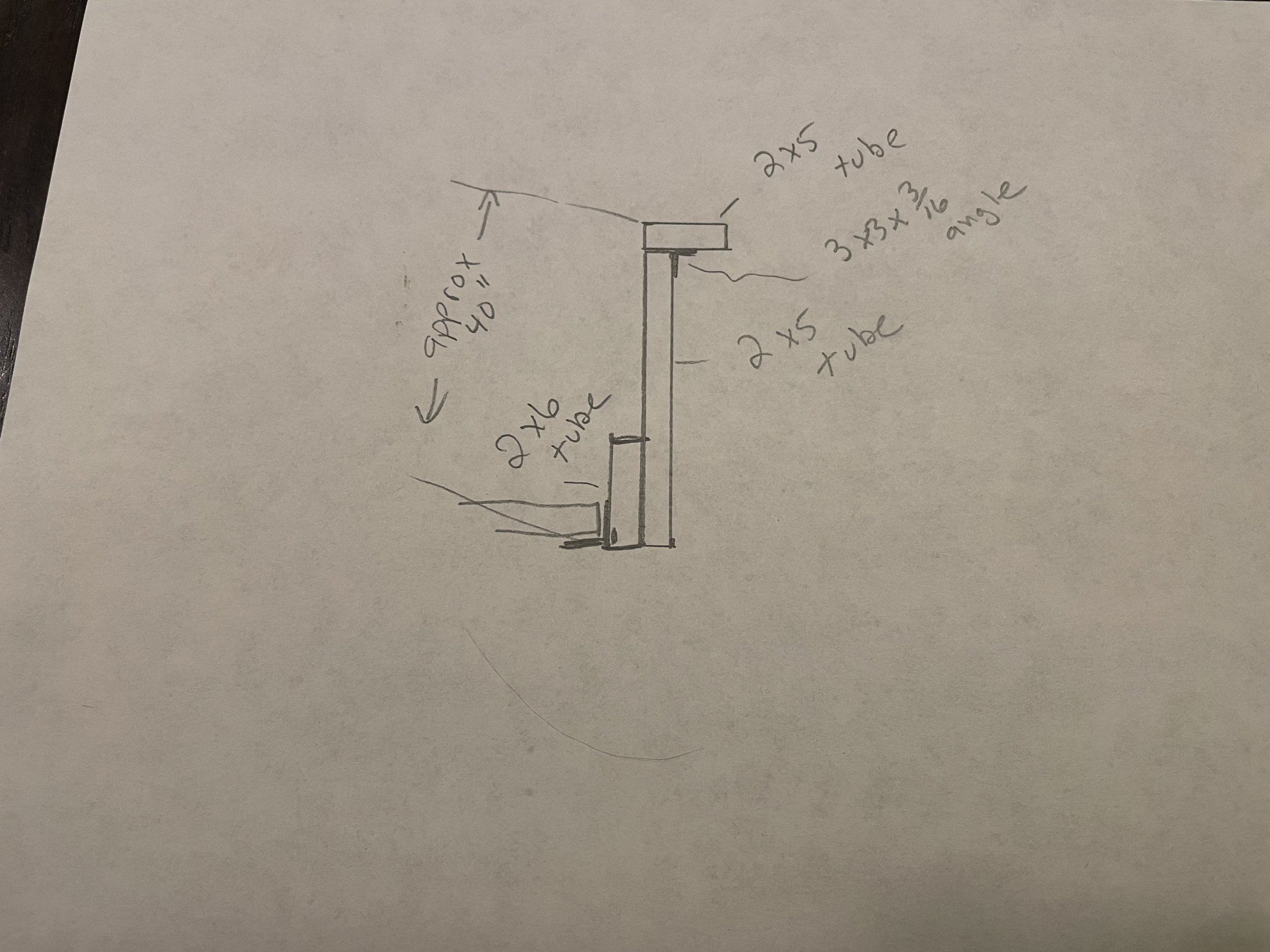

Can you post a diagram of your planned trusses?
Bruce
#177
This is pretty close.
Some angles on the ends going down to the stringers
