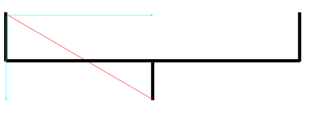

Works just like a truss, but upside down. The load is straight down on the end pillars.
Down, and in towards each other
The tension (diagonal) is made up of the vertical ("load straight down on the end pillars") plus the horizontal arrows (compressive force on the rail).

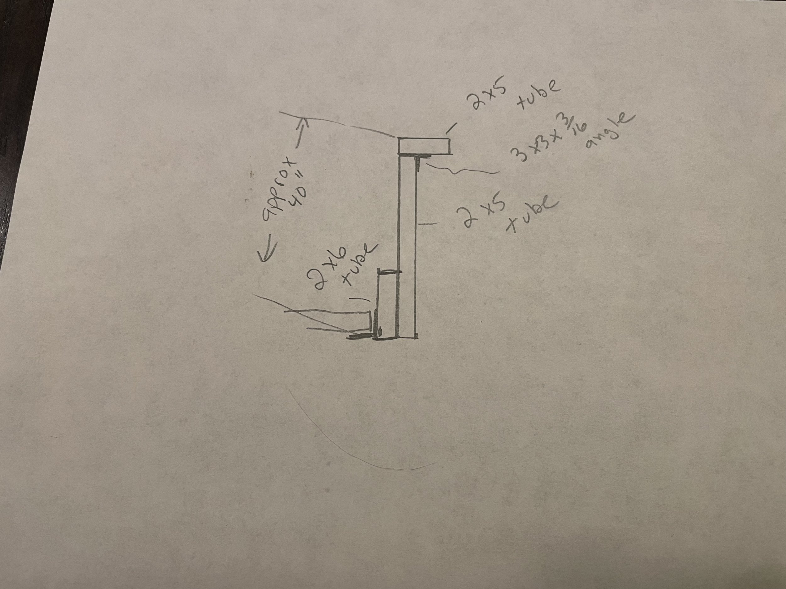

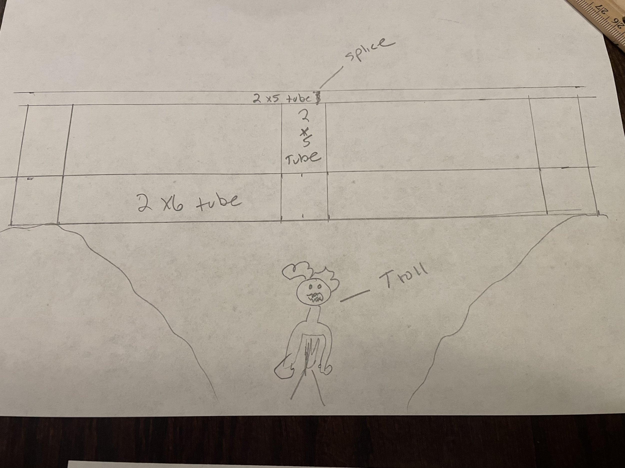

My current issue…….I’ve used all my long lengths of tube steel.
I may have 2 17’ish long pieces.
I can make a railing that would help with structural support but it would have to be pieced together.
So if you wizards (do engineers like to be called wizards?) can draw something with 2x5 tube/rebar/gusset plates/spit and blood…….I’m game

The railing doesn't have to be that strong. The end supports need to be able to carry whatever weight you're transferirng to the tension rods (easy, that's not much) and the railing needs to be sturdy enough in compression not to buckle. Neither of these are dealing with a multiplied force like the tension rods.
A couple of wood 2x6's is probably sufficient in compression if you can stiffen them, that's why I suggested that if you had more of the 2x6 tube that filling it with concrete would stiffen them. If the end supports are well anchored that would also help, but really this is the lightweight part of the design, just put something between the uprights that'll stay between them.
   / Starting my bridge!! #160
Put a couple angled pieces in that handral and you have essentially built a 40" tall truss....which will be ALOT stronger than just the 2x6 bottom tube. Maybe to the point of needing nothing more
