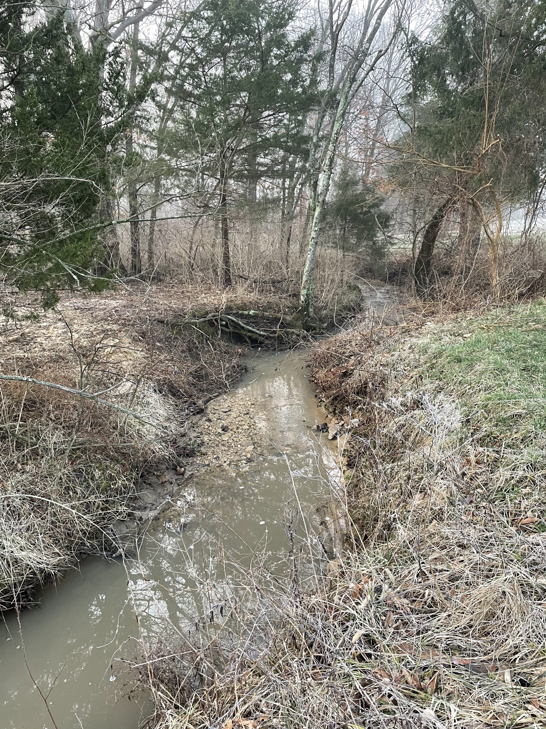

In my barn thread I mentioned a bridge build and people wanted me to post when I was building it.
Todays the day!!!
Approx 20’ span
Approx 7-8’ wide
2x6 tubes for the stringers
A center 2x6 tube under the stringers
3x3 tubes for cross members
6x6 treated timbers for the “foundations” on each end.
End goal is to drive a vehicle across!
View attachment 786740View attachment 786742View attachment 786743View attachment 786745

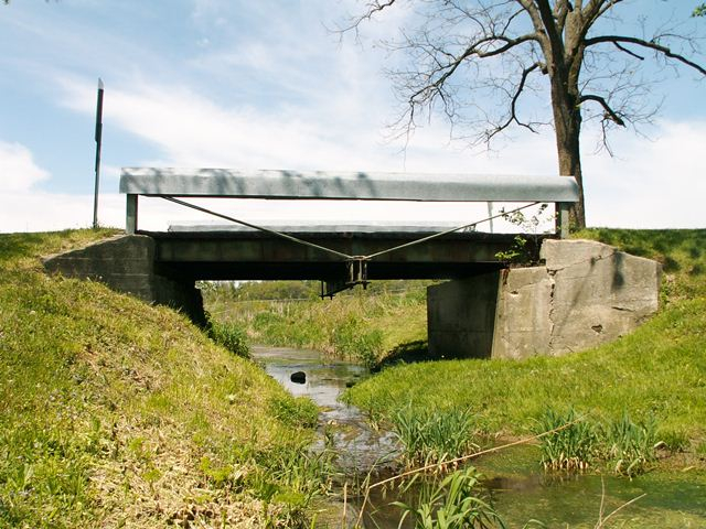

If you want side rails and have low clearance below the bridge, you could use a design with the roadway on the lower level of the tension bars.
Also look at photos of inverted king post bridges.
Bruce
   / Starting my bridge!! #148
Bruce

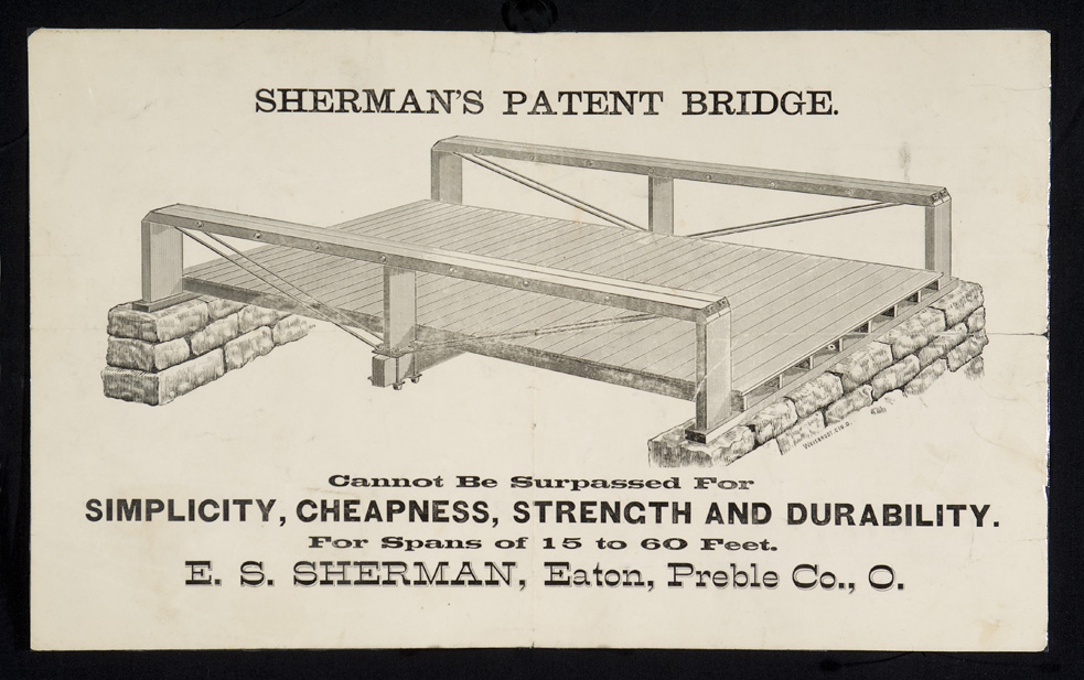

The "inverted king post" (what I was descriptively calling "the standoff") only needs to be strong enough to handle the load that's transferred to the tension rods, in compression. In the above bridge pic, there's a substantial beam there because it's probably tying multiple boards together as well as serving as the king post.
Looking at web images, in this example
there's a relatively insubstantial king post, probably because this particular beam is the only load that's being carried.
Found this also, for amusement:
I think that makes a good bridge design. It's nice to have the side rails, and they provide significant strengthening as well without imposing much on the flow of water (& debris) under the bridge.
With a 2x6 under the bridge, and say 6" bridge thickness, an 18" side rail height above the bridge, you have an effective inverted king post height of 30" in the middle of a 240" span. Taking the arctangent of (30/120) gives 14°; the hypotenuse (diagonal) length is about 124. The ratio of the hypotenuse to the height being (30/124), about 4, so for every 1000# you want the tension rods (collective - all of them together) to hold, you need 4000# to be carried by the rods. There being 4 rods, each one has to carry 1000#, if you're relying on all of them.
It's a decent triangle at that height and being supported up higher it seems very workable. If your bridge is happily holding itself right now, and you want to have 7500# travel over it, with this triangle (and no engineering degree) I'd want rods that can hold 7500# in tension each just for overkill (a very non-engineering term). Mild steel as far as I can tell has a 60,000psi tensile strength; 1/2" round is 0.2 sq inch, so 1/2" round should be good for 12,000# tension, so it should be plenty good for this sort of setup (that being the inverted king post like these bridge pics).
Note that in Sherman's patent bridge, the post above the under-bridge beam is really only there to support the rail going across - it doesn't have a significant part to play in the load-transfer-tension setup.
A downside to this arrangement is that the tension rods are attached to the ends of the guard rail, so that rail needs to be strong enough to handle a compressive force without buckling. In the original design where the tension rods are anchored to the ends of the bridge, it's already playing that part well. Maybe if you take one of your 2x6 rectangular, and fill it with concrete, use that as a rail/
