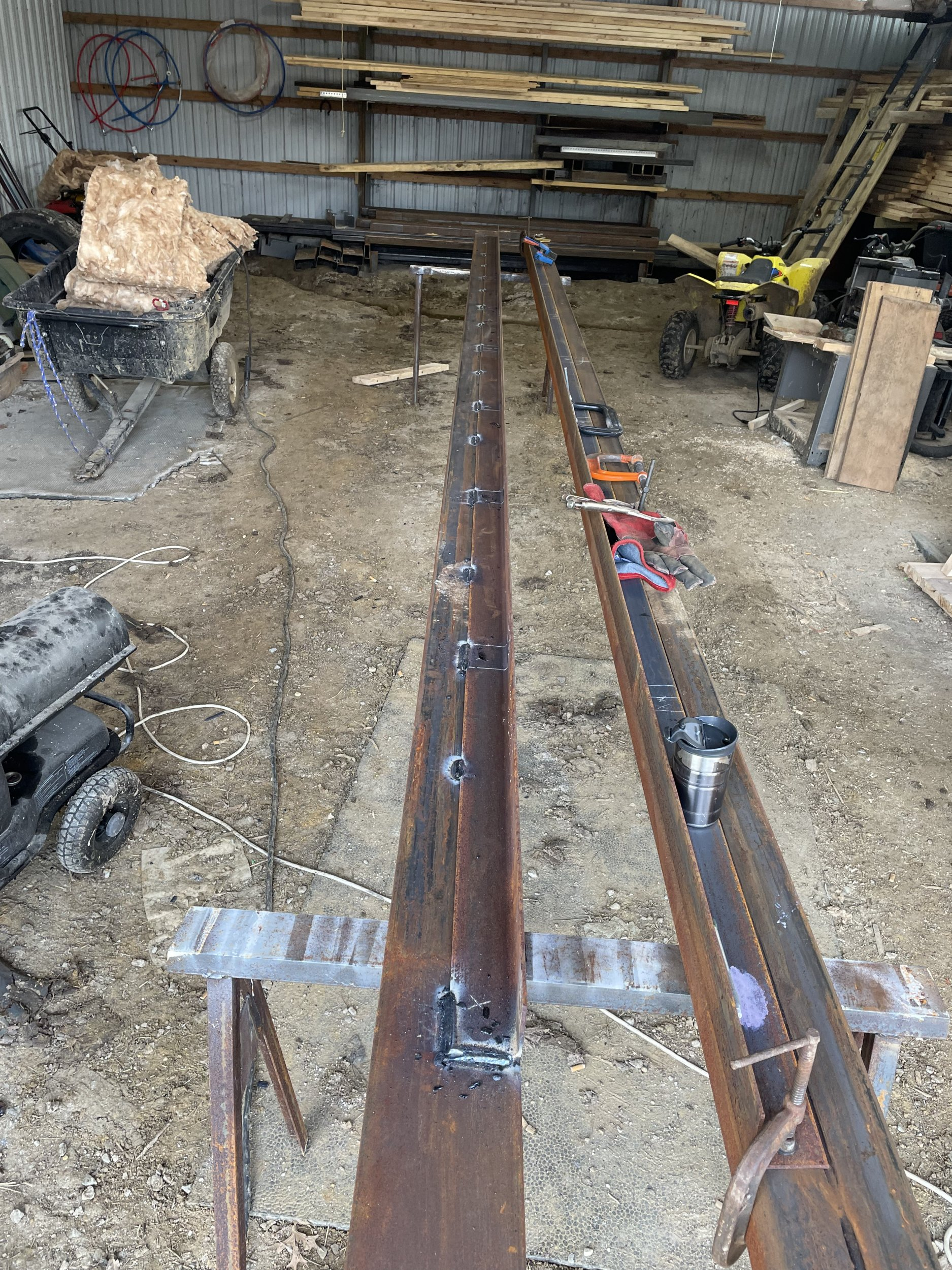

I’ve come upon some 1” solid round shaft-approx 16 pieces about 7’ long.
I may fab someway to space them in between my 3x3 tubes that are 30” apart and split that distance in half.
This should let me run my decking as 2x6 on the flat.
Gonna stir this in my brain and see what I come up with.

But I think why your numbers come up so much higher than mine.....is this isn't a freely flexing structure. You cannot discount the ability of the 2x6 itself to resist the load applied. Your formula of whatever weight being applied being a 10x or 15x factor in regards to tension is totally negating the strength of the main beam.
Definitely, this is to account for additional load.
If you're getting 5/8" deflection from 3000#, and your steel is basically rated for 5/8" deflection over 20' (240"/360 = 0.666), and you want to be able to put 6000# total on the bridge, you probably just need enough tension rod to hold the extra 3000" (once again, I'm not an engineer).
Personally, I'd spec out the tension rods to be capable of "holding" the entire load you want to put on the bridge and probably a bit more; in addition, I'd jack up the middle of the bridge a little bit so that when the rods are welded on, they immediately get some tension just from the empty bridge - effectively they're pretensioned a bit. If you have big enough rod to take it, you'd get a less bouncy bridge as a result.
   / Starting my bridge!! #126
I've been following these but haven't said much yet. Ning's calculations make perfect sense for the tension on the rod, assuming a specific deflection of the blue rod. But as LD1 pointed out, the loading characteristics of this are far more complex. So if the bridge deflects X in the middle, Ning's math on the tension in the rod will be generally correct. That is one important factor as you do not want to exceed the yield strength of the rod itself and you sure need to run that calc before you commit. BUT....
The bigger problem here is the materials. Yes I get the free aspect. But 1/8" wall is barely there from a structural viewpoint and attaching any point loads to it is asking for it to buckle or tear out locally. At the very least I would want to add on plates to the tube where the tension rods and center stay would connect, and probably add them on the bottom and sides of the tube (maybe top too). I would want these to extend for a significant distance to spread the load out on that thin 1/8" skin. And I have no idea how to even calculate how long those should be. And thinking more about it, the same issue is going to be there at the end supports too. And then it still might buckle at the edge of the reinforcing plates under excessive loads...
Secondly I am strongly recommending that you avoid rebar for this use. Rebar can be sketchy on composition and can be unweldable or lead to a very brittle weld or HAZ. I would stick with regular A36 steel to ensure the welds have a fair chance of working and being ductile. 7018 would be a good choice if you are stick welding this. You don't want to find out that weld is brittle when your vehicle is at center span. This is where "free" could be very costly...
The thin wall is the part that makes me cringe the most especially with the heavy vehicles you are targeting. I think your biggest risk is going to be local buckling or crumpling of the skin from point type loads. I'm not talking about Euler column buckling here but just exceeding the yield strength of the steel in localized spots.
I am not saying this design will or won't work, as I am not a full structural engineer (had all the statics, dynamics, strength of materials, etc coursework in college, but the real world is not quite the same as the books and I do not practice in that area). But there are serious concerns due to the materials at hand. That along with the unconventional methods of trying to compensate for the thin material makes it questionable. The above are my suggestions based on what you have done and are planning but I'm not saying it is a great idea to keep going this route. Foot traffic and ATVs? Sure. Tractor or truck? Yikes.
You guys are all great when it comes to the info!!!
My 2x6 tubes (on the outboard ends) have a piece of 3x3x3/16 welded to them to carry the 3x3 cross tubes.
I can call my steel supplier about rod stock instead or rebar on Monday.
I can add additional plate reinforcements if need be.
Current thought process is to weld rod/rebar to 4x6x3/16 plates on ends.
Obviously if all this fails to be safe…..piers in the center of span will be installed

Rebar is very weldable. Use it or rod which ever is cheapest
20’ stick of 5/8 is $13 I believe
3/4 isn’t much more
I’ve welded plenty of bar.

Dstig1 had very similar thoughts to mine, he just said it better, mainly in regards to plates at connections and not using rebar. I have seen a lot of rebar handled at construction sites and when guys are carrying long sticks of it it just bows a lot and flops around. In tension that’s fine but in compression it just seems it would buckle easily. Square tubing, round tubing, I beams etc seem to be a better choice. It sounds like you got a lot of scrap a couple of days ago that could be used.
