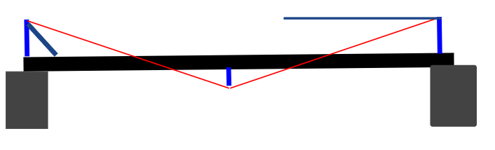

A “truss” design seems to make the foundation less important.
Can I eliminate the top tube, replace with angle iron and a wood cap?
If what I’m reading you guys are posting it seems that my be an option.
Truss or tension rod both have the same foundation needs, unless you're sinking an end post into the ground (unnecessary).
Either (right side post in drawing) there needs to be a member between the two upright end posts that can stand your load in compression, or (left side post in drawing) a diagonal brace serving the same purpose (can still have a light handrail).
Neither affects the foundation; all load on the foundation is as it was when you started this thread. Anchor one end of the bridge, maybe both ends (one side have slotted anchors? idk), with some way to account for thermal expansion of the bridge and it flexing under load.

I’m planning to pour a concrete approach/abutment on one side for sure.
The other side is more difficult to get concrete too. I could fab a chute to get concrete across the bridge. May end up being some old Schlub mixing it by hand…….
Maybe some sort of grade beam/small slab on the far side with some slotted tabs for anchors in the concrete.
I can definitely duplicate either or both sides of your pic @ning

For a short span bridge you don’t need to worry about expansion at you abutments

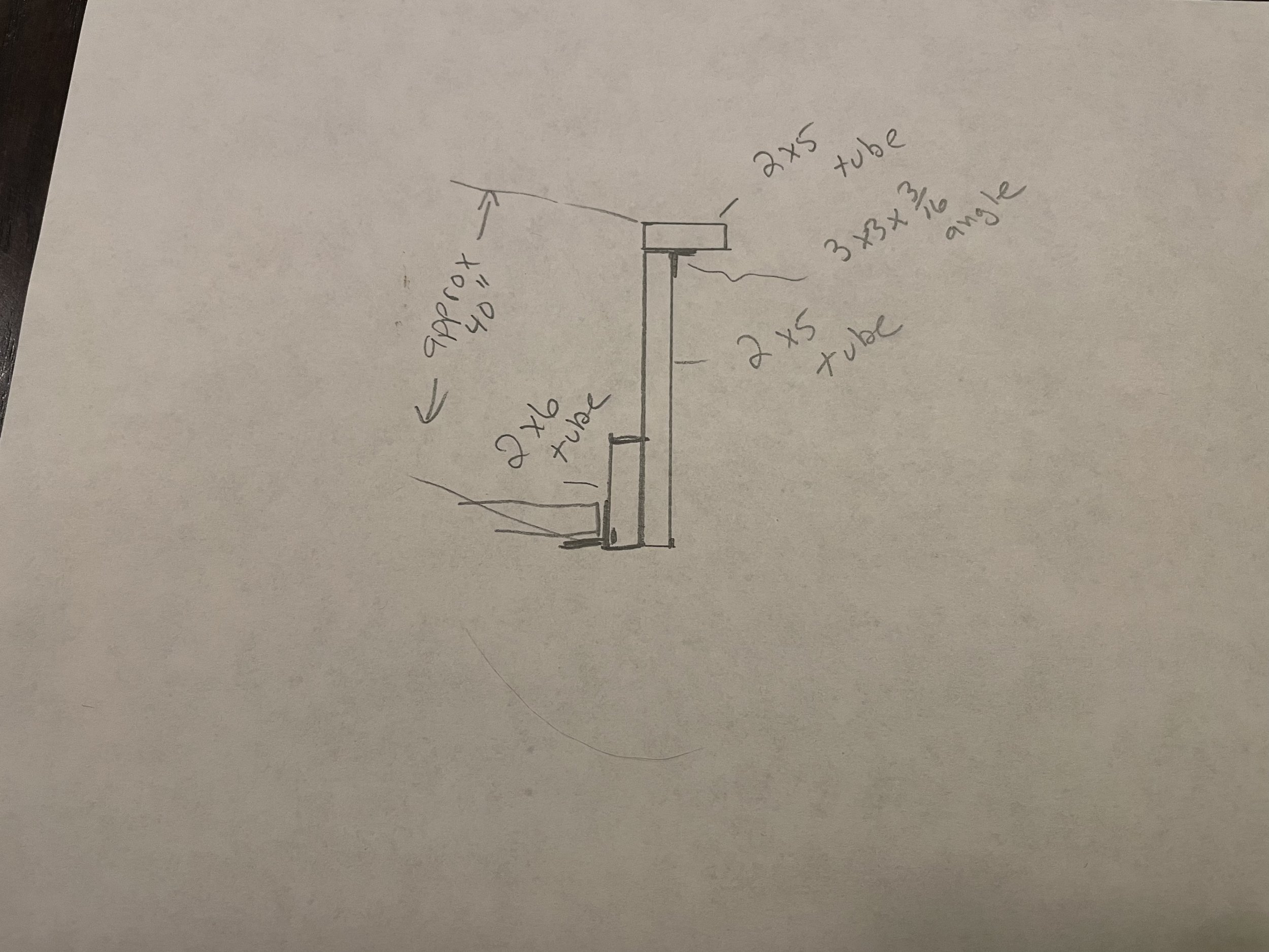

Can you post a diagram of your planned trusses?
Bruce
/ Starting my bridge!!
#177
This is pretty close.
Some angles on the ends going down to the stringers
