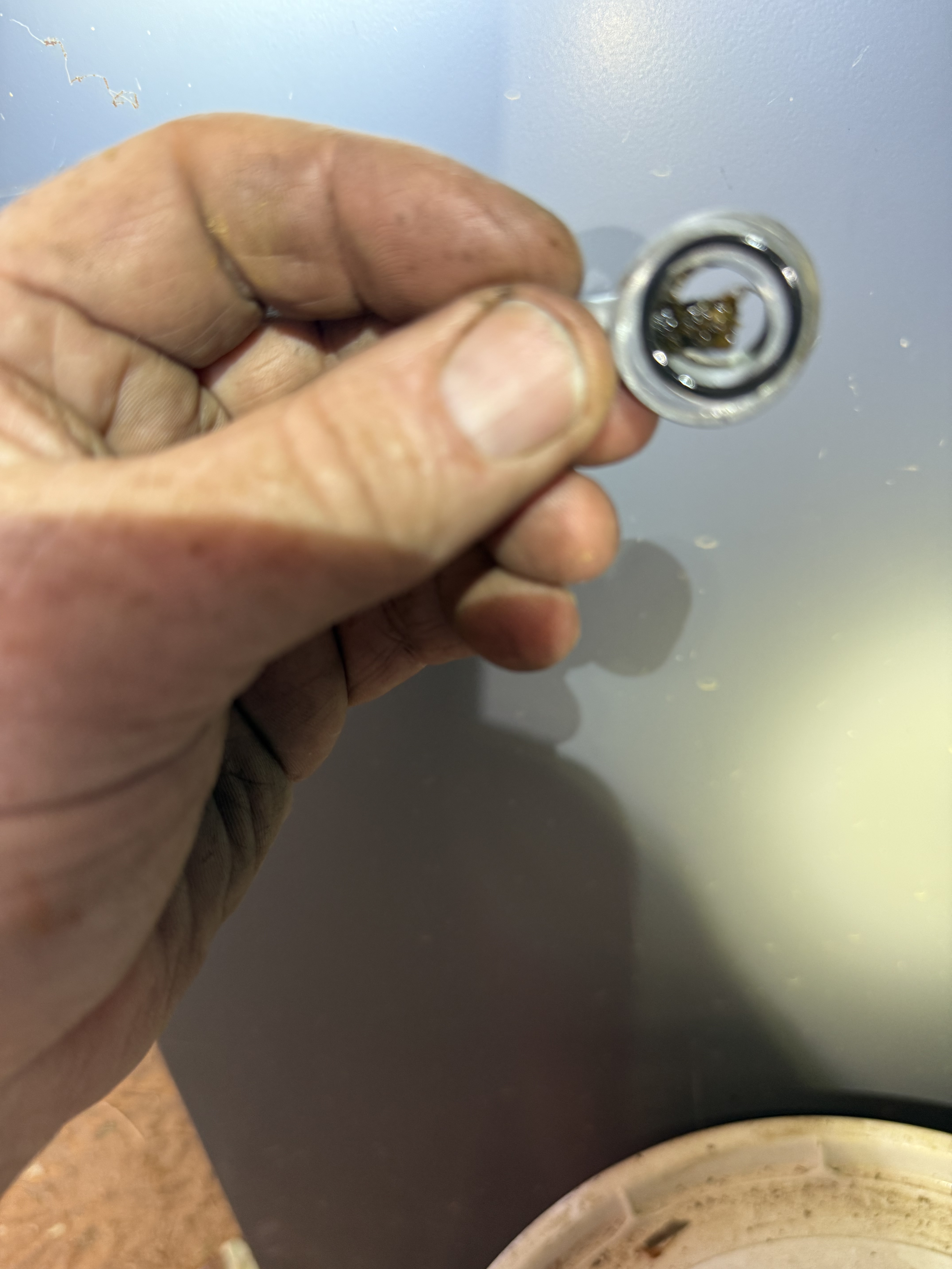

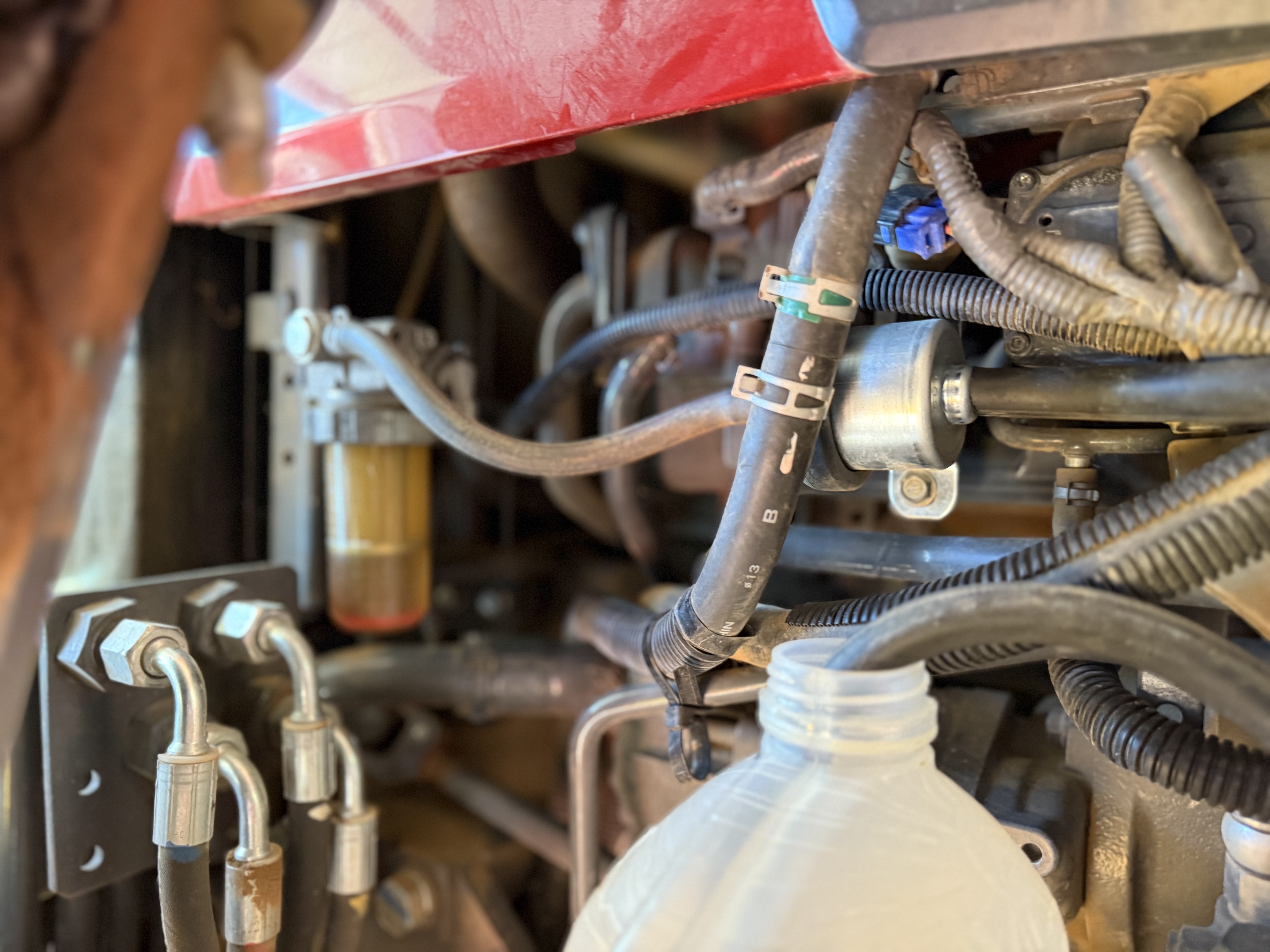

here’s where I’m at so far thanks for all the great suggestions.i Checked for flow after the fuel pump was just barely sputtering blew air backwards in the fuel line before the water separator couldn’t really get it to siphon there, but I did check the water separator filter, banjo, bolt inlet, and it had a plug of grass or manure in it. Cleaned this out and try running tractor today. See how it performs. Going to put a in-line fuel filter because the banjo bolt is so small. it doesn’t allow debris to make it to the screen filter on fuel water separator hoping for the best. I will respond after any changes thank you all
You likely find your issue. But that brings up one question. How did that grass/manure get in there to begin with?
Perhaps time to adapt a filter of some type to your fuel inlet at the tank. While I’ve never needed one, I know some use stainless steel tea strainers ( that are cylindrical and if you’re lucky just fit perfectly in the tank inlet).
Wish I could remember a link somewhere where these have been discussed in detail: maybe somebody else has one…

That was a clue, like you said the banjo bolt to the inlet of the waterseparator, had a plug of grass or manure running good so far

That was a clue banjo bolt at fuel inlet was clogged cleaned it running good so far, put in line filter,thanks rscotty
