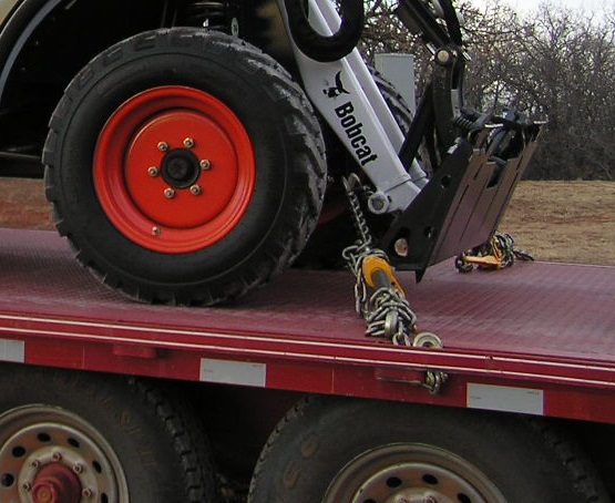

When you use the stake pocket, the hook is protected by the rub rail:
When I use straps on the rub rail, nothing can rub them on the rail. :laughing:
/ Stake pocket tie-down anchors ? #7
I do use them on my PJ trailer. I made 6 of my own for about 1/2 the price of store bought ones. I think its much easier to pass the chain through the D-ring then use the ratchet binders. That's just my preference but there is nothing wrong with dropping the chain through the pocket and hooking the grab hook over the top of the pocket like others have shown. There is a video by PJ in my link. I bolted D-rings on my tractor frame also for easy tie down points. I don't like wrapping chains around the axles.

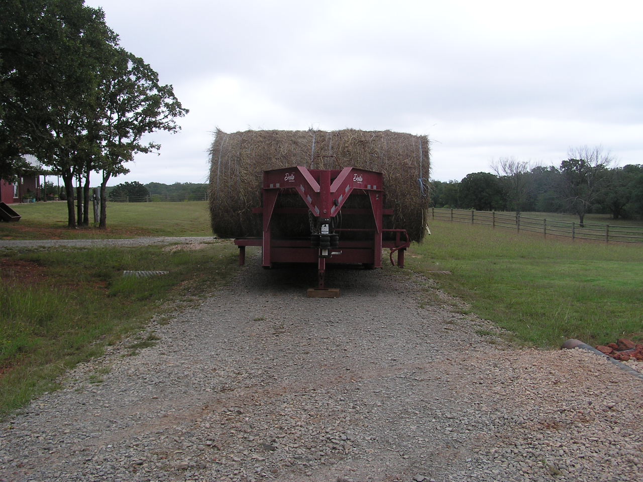

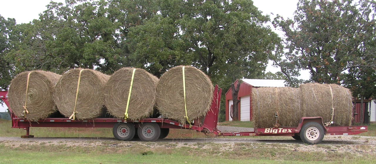

/ Stake pocket tie-down anchors ? #10
/ Stake pocket tie-down anchors ? #11
Its good to see someone secure a load correctly. Around here folks would have put 6 more round up top (overload). BTW - very nice and tight rounds - what baler are you using?
We bought those 5x6 from my wife's cousin, he used a neighbor's baler, don't know what brand.
They weighed 1300 to 1400 pounds, so close to overloaded.
