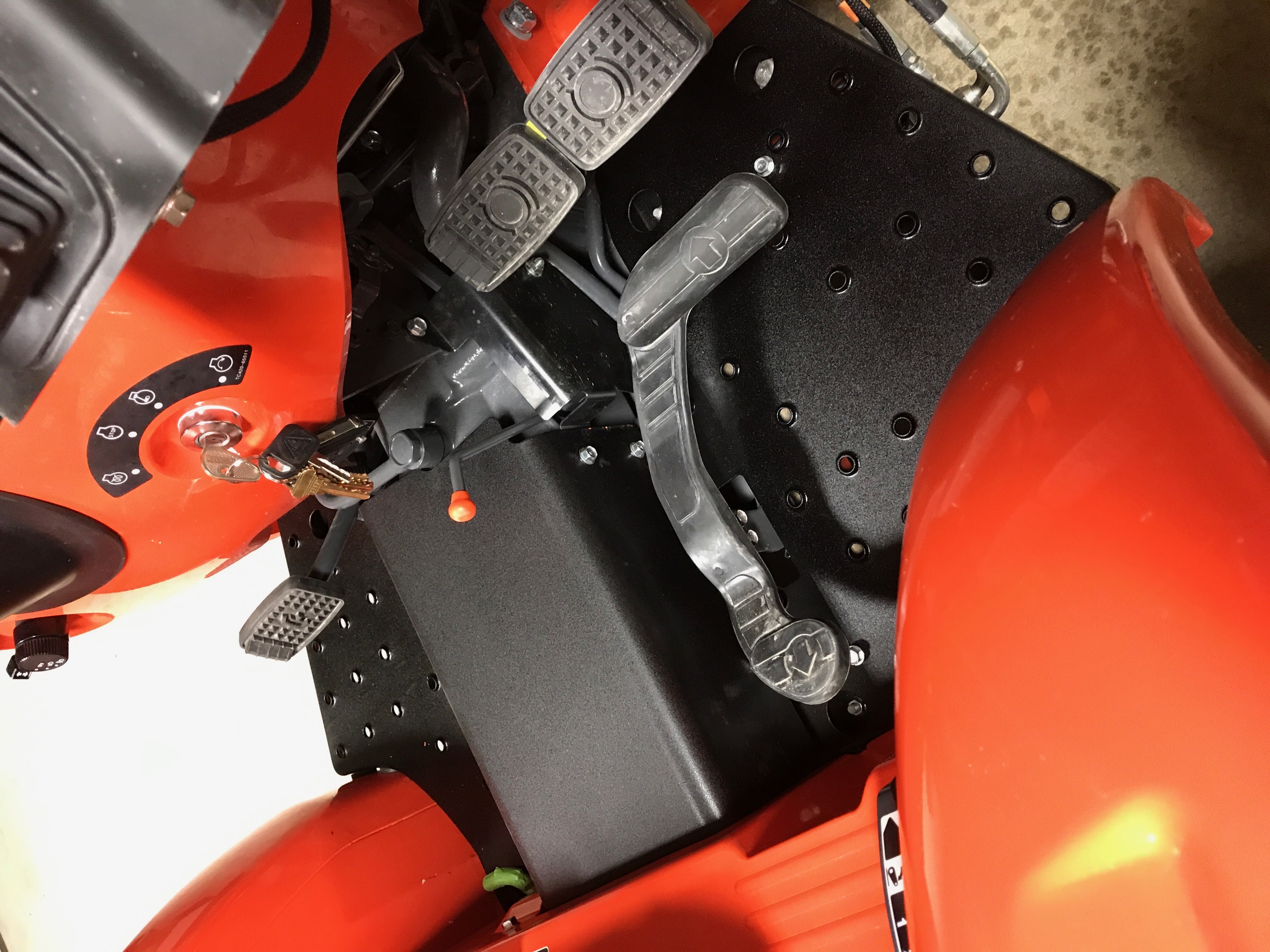

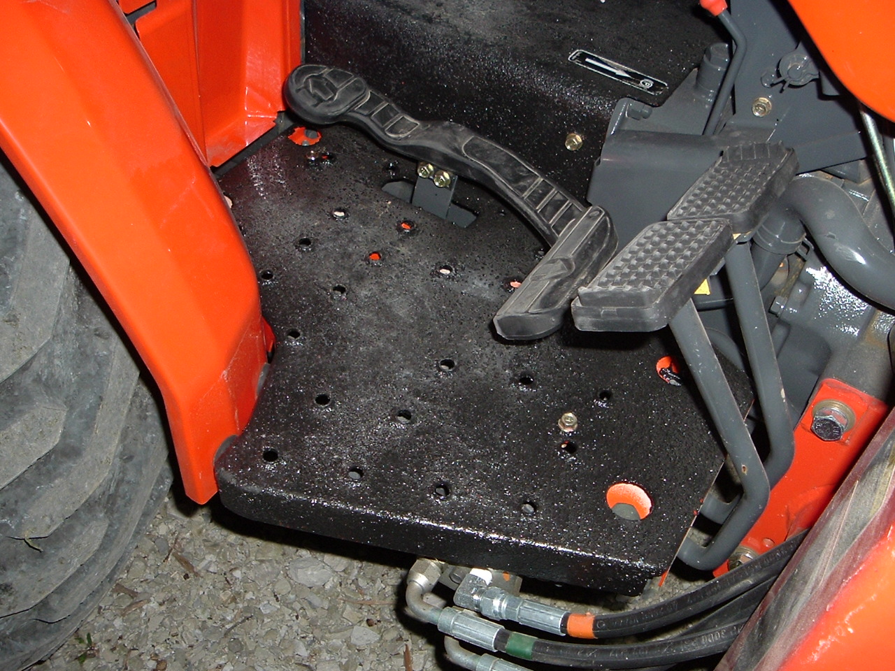

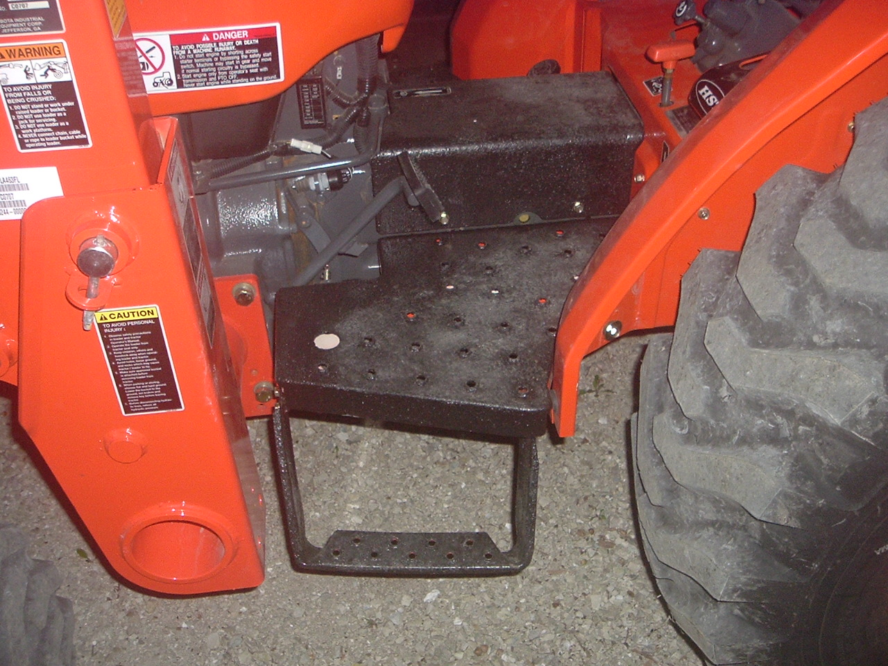

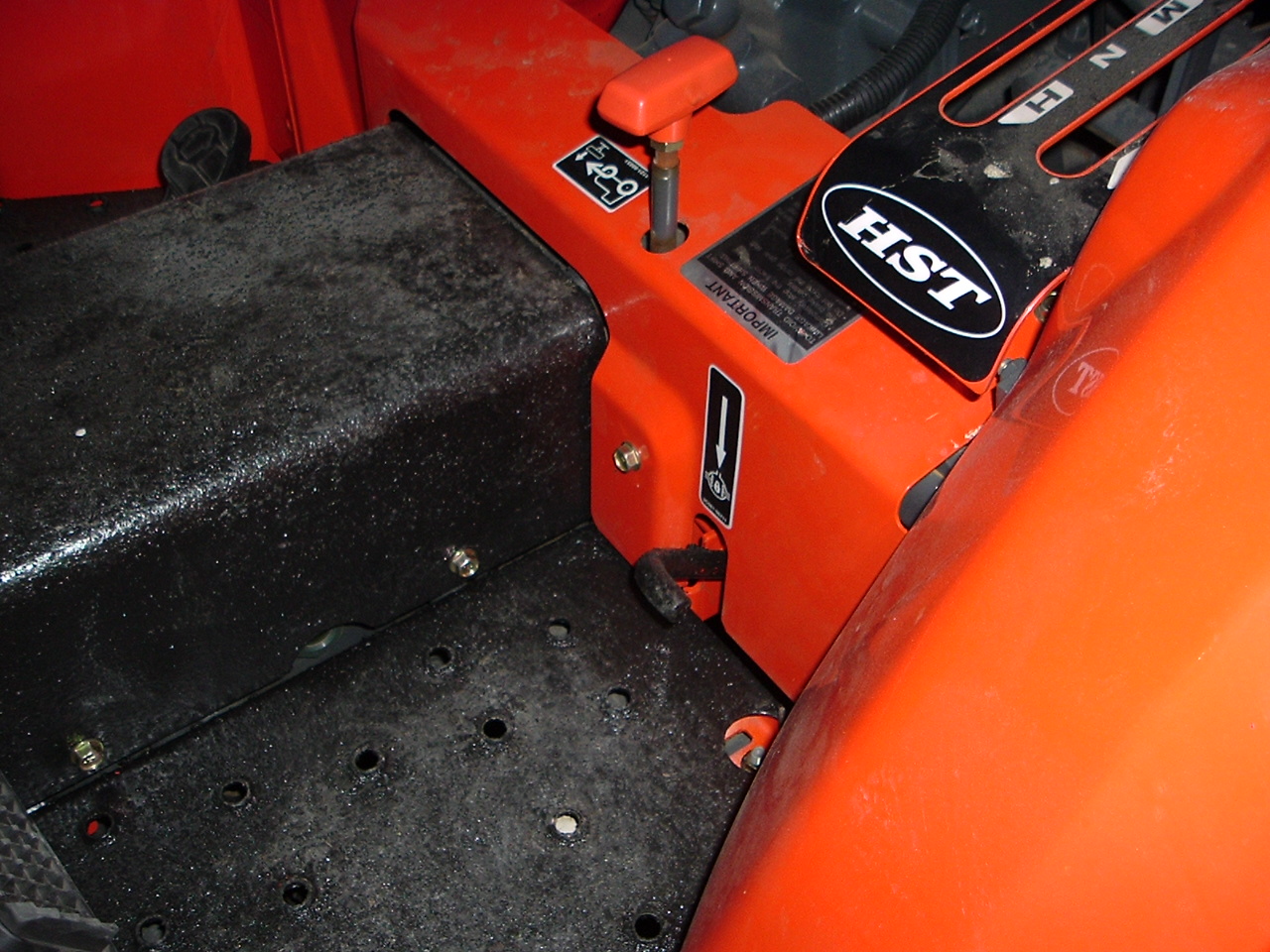

Really diggin the new L2501. Did notice last week after getting my boots wet the painted platform was a bid slippery. Thought about getting a rubber mat (my last compact tractor came w one) but decided to go this route. I used Rustolium brand. Has a nice texture for grip. Took the center hump cover off also and gave it a couple of coats. It already had a nice scuff on the orange paint from my boot w only 7 hours on it. I'm happy with the way it came out.

Very nice! :thumbsup:
A long time ago I worked at an airport and we had all kinds of support equipment with steps. We'd get a quart can of black rustoleum, pour some in a coffee can, and add a couple handfulls of sand. Stir it up and slap it on. Worked well. But didn't look as nice as what you did, that's for sure.

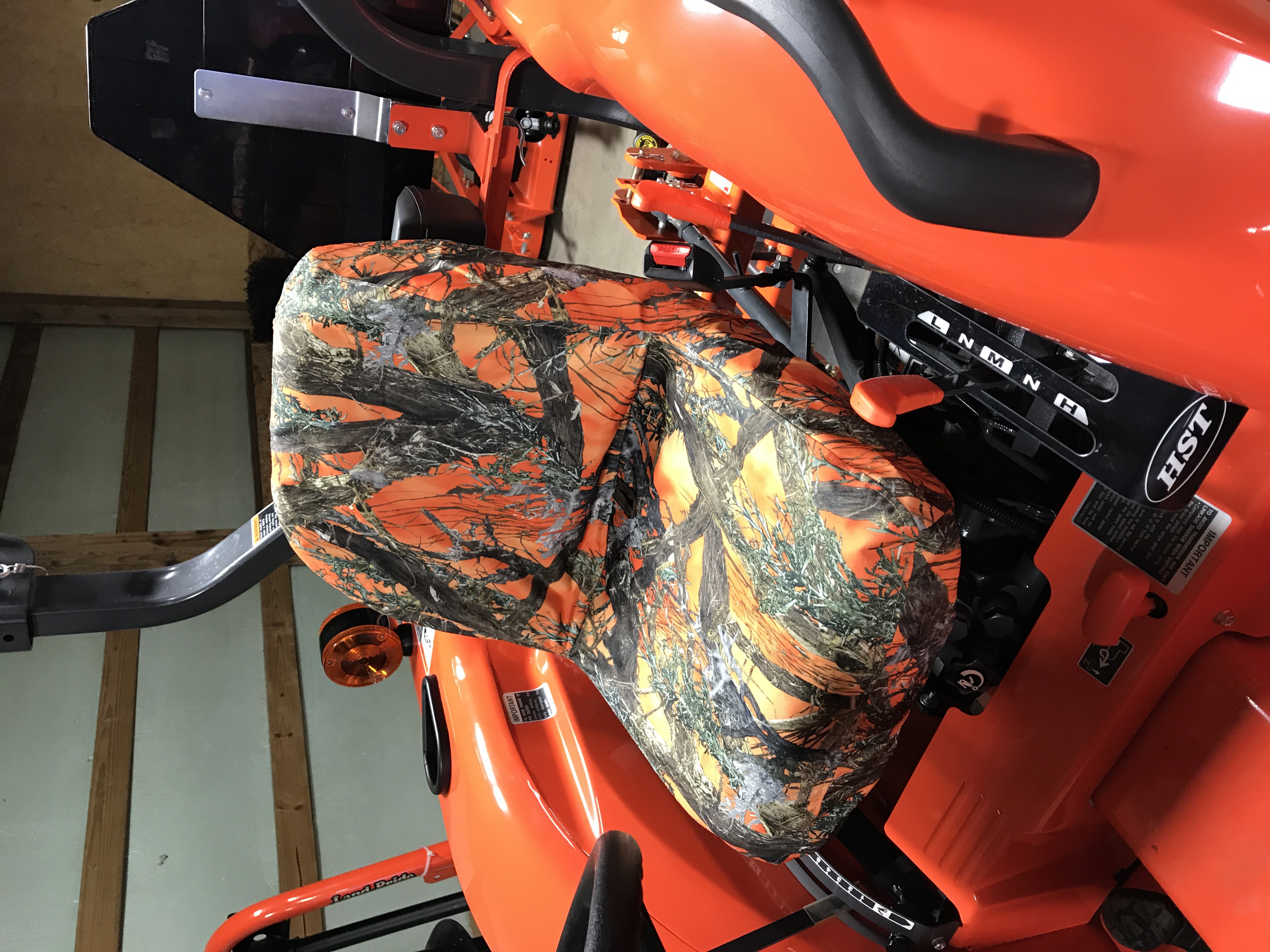

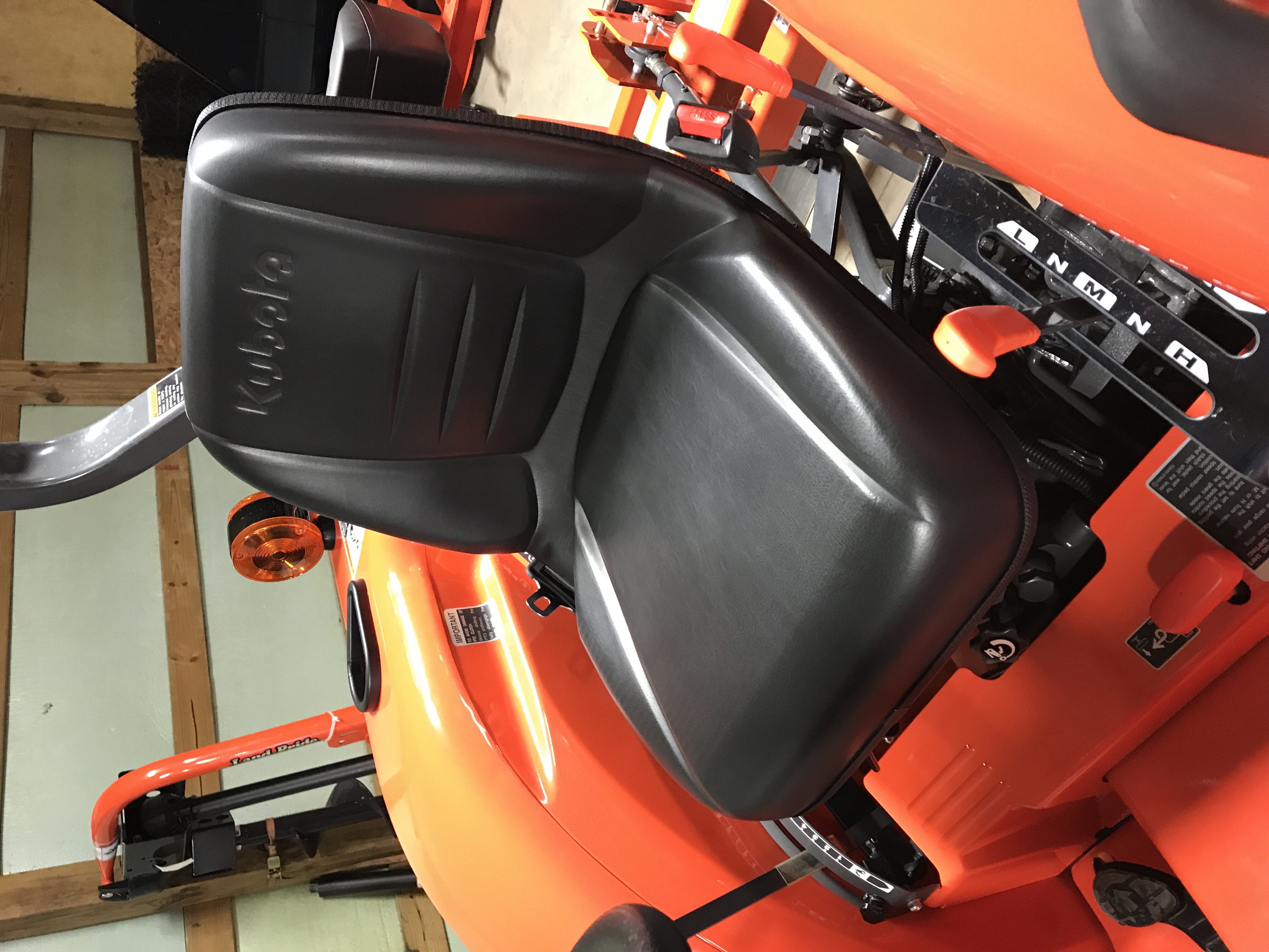

Great job. Where did you get your nice looking seat cover?
My wife got it for me. It's made by Durafit. Not sure where she got it but blaze orange camo goes great w Kubota orange.

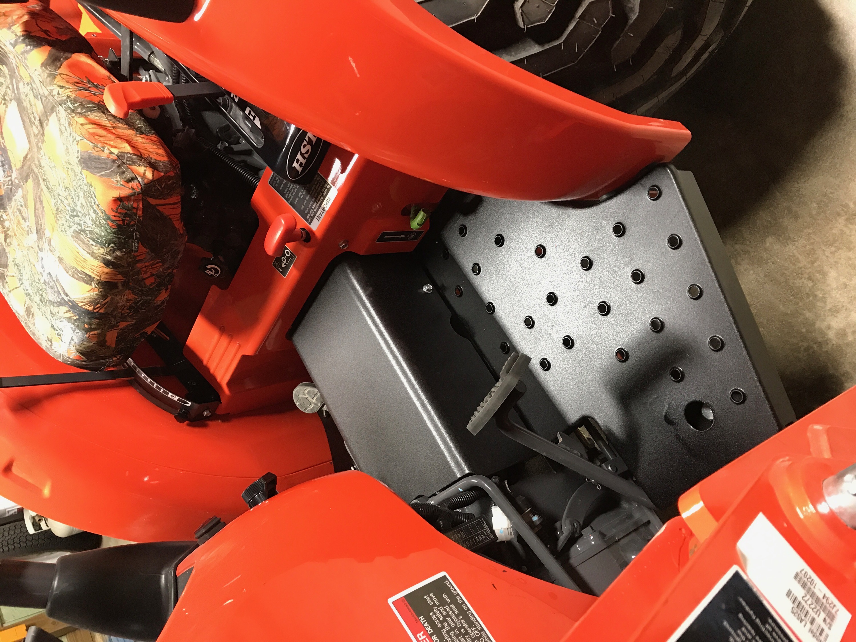

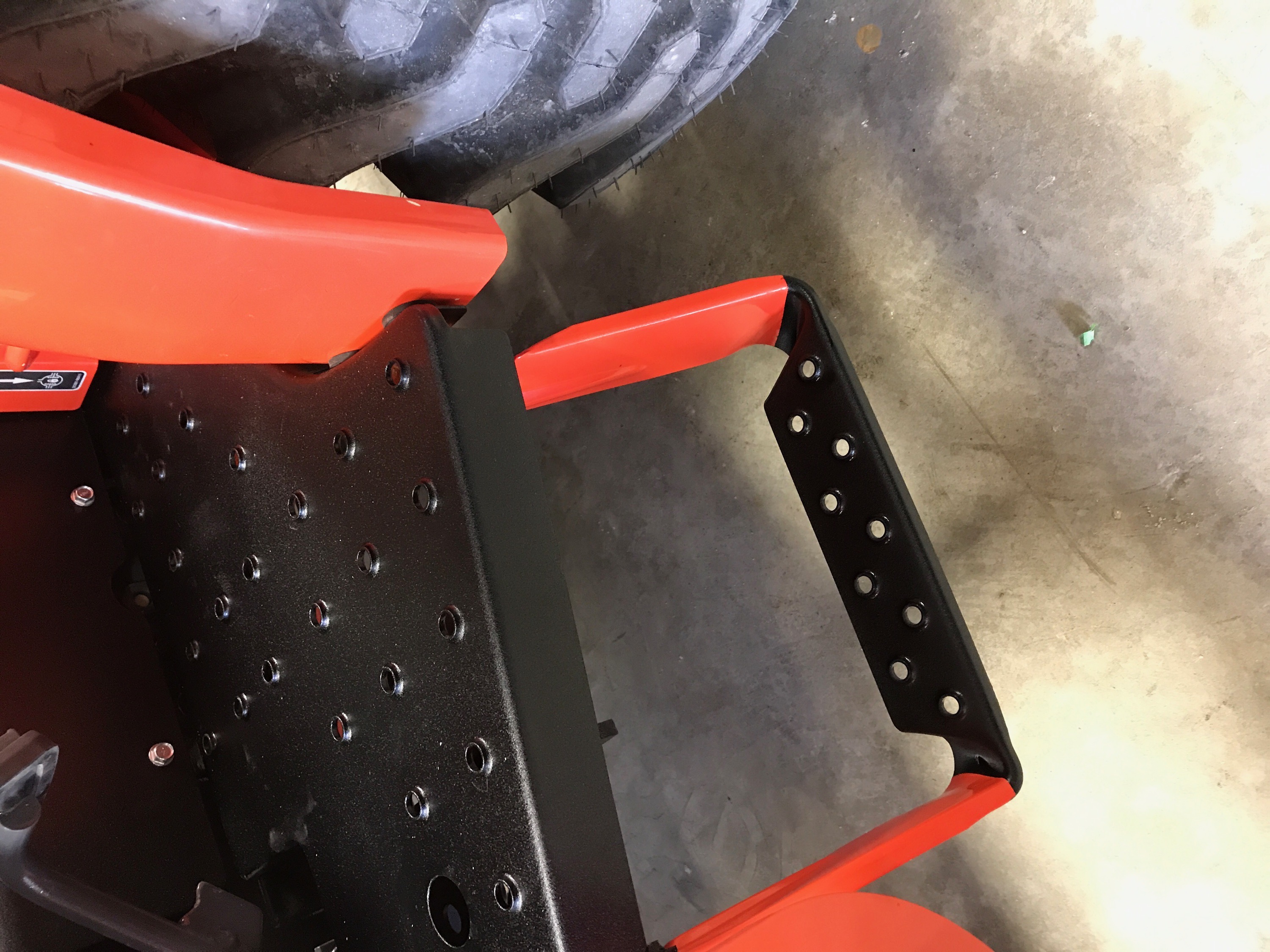

I'm doing the same this year! My L2501 looks horrible with all the paint rubbed off the steps and platform and I don't even have 100 hours!
I really want that seat cover and I see them on amazon all the time but the ordering is confusing about plastic or metal seats.

I would suggest using Herculiner, as mentioned in an earlier post.
It ia very heavy duty bed liner, brush on product.
Much more durable that the spray on types.
Available at Lowe's in quarts.

That's what it looks like now? After how many hours?
Can't tell you that Luke. I used it for a few hundred hours with no wear problems at all. But I traded off the tractor and now am a Kioti guy. It has a thick Mat on the floor. But the steps could use a coating as the left one has a lot of the paint worn off.
