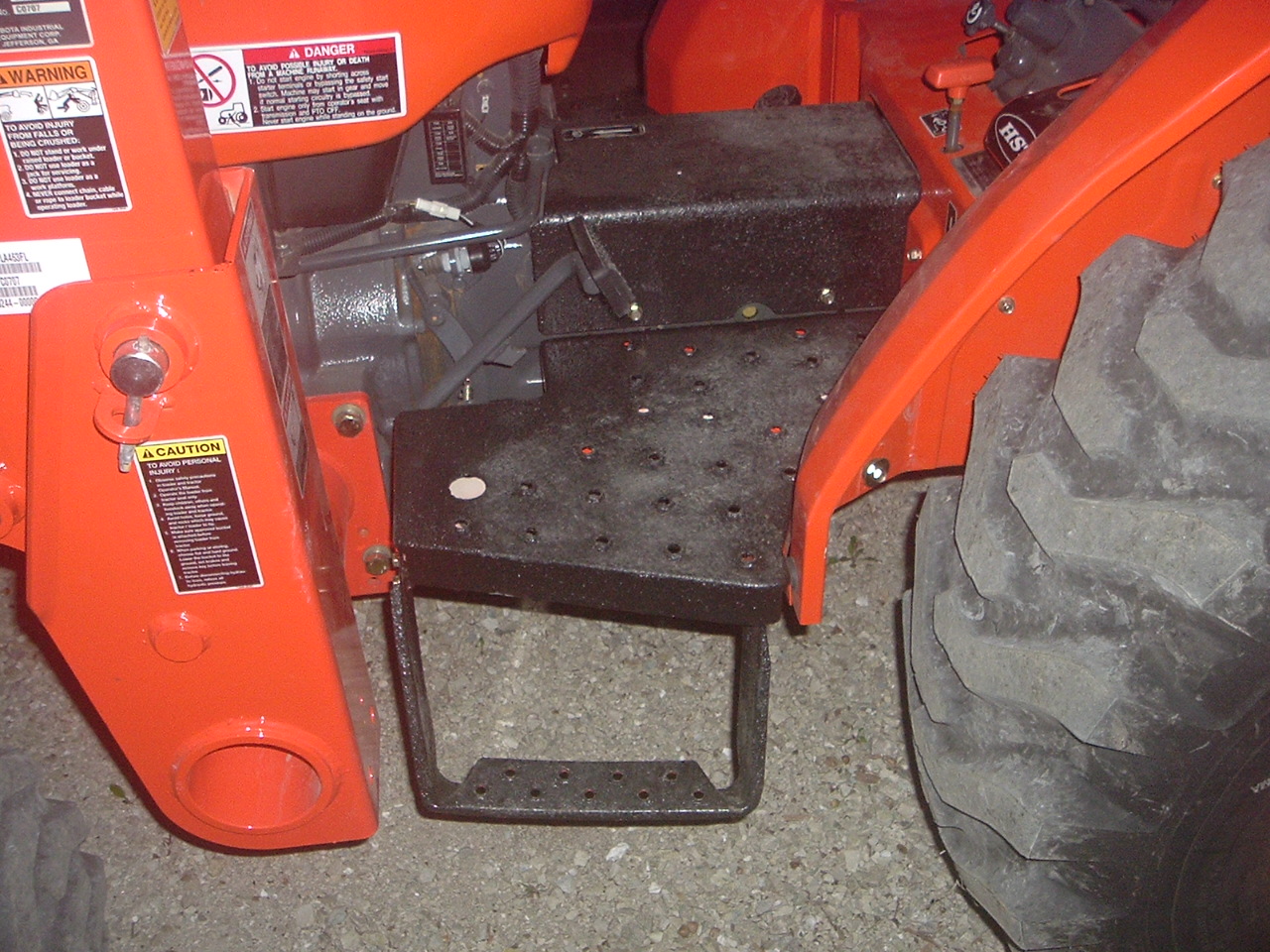

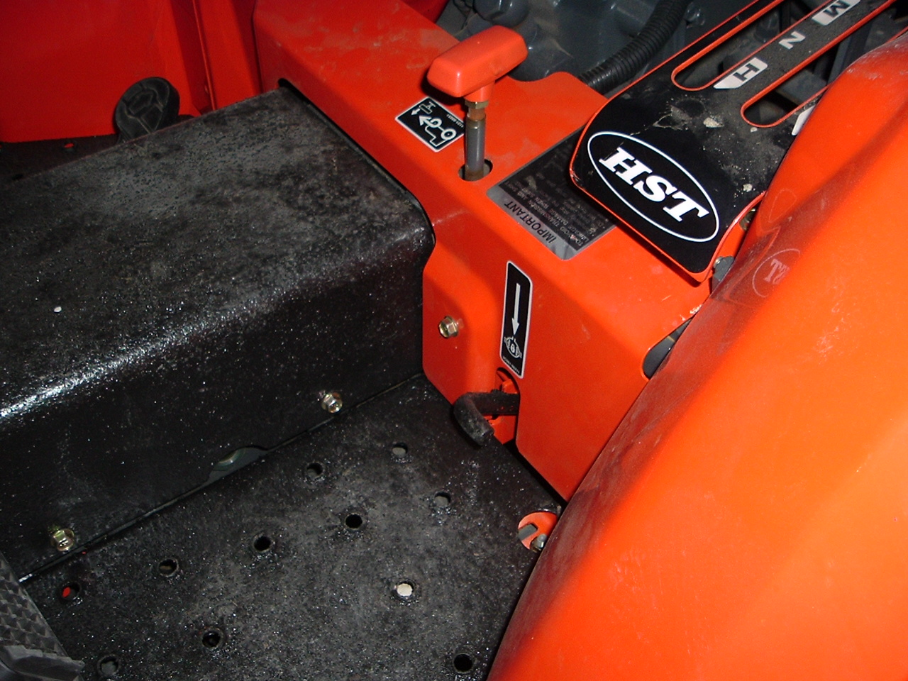

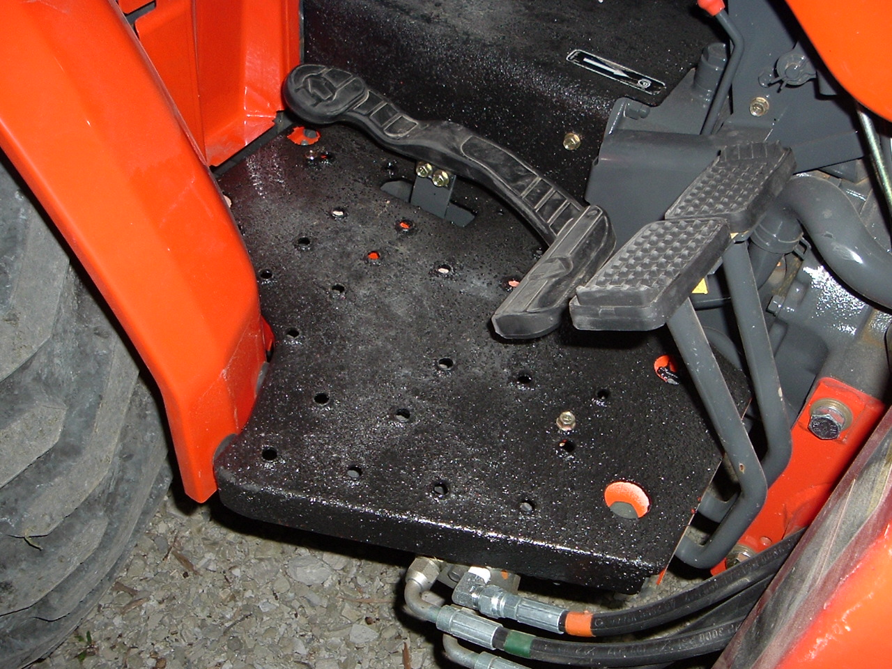

Spray bedliner on the platform and step.
   / Spray bedliner on the platform and step. #12
I'm doing the same this year! My L2501 looks horrible with all the paint rubbed off the steps and platform and I don't even have 100 hours!
I really want that seat cover and I see them on amazon all the time but the ordering is confusing about plastic or metal seats.
   / Spray bedliner on the platform and step. #13
Another use for bed liner (or gravel guard) would be to coat the underside of fenders to deter the 'sand blasting' effect from flying mud sand and other gritty materials.
Did that with a leftover can of gravel guard I had and my CUT fender undersides are rust free, even with a lose chain link that occasionally makes contact.
#15
That's a good idea. 👍
   / Spray bedliner on the platform and step. #16
   / Spray bedliner on the platform and step. #17
I would suggest using Herculiner, as mentioned in an earlier post.
It ia very heavy duty bed liner, brush on product.
Much more durable that the spray on types.
Available at Lowe's in quarts.
   / Spray bedliner on the platform and step. #18
That's what it looks like now? After how many hours?
Can't tell you that Luke. I used it for a few hundred hours with no wear problems at all. But I traded off the tractor and now am a Kioti guy. It has a thick Mat on the floor. But the steps could use a coating as the left one has a lot of the paint worn off.
   / Spray bedliner on the platform and step. #19
Walked all over Lowes paint section looking for Herculiner, finally found it several isles away next to the truck bed boxes.
   / Spray bedliner on the platform and step. #20
Thanks fried!
