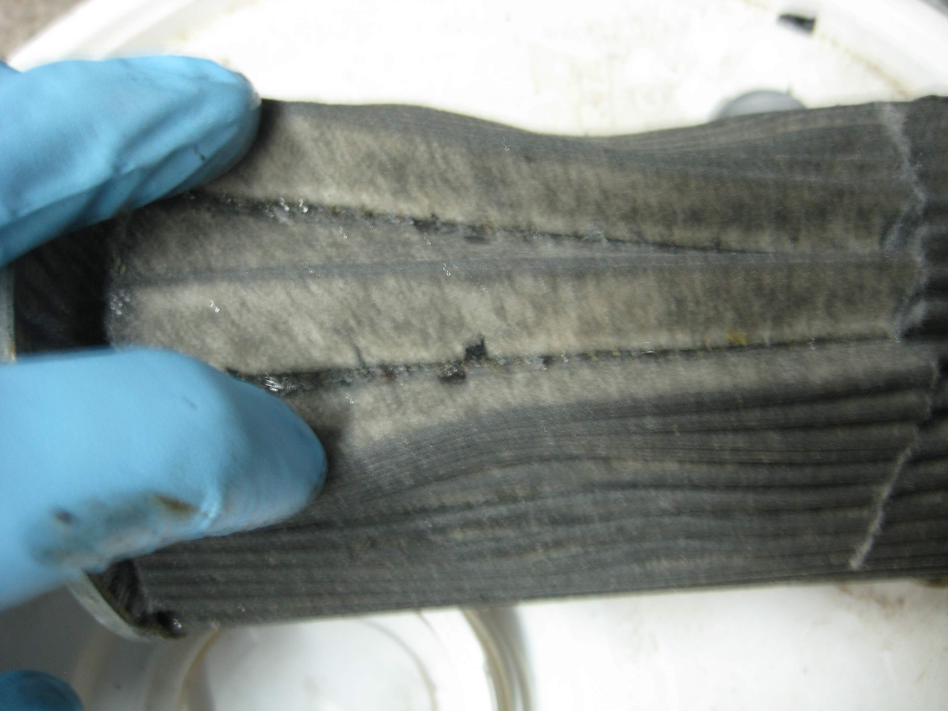

L48 TLB: 678 hour filters - horror or not?
Short version: Kubota makes (or specifies) some FINE filters!
After completing a bunch of other routine maintenance on the F3680, I turned my attention to the L48. This was also acquired relatively recently, and the owner dutifully bought pretty well every replacement filter for the machine when it was purchased. I had seen the two overflowing boxes full of Kubota filters in the tractor's bay and below them 3 or 4 5-gallon pails of Super UDT and a smattering of other Kubota brand oil; surely this tractor was being pampered, right? Best intentions I guess :laughing:
At this point I was working solo and going over the usual routine maintenance, along with an oil change and fluid checks. Pretty well everything looks okay, but when it came to checking the transmission/hydraulic oil, it's actually fairly low. I grabbed a half (or so) full pail of SUDT and start topping it up. Once I had dumped a couple gallons in and still wasn't full I figured there must be a leak. Crawling around I see some oil and trace it back to a grey filter. What's this? Checking the manual, I realize it's the HST filter, but how come it's grey? Also, one of the hydraulic filters has two large dents in it. There's even a bit of rust visible where the dent on the filter caused the paint to crack. This ISN'T a recent occurrence. Both hydraulic filters were also grey. Could these be the original filters? You bet!
Bewildered, I run over the the tractor's home bay and look at the filters. Sure enough there are two sets of everything boxed, plastic wrapped and NOT ON THE TRACTOR! To be fair to the owner, very few hours have been put on the machine. The neglect falls mainly on the previous owner. I don't have all the background info and frankly don't care, but that's not cool either way! What about all the pails of UDT you say? The owner said it's had a very slow leak and that it's always topped up. I guess he was planning on changing it at some point :roll eyes:.
:mad: IF YOU HAVE A LEAK, FIND IT. I've had old cars with leaky rear main seals, and even newer Subaru's with slow external head gasket leaks (i.e. leaking outside and not to coolant). Nothing wrong with a very slow leak you know about and can monitor, but blindly dumping fluid it is a bad idea. Particularly here because said oil leak was just a filter that was slightly loose; a filter apparently destined to be neglected and apparantly crying for attention :confused2:.
So between the owner topping up for leaks and my recent top-up, we've pretty well changed the 51 litres of SUDT on the tractor already. Here I am with this thing sitting almost full of nearly new oil with these nasty old filters. I decided to swap in new filters (without changing oil yet or running the machine really, just to 'plug the holes' really) and then dissect the filters to see what we're dealing with. Unfortunately I didn't document the whole process. I guess I was too curious!

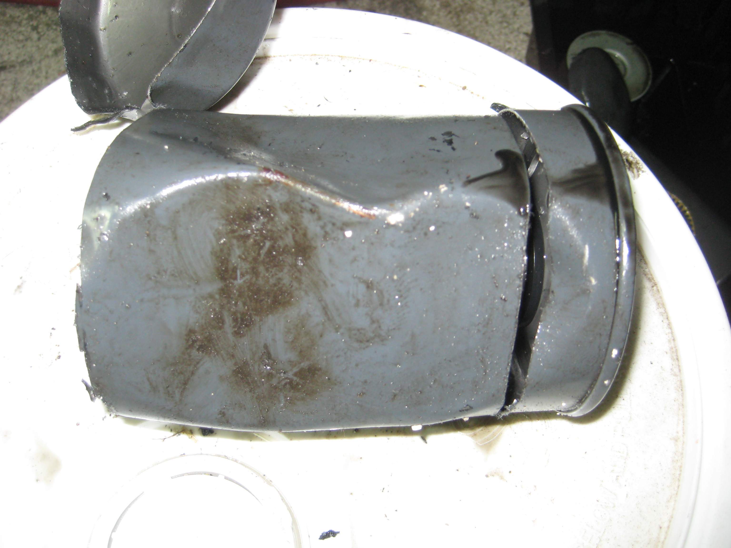

Now anyone that has done a 50 hour service will remember the factory grey filters. But some may also remember that Kubota at one time had some grey replacement filters. I don't think that these are replacement filters, but I'd be delighted to be proven wrong! Any takers?

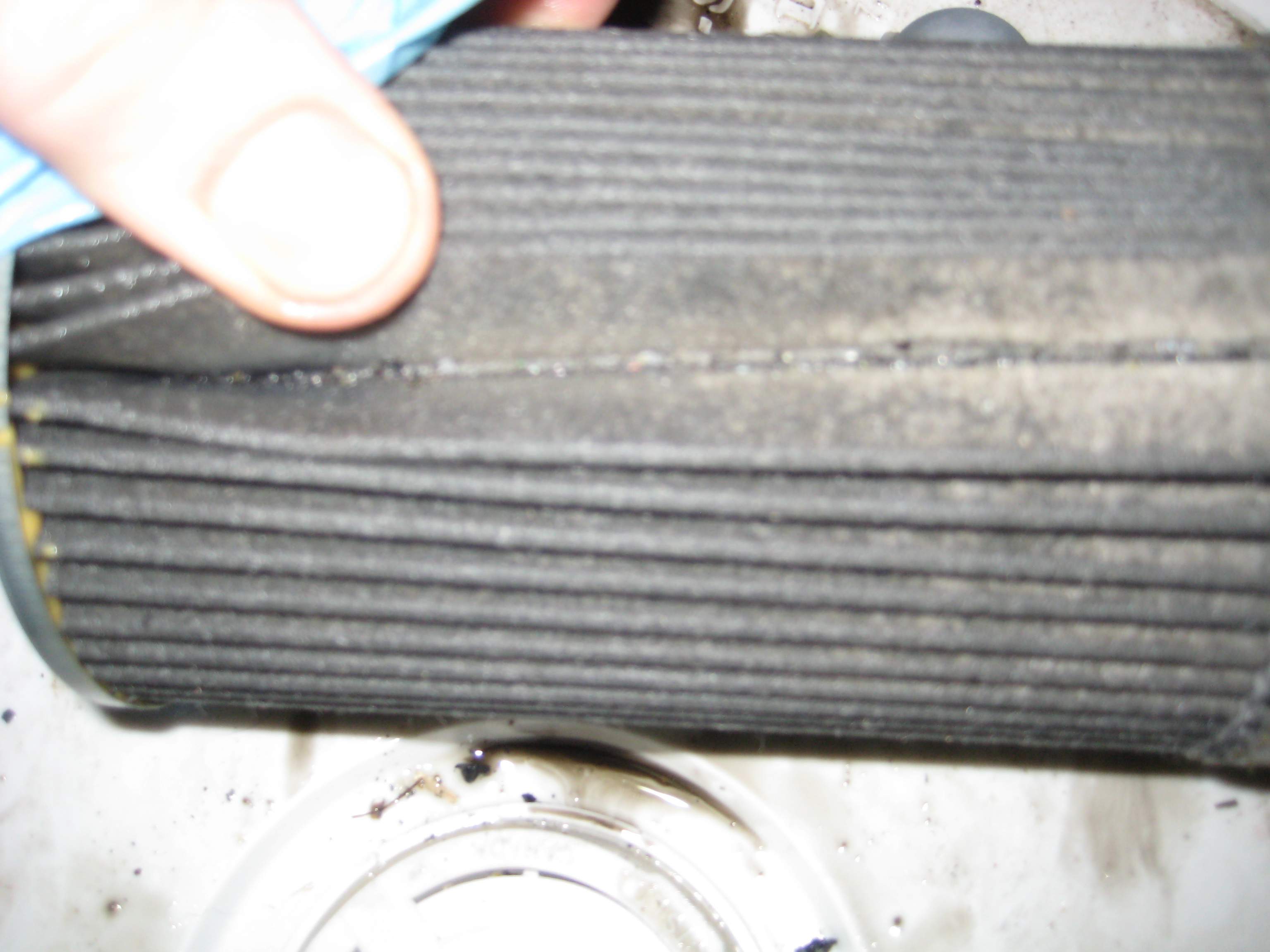

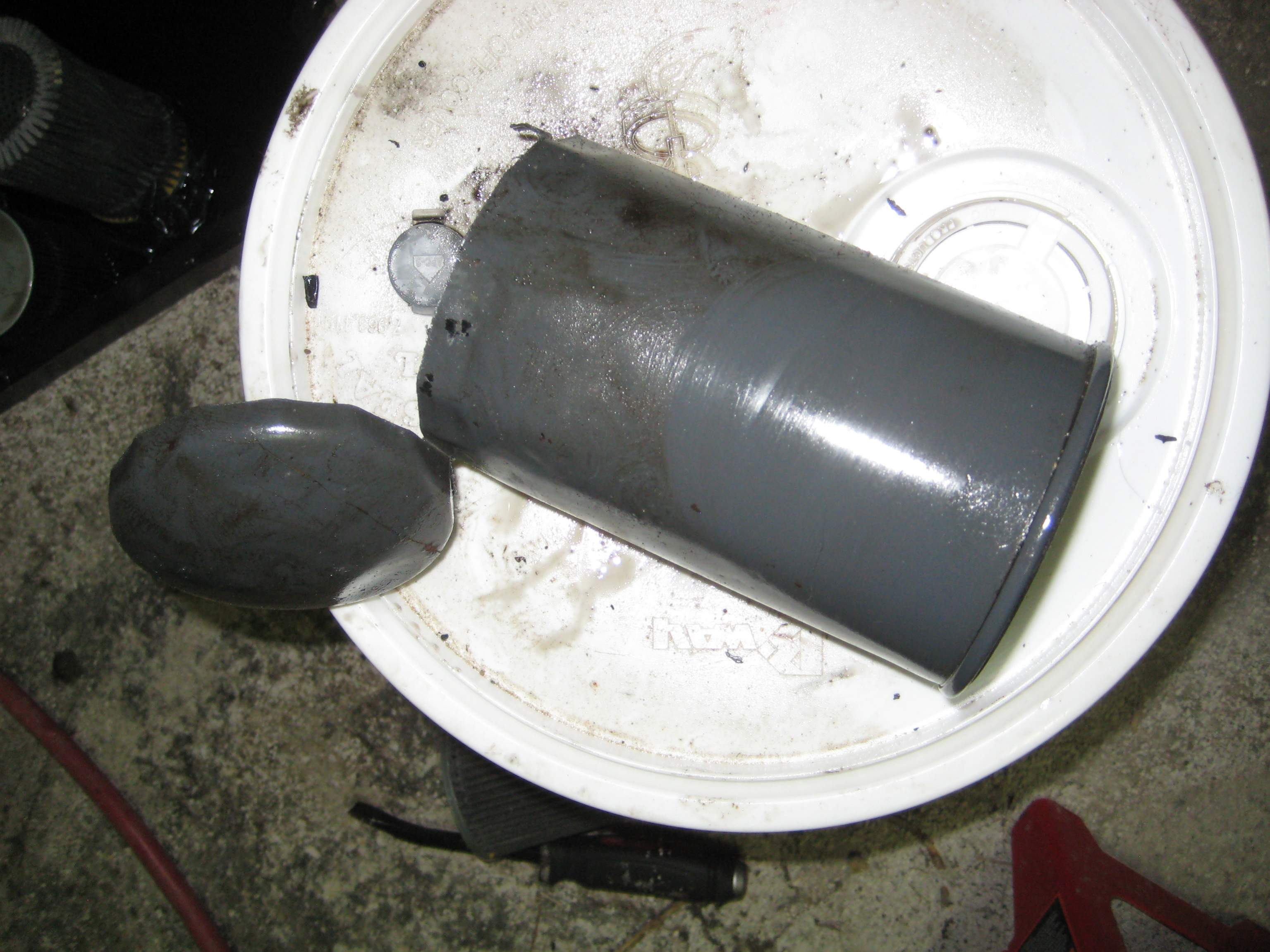

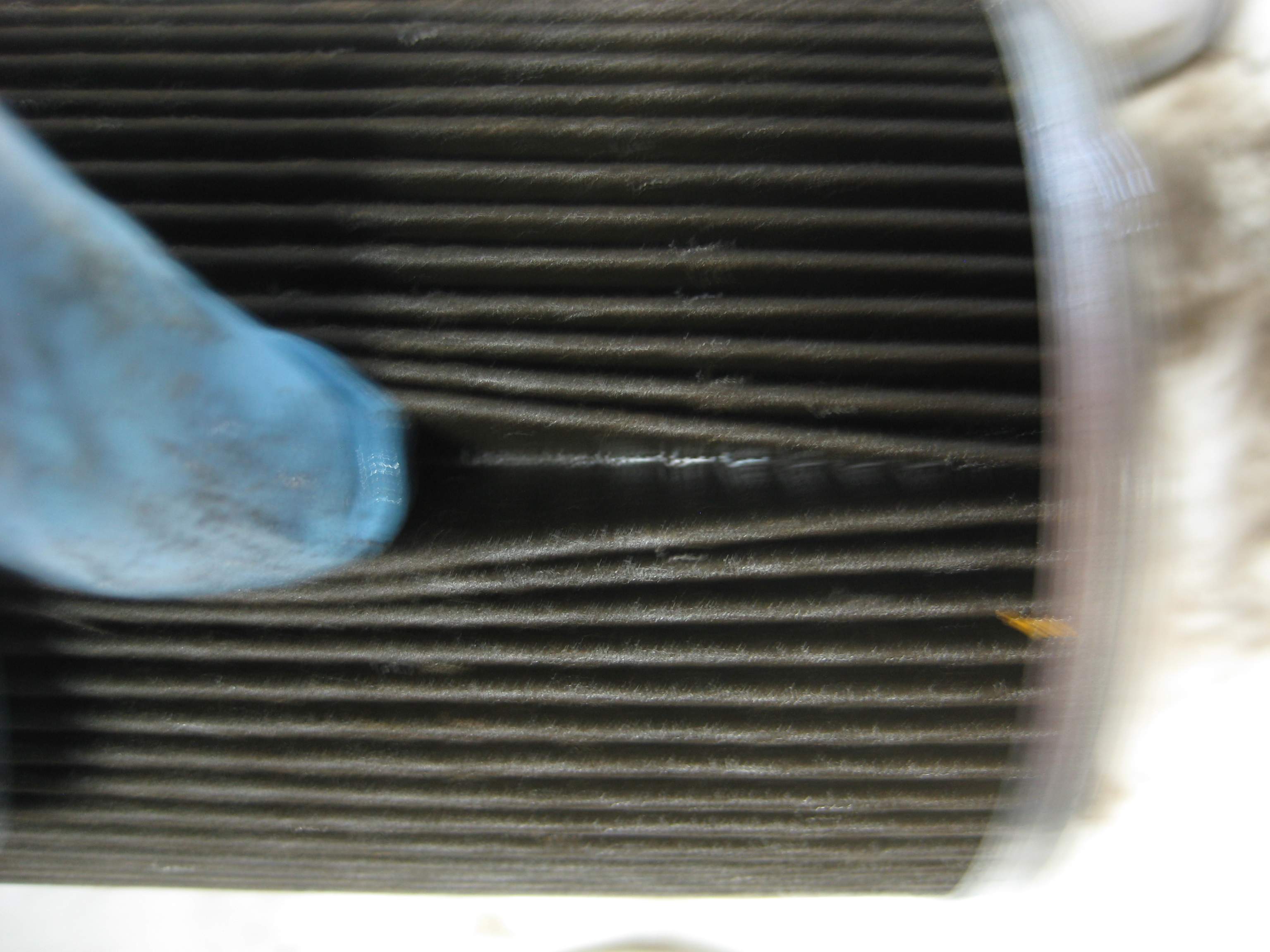

Starting with the dented filter, note that it was not actually dented this badly and got much worse as I fought it to cut open. I cut the HST filter first with a hack saw, but it was a really PITA being so thick, yet at the same time not thick enough to withstand adequate pressure from the vise and therefore slipping around constantly. I got lazy on the second one, but the dents made it too sketchy to cut with a hack saw on the lathe and the safest feeling tool was a cut-off-stand-mounted portable bandsaw. Some cursing, an aborted first cut and decent sized pry bar later, I had it apart! Of course ignore the cuts/damage that are obviously from the bandsaw.

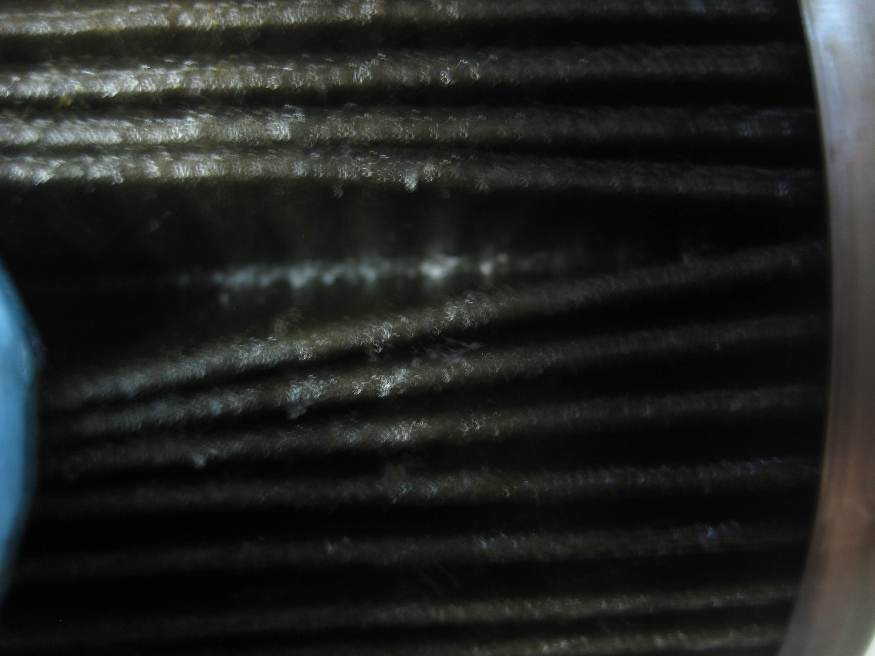

Surprisingly good looking, right? This is the worst of the three. Even the dents didn't really do much harm! For each filter I've tried to grab an average pic and a 'worst' pic, showing as much crap as possible. Beyond that, inside the filter housing was one little chunk of solidified RTV, but nothing else to note. On to the second hydraulic filter, it's much the same, though this one had a sliver of plastic in addition to another small chunk of RTV.

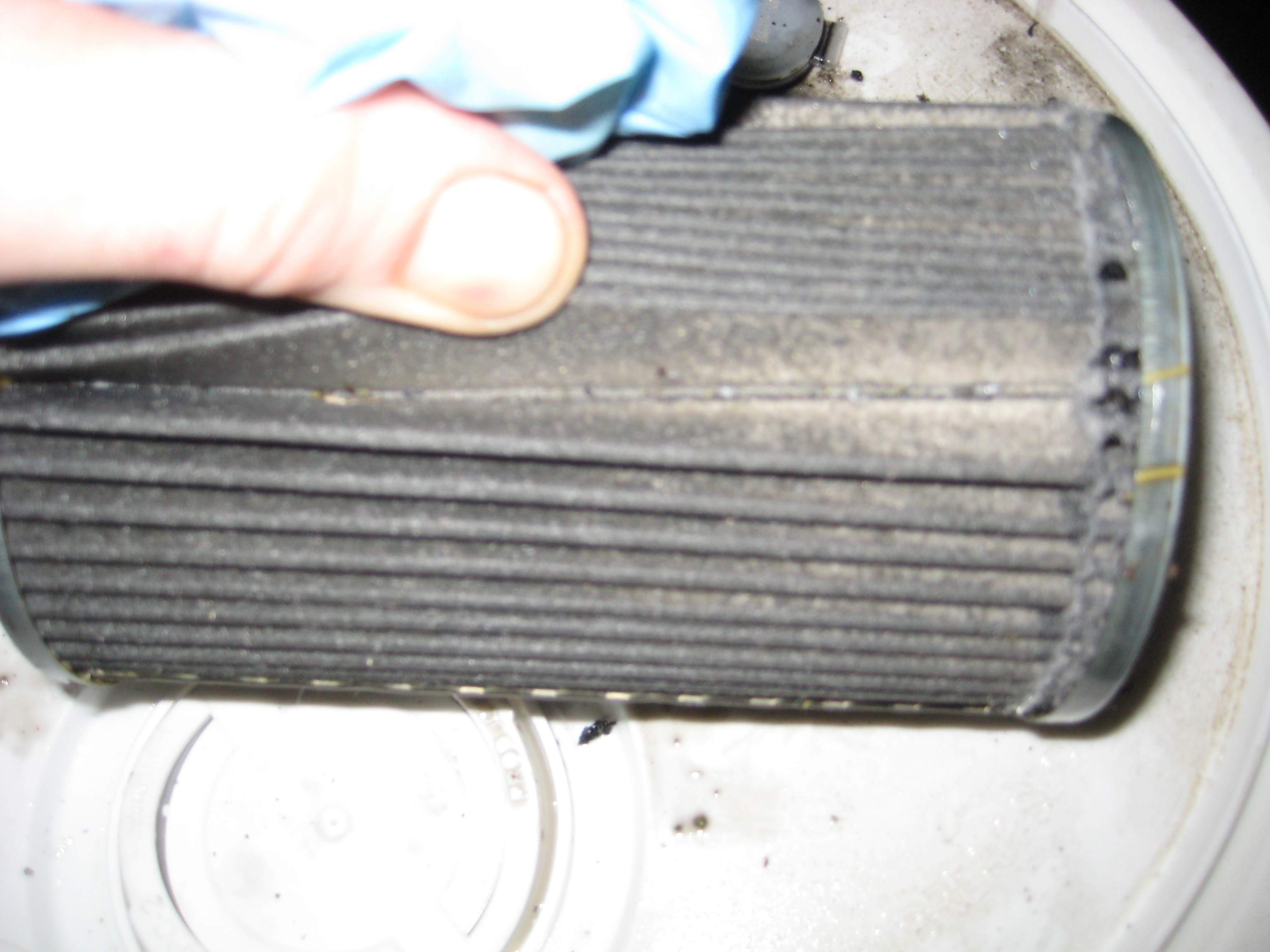

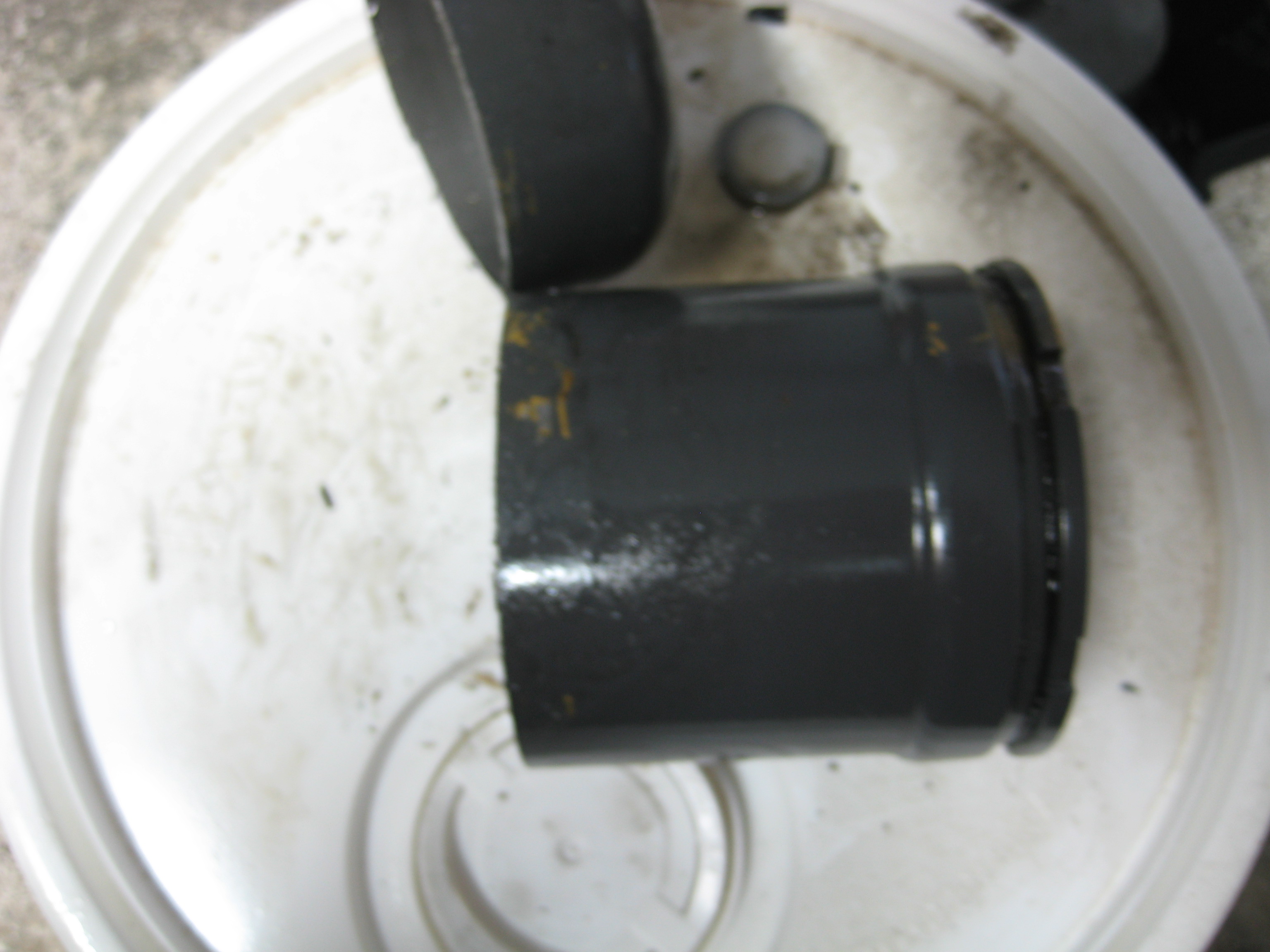

Moving on to the HST filter, it too was remarkably clean. Is it normal that it doesn't have the magnet sometimes found on the factory filter? Could this be an indication that something else is going on?
I took some videos as well, but I think I'm going to try to take a single video with a little tripod or something because it's not a clear as it could be.
Overall, I've got to say I'm impressed with the Kubota filters. I've seen some pretty mangled oil filters on vehicles where you replace the filter element only. I've never cut one apart before so I don't have a lot else to compare with though. The most reassuring thing is that even if the metal fragments aren't a great sign, the filter media was all completely intact without any signs of degrading at all.
Before someone suggests it, I've already replaced everything else on the tractor (coolant, 8 litres of gear oil into the front diff!, fuel/air filters, etc.). The fuel and air filters were very almost spotless so I really had to convince myself not to reuse them assuming they were also not serviced. The only thing I haven't done is the transmission strainer. At first this was because it was an absolute pain to break loose. For one, it's a 26mm bolt covered in paint. I have way more tools than just about everyone I know, but the location of this was such that only a wrench would fit, not a socket. I don't have a 26mm wrench! I was able to get a couple cheaper (read looser) 1" wrenches on nice and tight, but couldn't quite get enough leverage with a standard combination wrench with too much offset. In other words, having a standard 26mm combination wrench wouldn't have worked! (the tool guy in me still think the experience justifies buying one now...:thumbsup:)
After digging through old tools I found a nice old rusted split/closed wrench that had the 15/16 end broken off and the perfect offset. I had to hammer it on to knock of the paint and 'pair' the two together. I got the tractor up a few feet in the air with the hydraulics and supported underneath with some 12 ton jack stands. Then I leaned into it with a three foot cheater bar that fit perfectly onto the broken end of the wrench. Once it gave I was absolutely sure it was the wrench and not the strainer that had broken free... until it started pissing oil on my arm (pan was ready)! I tightened it back to stop the draining and that's where I'm at now.
So, how to proceed? As a starting point I was thinking draining the fluid (as much as it pains me) and cleaning the strainer followed by new fluid. The machine's earned it, right? Anything else you think I should be addressing while the fluid is out?

Using any kind of saw will put metal particles into the entire mess, you want to keep the bits of filter out of the inside so it does not give you false info.

Interesting. As I tool 'guy' I instinctively believe there is a tool for everything, but never would have guessed one for cutting open oil filters existed! I think I could mount a spare blade from a copper pipe cutter onto the lathe tool post without much trouble for similar effect. I thought about using an exhaust pipe cutting tool but I couldn't find mine at the time, and I think it would have been too small anyways. I'm not even sure that tool from Summit would have made it through the HST filter either - it's probably 3 or 4 times thicker than your regular vehicle oil filter. Pricey little guys but evidently worth every penny!
I wasn't too worried about the particles from cutting because I was mostly trying to see if the filters were a complete disaster or not. Filings are to be expected at the first oil change interval so it's hard to read much into them either way in the present circumstances...
