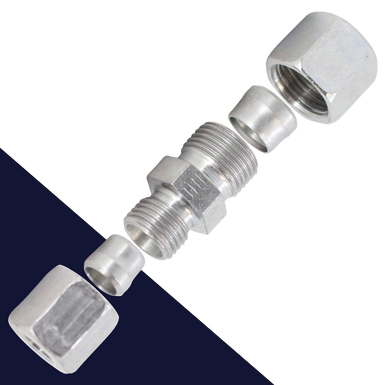

I have repaired many rusted out steel hydraulic lines by cleaning up the surface and brazing over the affected areas. It's worked for me many times and solved problems for years. If yours is a 12mm line (a common size with Kubota) I've also done sectional replacement type repairs with new tubing and compression tube unions. If there's room for them, they work quite well, even on high pressure lines. I doubt a cooler circuit is all that high in pressure. You could cut the tube into manageable pieces, repair or replace the damaged section, and re assemble it in place with unions.
Something like this.
Replacing some or all of it with a hose is another option, but this might be simpler.

I have used the compression tube unions a number of times. I also keep old bent or damaged lines to use for similar repairs for that very reason. All too often steel lines can be a royal pain to get out and put replacements back in on many Kubota models. A short section of like sized tubing and a couple unions can make a two or three day project into a one or two hour job. The end result can be just as good.

Thanks for generous and wise advice. I will cut the pipe in three pieces and let the local hydraul store make the bends and reconnect with compression tube unions. It is a true relief to give up the 3D puzzle that has been going on for several hours now challeging my mental capacity.
Greetings
Lars
