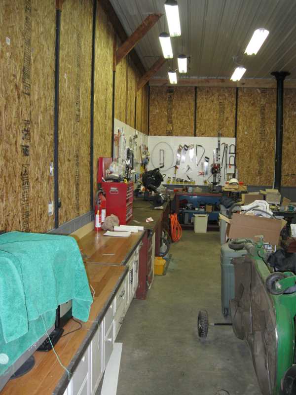

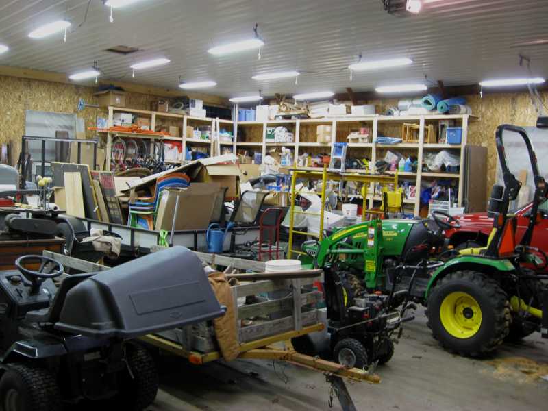

Here are a couple of shots of my lights. It shows the extra lights over the bench. I couldn't put lights over my tall door because there's not enough clearance between the door and the ceiling. I didn't bother installing lights over the other one because I didn't expect to be working there, but I can add them later if I want. I ran wiring above the ceiling to a grid of outlet boxes. If I was doing it over, I would run conduit under the ceiling. All my lights are T-8 plug ins from Menards on sale.
View attachment 298133 View attachment 298132

I've got 5 or 6 lights, depending on the row. I offset the lights so each row is staggered from the adjacent rows. I have an average of almost 1 watt of lighting per square foot and, with the additional lights over the bench, I've got closer to 2 watts/ft2 on the benches. I think the white ceiling helps. The unfinished OSB probably isn't optimum, but I will have white pegboard on the walls in the areas I work in most.
