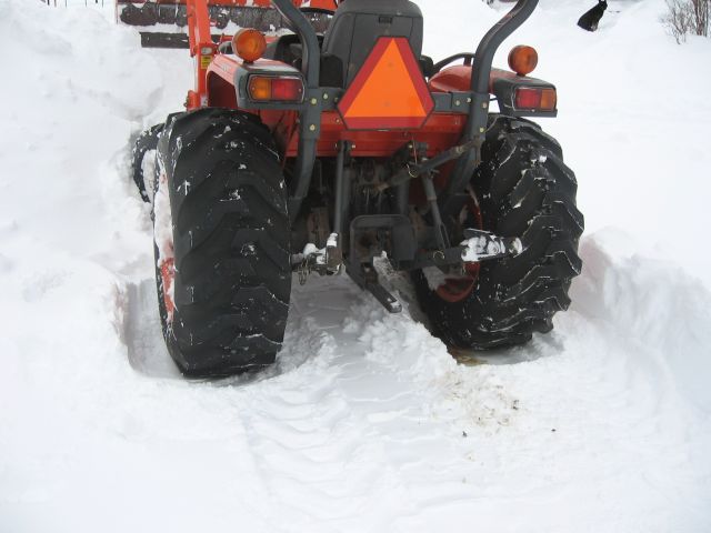

He may very well be correct, but you should be able to get it out with the bucket, even without putting it in gear. I guess it's possible the back end is bottoming out.
Not necessarily...
You need a fairly solid surface for the bucket to curl against...doesn't look like he's got a solid surface to work with. Also, if those rear tires (or tire) is dig in deep, it might be too much for the loader curl function.
Like buckeyefarmer, I got my 790 stuck on fairly level ground. I had to dig behind both front and rear right tires to get the tractor moving again...even using the loader to help push.
   / Sometimes it all doesn't work out! #23
Not necessarily...
I don't know about the middle of the winter in Connecticut, but I know when the ground freezes down here, it is more than fairly solid.
I do understand what it takes to do this, I have do it all the time. My smaller tractor, with low ground clearance, is very susceptible to getting stuck when I leave the drive, to push piles of snow, or drifts.
In the photo, the snow in front of the tractor appears to not be disturbed. If one were trying to use the fel to push the tractor out, you would expect to see at least a depression of packed snow from doing so. That's why I asked.

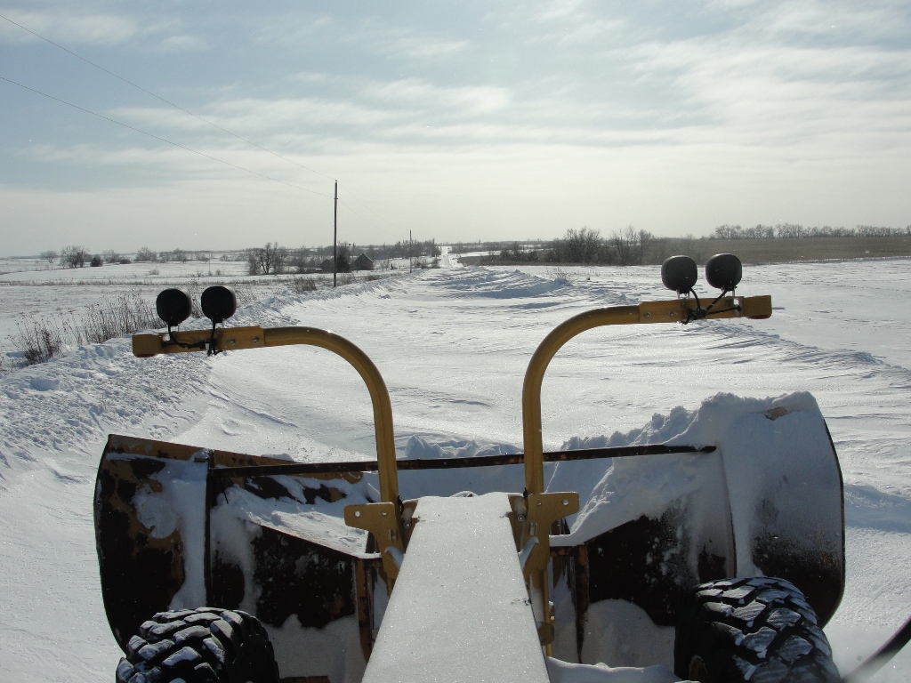

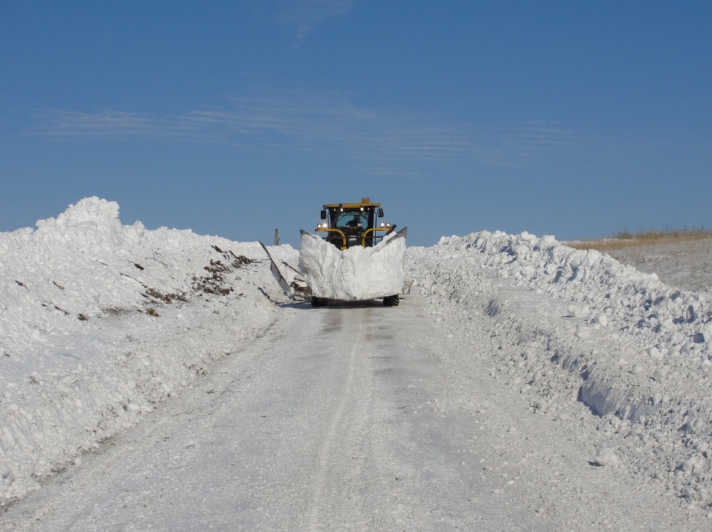

I run a grader on rural gravel roads. Every big snow I will find myself on the verge of getting stuck. I usually push at night and will lose track of where exactly the roadbed stops and the ditch starts. Last time I pushed my big "stuck" was that I backed into an unfrozen gateway and found myself sitting crossways in the road, buried to the top of the rear tires with the moldboard jammed into the roadbed in the raised position. Worst possible situation for a grader. Took me twenty minutes to get myself out. I never spun my tires more than one revolution in the entire process. Patience, patience, patience.
Once in a situation I STOP AND DO NOTHING until I've analyzed every step of the extraction. :eek:
For example, okay, first I'm gonna get the blade curled and firmly stuck into the ground and ready to push, then I'm gonna set the direction of my front tires, then I'm gonna make sure I've got the diff locked and 4wd engaged. Then I'm gonna very carefully start reverse wheel movement in time with blade push with the goal being to not spin. If I start to spin while curling with no tractor movement I immediately stop!!!! Don't want to spin a hole. Now, I reanalyze and pick a different method. I continue this process until I'm out.
Sometimes I might choose two or three methods before I get one that works. NEVER, NEVER do I just throw it in reverse and watch the wheels spin!!! All that does is make things worse. There is absolutely nothing gained by spinning tires and no vehicle movement.
I've pushed snow for 21 years and never have been pulled/stuck. I've always got myself out. Been in situations where the snow was piled higher than the grader roof around me and couldn't see any of the drive tires, still got myself out. It takes a lot of patience and careful methodical thought with each action. Makes a difference when you're not 100 yards from the warm house too. I'm usually in situations where the nearest help is a mile or more away. I've never made tracks in the snow walking for help. Now I've jinxed myself and will get stuck the next snow!!! :)

Anyway, when I got stuck last Saturday, I did push with the FEL (lots of experience doing that!!). But it's not going to help much until the rear tires are dug out (if they're buried). And, it took a while to get to that solid ground.
And, in the picture, it appears the ground slopes pretty severely in front of the tractor. His loader may be hitting the stops before the bucket is hitting solid ground.
One of the posts mentioned handling a tractor in crappy conditions is 60% operator. Yeah, I'd go with that...but learning to deal with being stuck and digging your way out is part of the learning curve. Ray has learned this, I've learned..and now ctgoldwing's son is learning.

just a follow up from the stuckee.. i'm the son with the stuck machines :)
both are free as a bird (or were as of yesterday). the bucket trick just dug some earth - the ground is still quite soft as we've had TONS of rain the last couple months. the ground also slopes sharply away, so even before i dug the hole, i was only able to bite an inch or so of earth at full extension. i did make things worse by locking the diff and letting that right rear tire dig a hole. eventually, some chains and ratchet straps were able to pretension the tractor enough so i could rock it backwards, retension, drive forward/left, retension, repeat 15 or so times. as the MN gentleman said, clearing the wheel tracks and the snow from under the low points of the chassis was the key for both vehicles.
lots of shoveling, some chains between the 3pt lift arms and the tow hooks on the front of the truck got it free.
while i'd disagree the dually sucks in the snow, it surely isn't great. the on-road tires certainly don't help. that said, it lives in my driveway to tow a ~15K lb trailer down the road. i don't pretend its an offroad vehicle. it does beautiful in that respect - quiet, comfortable, and reliable.
and now i'm watching another 10+ inches being blown around at 40mph...
