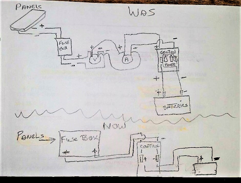

Looks like a loose connection at the voltmeter was the culprit. The "before" diagram shows the load being connected to run through the Stakons on the ends of the wires. Loose connection for a load = heat. What I don't understand is how that ammeter worked if it was connected as in the "before" diagram. It appears to have been connected in parallel with the batteries.
A voltmeter won't be damaged by connecting it in series with a voltage within its range. However, voltmeters are designed with a very high internal resistance, so the load won't get sufficient voltage to operate. An easy way to find a bad fuse is to connect a voltmeter across the fuse in a circuit that should be operating. If the meter reads source voltage, the fuse is blown.
/ SOLAR MELTDOWN......almost a FIRE!!!
#27
Thank you, Chim. The AMPMETER did NOT work....my bad, I guess I had it wired wrong. I had never installed a shunt and had it wired incorrectly. Bowhunter sent a you tube link to correct that mistake.
I am concerned about those "loose" connections on the Voltmeter though. I wired that up 5 years ago and it has been fine. The little posts on the cheap V-meter are just that....small...a small post with a small nut. I torqued them down as much as I dared and was worried that I would twist the post out of the plastic meter. What would you do....maybe "recheck" them every 6 months or so?:confused:

Make the connections on a terminal strip near by that is rated for the size of the wires, and run a pair of smaller jumper wires from there over to the meter, so that its connections are only for sensing the voltage.

Mr. Lyford, that is a great idea. Now, I'm always thinking of the "easiest" or least risk way of doing something sooo..... Instead of cutting the 10 GA red wire and putting it on a terminal strip with lugs etc.....What if I just ran a smaller 16GA wire back up to the fuse box where the HOT wire originates? Wouldn't that be the same result? If it's a bad idea please tell me, thanks:confused:

I would suggest wiring it as glyford suggested and use something like this for a terminal block.

If it were me, I would take the wires that are currently in two pieces to connect to the voltmeter and replace them with a single wire to go from point A to point B. Then add another pair of wires that is dedicated to the voltmeter.

I would take this one step further. I would wire the panels directly to the batteries (unless you really want the ammeter telling you how much current your panels are sending to the batteries) and then have a separate wire with a small fuse on the positive line going to the voltmeter. The less connections the better when transmitting power. With a fuse going to the voltmeter you are protected in case something shorts across the two terminals. You have 4 batteries that will produce hundreds of amps of power if something is shorted. I would also use electrical contact grease, like No-OX, on each connector.
Crazyal, sounds good BUT please clarify...panels directly to the CONTROLLER then the batteries.....right? And about this fuse....The big fuses I have off the panels are TWO, 20 ampers....should I use a 20A in line fuse to protect the Vmeter? I bought a 30V range V meter (and a 30 amp Amp meter) Thanks

AaronZ, the single wires to the V meter can be lighter gauge, right? And another fellow recommended an "inline" fuse going to the meter....that sounds like a good idea. Would have prevented the issue that I had. Thanks

Yes, the single wires to the meter can be a lighter gauge, and the size of the fuse in those wires should be whatever matches that size wire. It is there to protect those wires (and the meter)...unless the meter is rated for less, then it should be whatever matches the meter. I suspect something like 2A would be plenty...?
