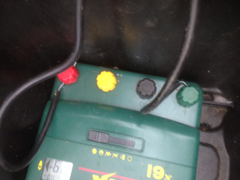

I have been asked a few questions about my solar fence charger set up after responding to another electric fence thread. I had good intentions of posting about the set up when I built it but never took the time. Here goes, pics to follow...

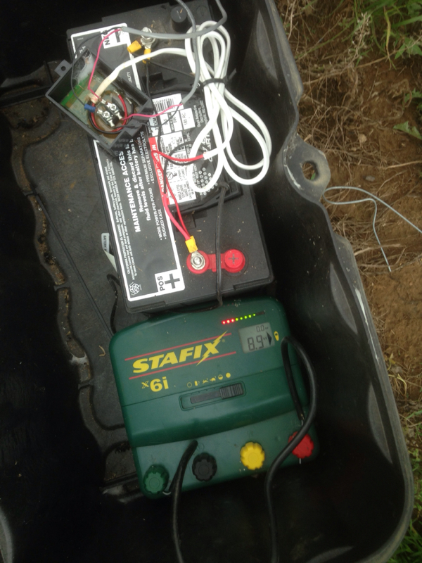

-- I started out with a Stafix x6i energizer with remote control, these run off of 12v DC. They come with two power cords, a 120v AC to 12v DC adapter and another with simple alligator clip ends to connect to a deep cycle battery. $650.00

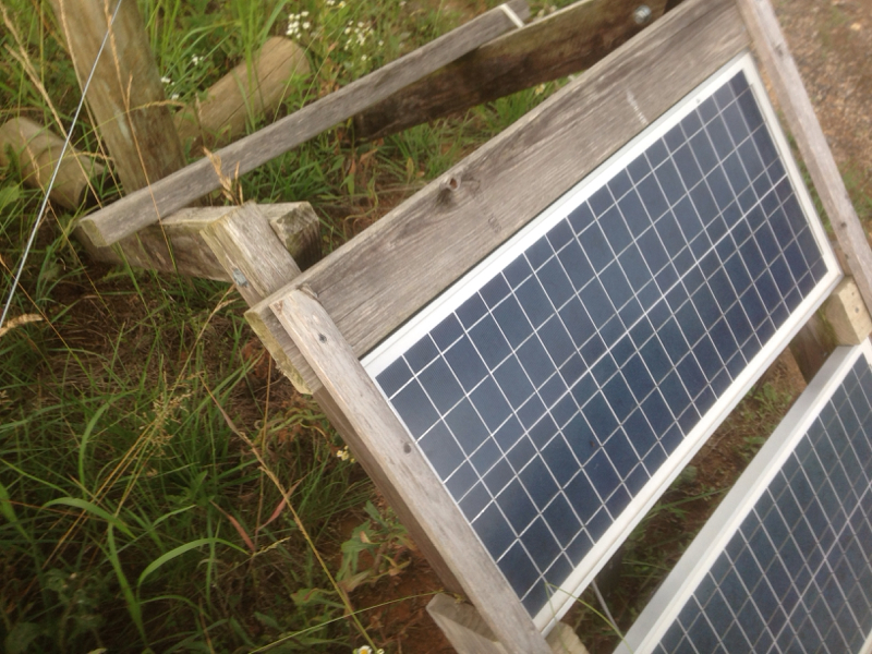

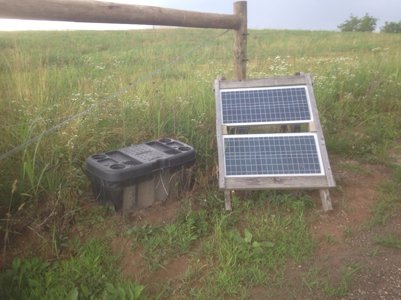

-- I believe Stafix called for a 60 watt solar panel but I decided on two 40 watt wired parallel. This was to make sure the charger didn't fizzle out before sun-up when it was cloudy during the day / long winters nights, ect.

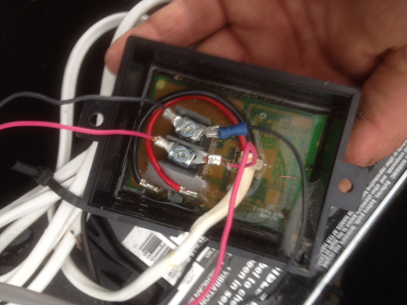

Included with my purchase was a weather resistant voltage regulator. These were also ordered from my local fence supplier but knowing what I know now they could be bought online for less.

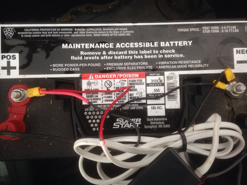

-- Next was a deep cycle battery from the auto parts store. The biggest one they had. $105.00 w/o a core return.

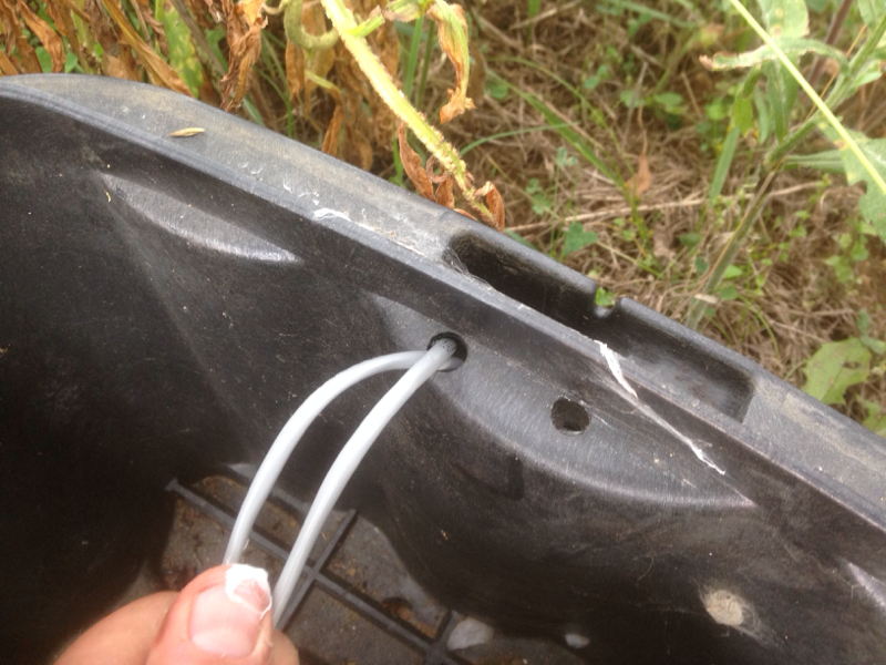

-- Then came a big plastic tool box from Home Depot to house the charger, controller and battery. $60.00
-- After the parts were together a quick and cheap A-frame to hold the panels was built from scrap 2x4's. It will fold up and fit in the bed of my RTV along with the plastic tool box. I did this because it was used as a portable set up for a while before the fencing was complete.

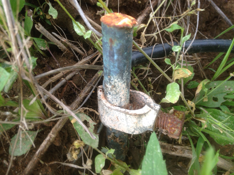

-- There are a total of 4 ground rods 6' apart. They are completely underground as is the wiring for them. (Well except for the first one.)
