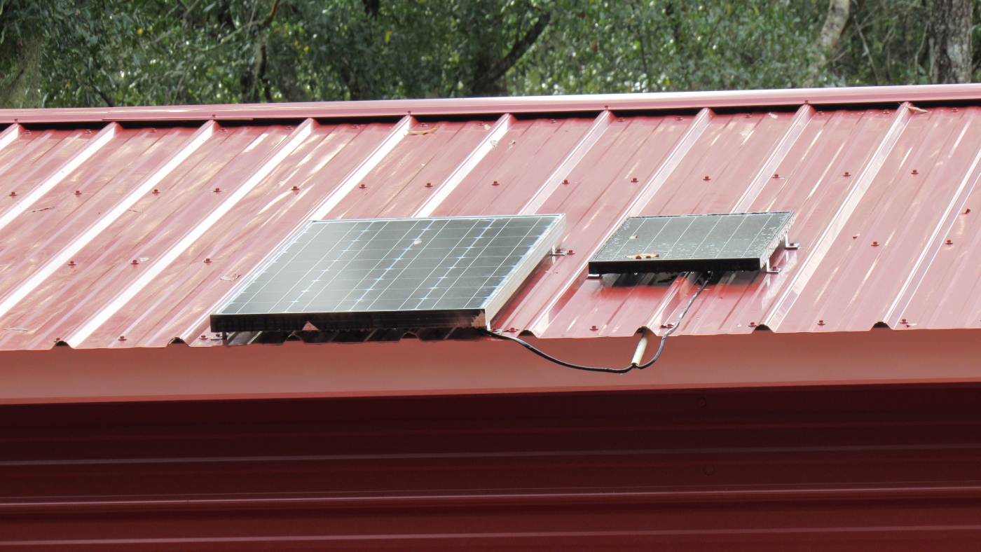

Depending on the surface you want to install the solar panels on. Personally, I have mine installed on the roof. I have two medium-size panels, and to be honest, I am happy with them. Still, I am not a professional in this field, so I recommend you speak with someone more experienced than me in this field. For instance, you can get in touch with the guys from dragonsbreathsolar.co.uk .This, the company from where I got my solar panels, so I assure you that the services offered by these guys are on top.

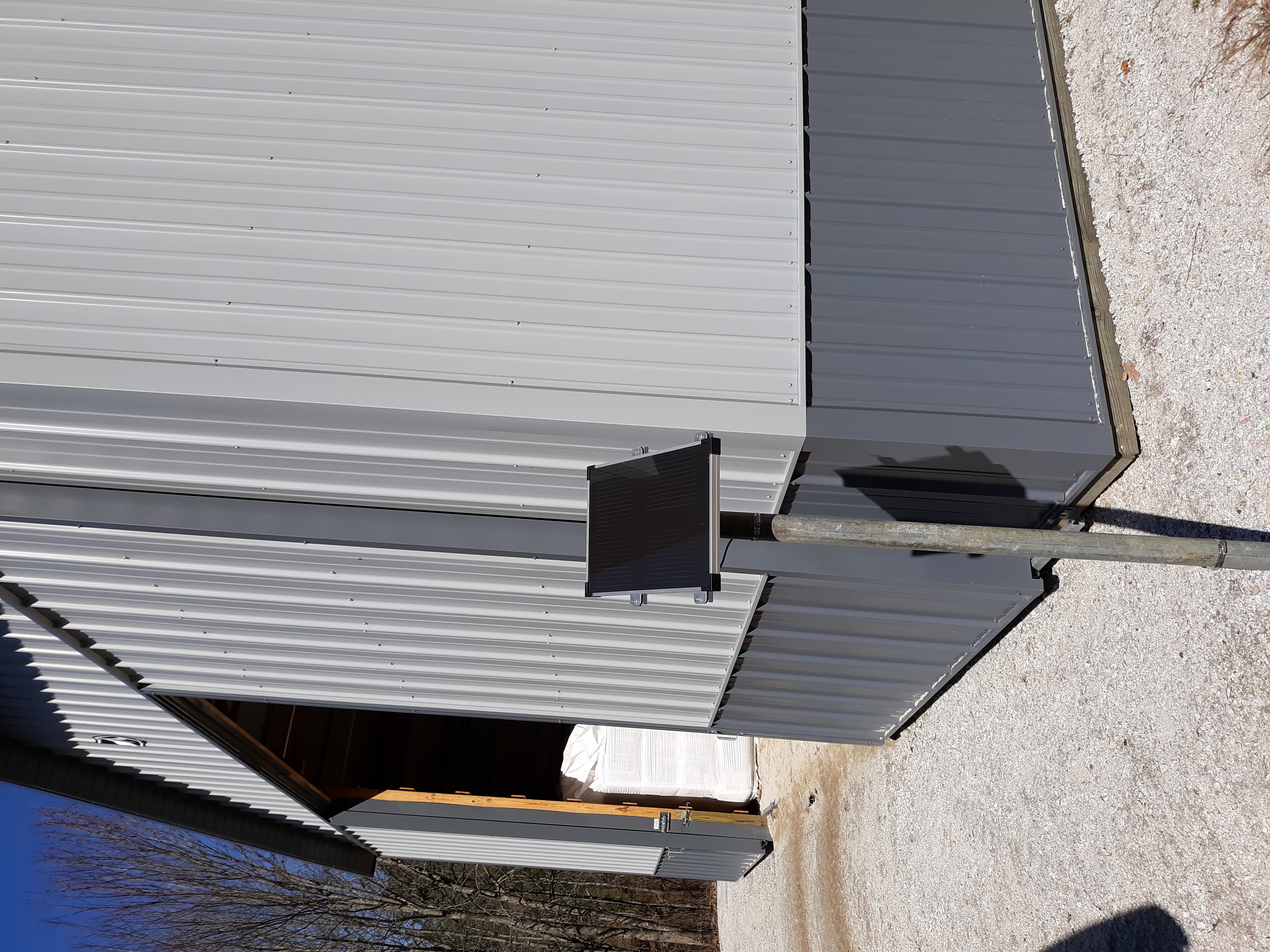

I swap my 30W panel back and forth between a car and tractor from time to time so I ran the panel positive wire through a toggle switch. I turn the panel switch off before I disconnect the controller and turn it back on after it's connected to the other battery.
