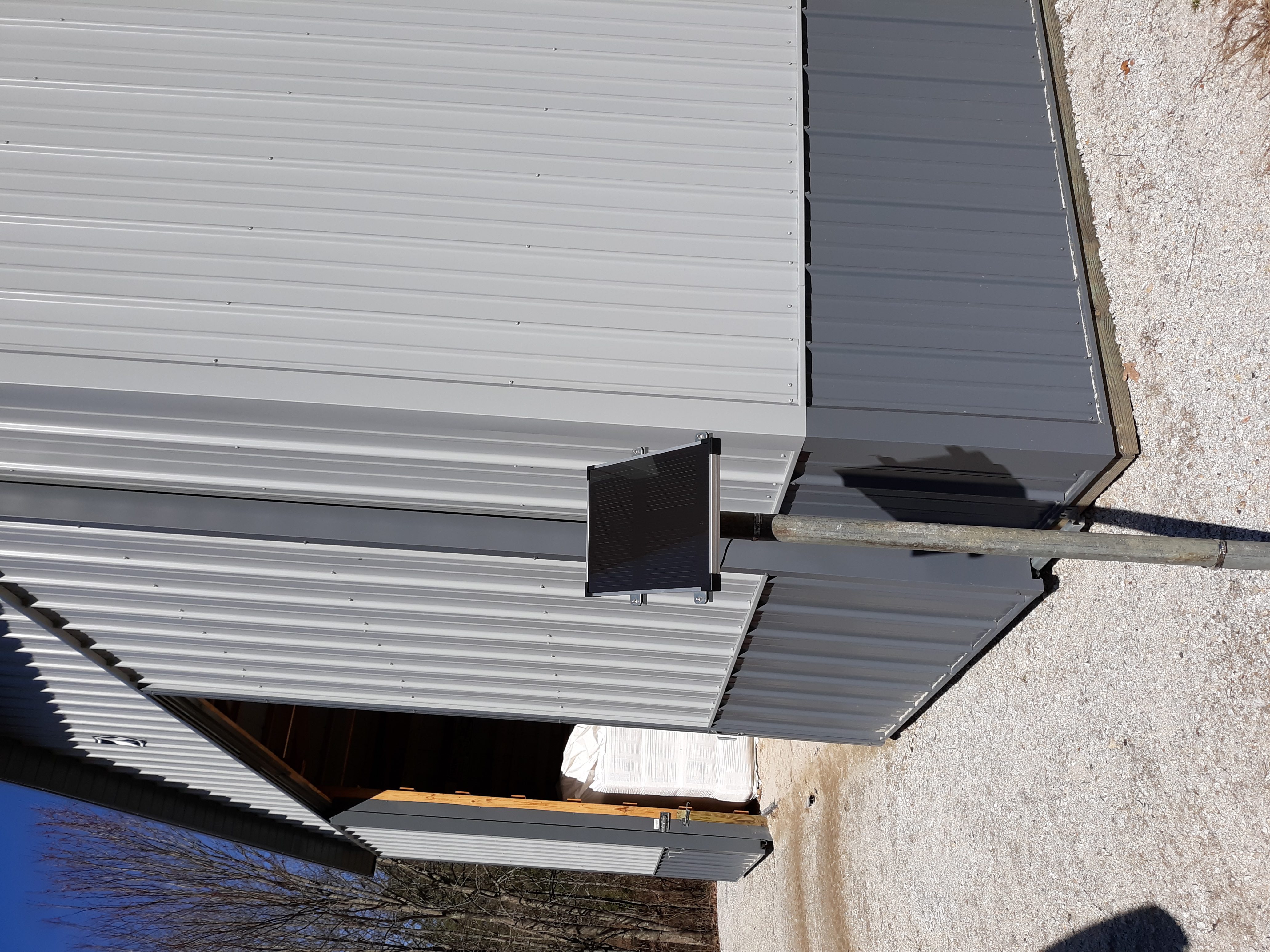

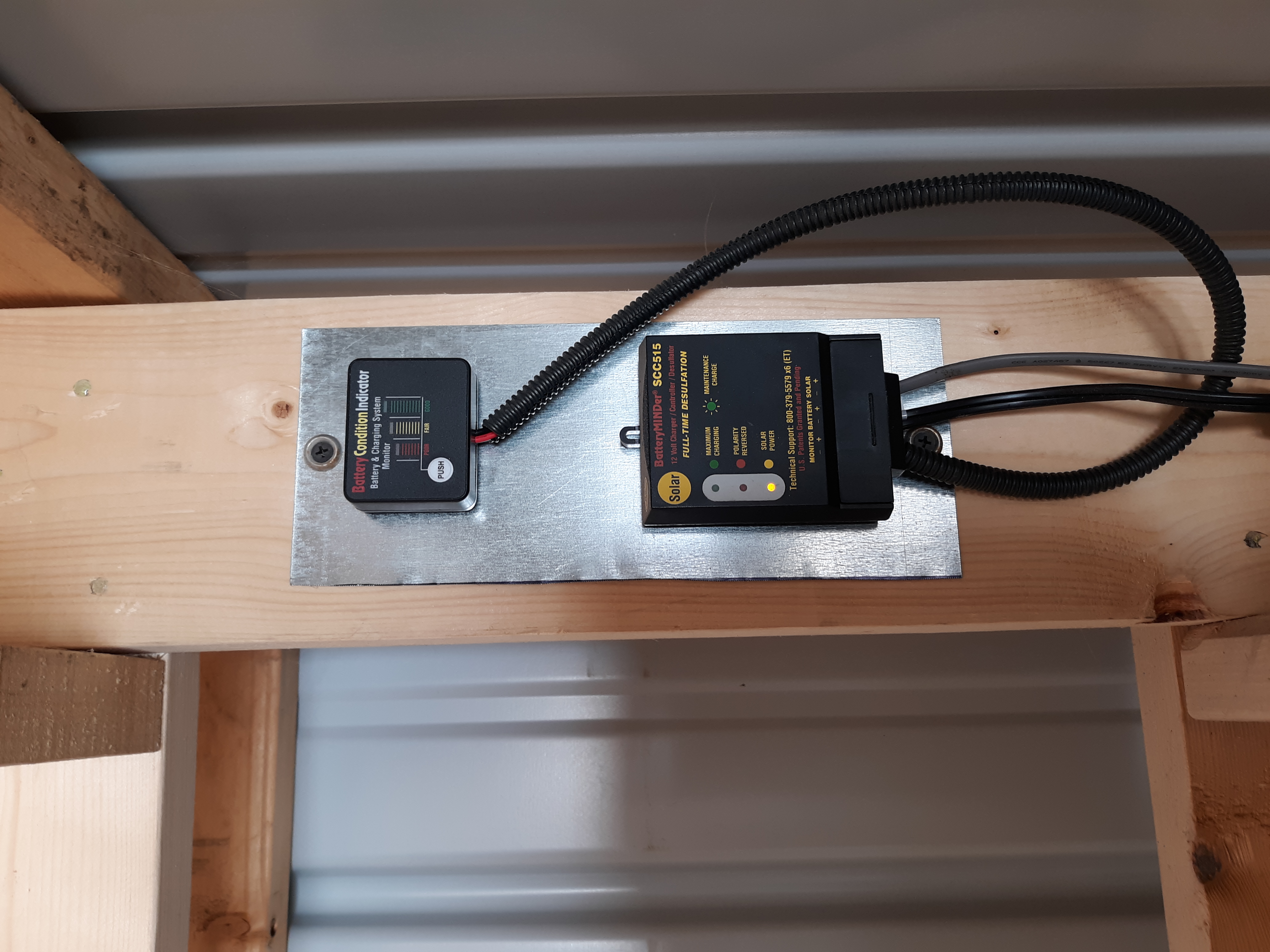

I recently bought the Battery Tender brand 5-45 solar controller. I have it connected to a 30W panel on the roof of my barn. I use the polarity connectors out of the Harbor Freight solar power connector kit. Make sure you check polarity with an ohm meter before connecting anything. I have pigtails on all my equipment with the positive connection on the equipment side being the insulated side on the connector.
Most of these controllers require connection to a charged battery BEFORE you connect them to a solar panel. I swap my 30W panel back and forth between a car and tractor from time to time so I ran the panel positive wire through a toggle switch. I turn the panel switch off before I disconnect the controller and turn it back on after it's connected to the other battery.
I also have one of those cheap controllers off eBay connected to a 100W panel. I have had mixed results with those but they seem to hold up if kept out of the weather. Right now I have that on a group 27 battery that isn't really doing much. I have a couple of LED lights connected to the load side and a Wyze Cam plugged into one of the USB ports.

These items will work but I would recommend going with a higher watt panel. A 5 watt panel won't do squat without direct sunlight. A higher watt panel will have some output on a cloudy day although limited it will be more likely to keep the battery charged.
I don't think total plug and play is available. You will have to do some cable splicing and planning for your exact needs. Think about how you want to mount the panel. How long does your tractor battery lead need to be. Stuff like that.
Here is a decent looking reasonably priced 30W kit with most of what you need. I like that it has the SAE plug in connectors. Remember the panel has to be unplugged before unplugging the battery and plugged back in to the controller AFTER the battery is connected.
Amazon.com : Sun Energise 3W 12V Solar Panel Kits- 3 Watt Mono Crystalline Solar Panel + Intelligent 1A Charge Controller with Dusk to Dawn Control + Cable Adapters for Off Grid Boat, Marine, Trailer, Cabin : Automotive
Here is an extension cable that should work with the linked kit.
Amazon.com : POWISER 25Feet SAE to SAE Extension Cable Quick Disconnect Connector 16AWG, for Automotive, Solar Panel Panel SAE Plug(25FT(16AWG)) : Garden & Outdoor
These Z brackets are handy for mounting a panel on a flat or ribbed surface. I have read that having some air space under a panel makes it cooler and more efficient. https://www.ebay.com/itm/4-SOLAR-PA...e=STRK:MEBIDX:IT&_trksid=p2057872.m2749.l2649
I used a heat gun and bent a piece of PVC tube to run my wires under the edge of the roof. That protects the wires from chaffing and provided a drip loop.
I used a project box with toggle switches to make it easier for me to disconnect my panels before unplugging the tractor or car. Those SAE connectors in that kit I linked will be easier to configure and easy to unplug and connect.
