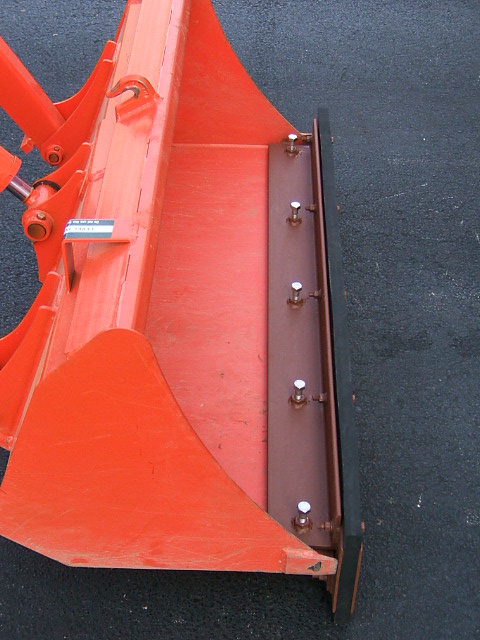

/ "Soft" edge for snow removal? #6
Plow rubber from Rubbercal - some angle iron and some welding...

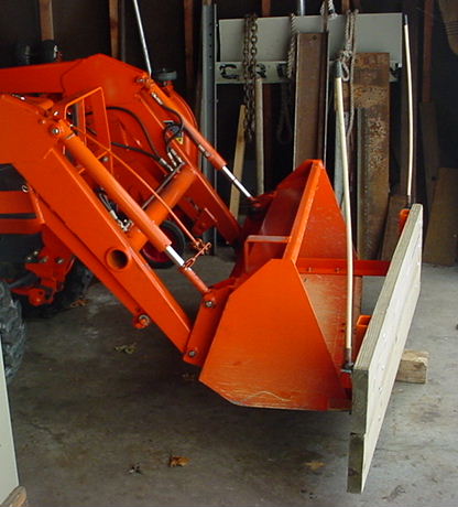

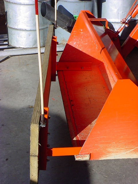

/ "Soft" edge for snow removal? #7
Jabroni,
I made this cheap and simple snow pusher. The wood doesn't damage the surface and when the wood wears down I just reverse it, then replace it. I do quite a few drives and there is actually little wear.
Use that float feature.
Wow, both clever ideas! Nice job. I've got plenty of time to work on one too. Thanks!

/ "Soft" edge for snow removal? #10
Jabroni,
I like the snowpusher made of wood. I'll try to make one for the next snow. I was able to deal with 24" the past weekend with only a FEL and rear blade. A similar snowpusher would have helped a lot. I'll try to remove the toothbar and use the same holes as attachment points.
Great design.

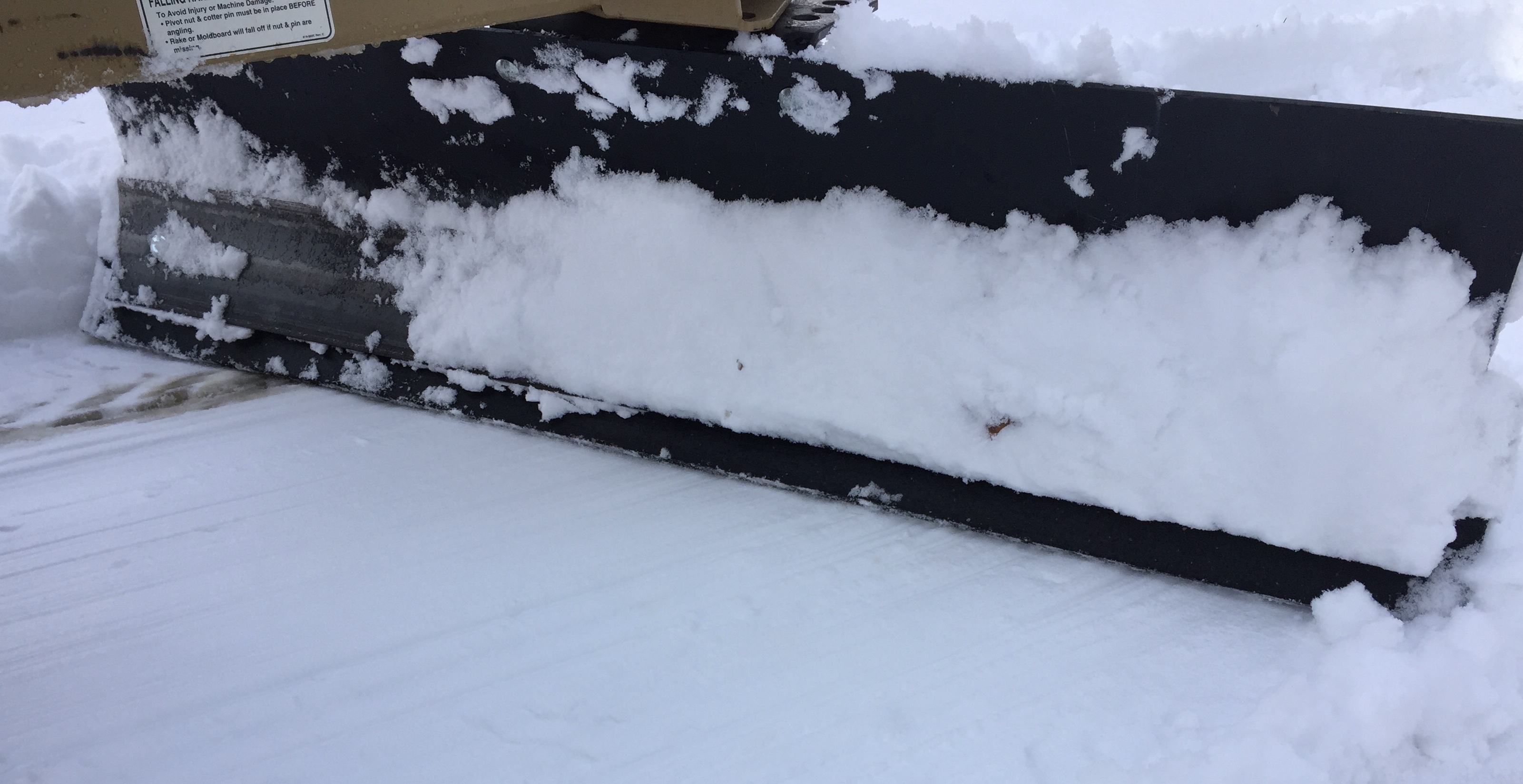

/ "Soft" edge for snow removal? #11
I had to wait almost 3 years but finally got the chance to try the rear blade with a piece of TSC stall mat attached.
It definitely moves far less gravel, though time will tell how long it lasts. But then again, I’ve got enough left over for many more pieces.

/ "Soft" edge for snow removal? #14
View attachment 582483View attachment 582484
thanks will be going to TSC to get the stall mat for my 6.5 meyer plow.
42 bucks:thumbsup:

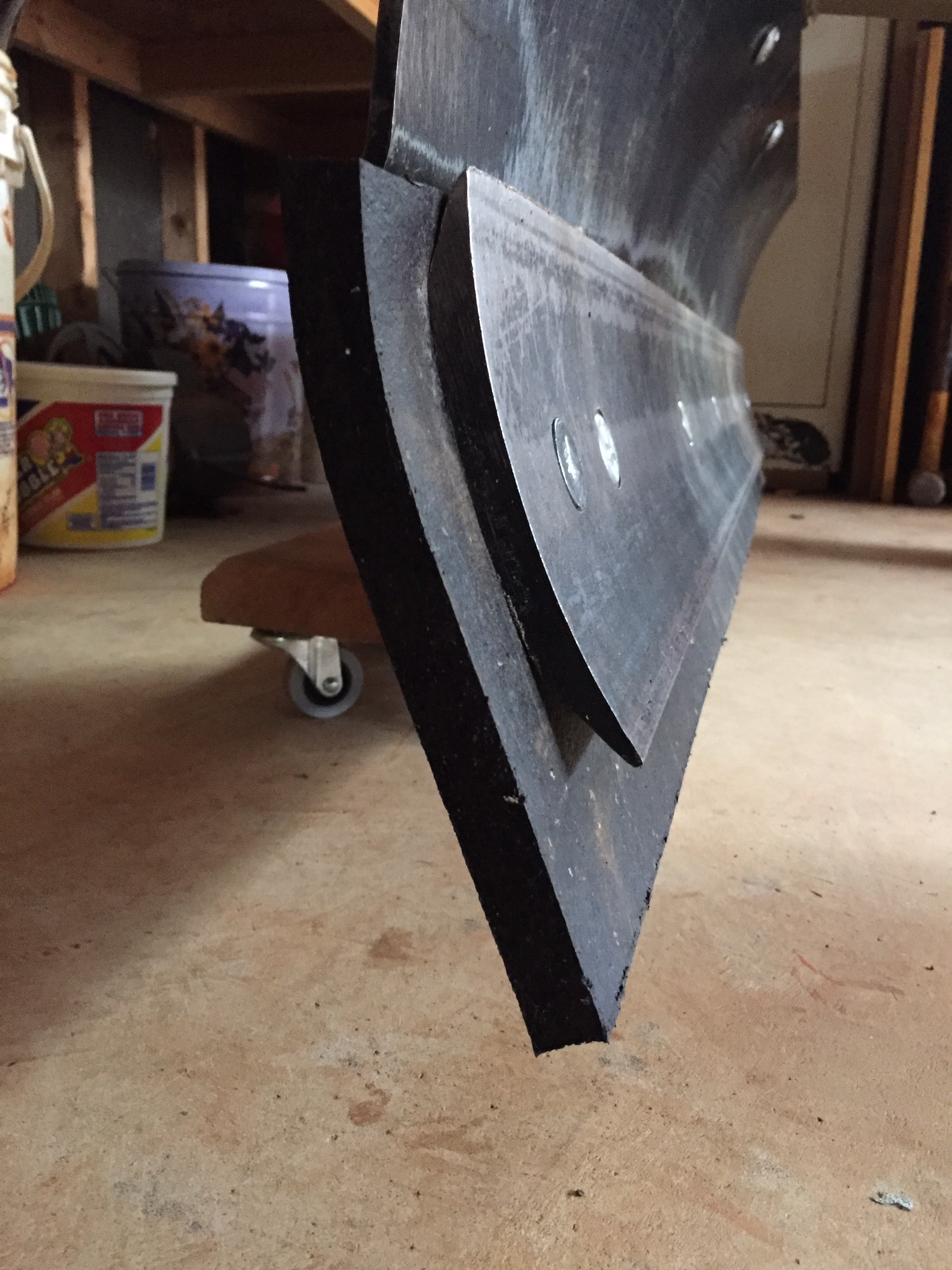

/ "Soft" edge for snow removal? #16
Below is what I have :
urethanestore.com
Snow Plow Blades - Holes Not Included
Thickness x Width: 1"x6"
Length: 60"
Sandwiched it between the cutting edge and the plow like psvines pic on my Bx2763.
Works amazing.
