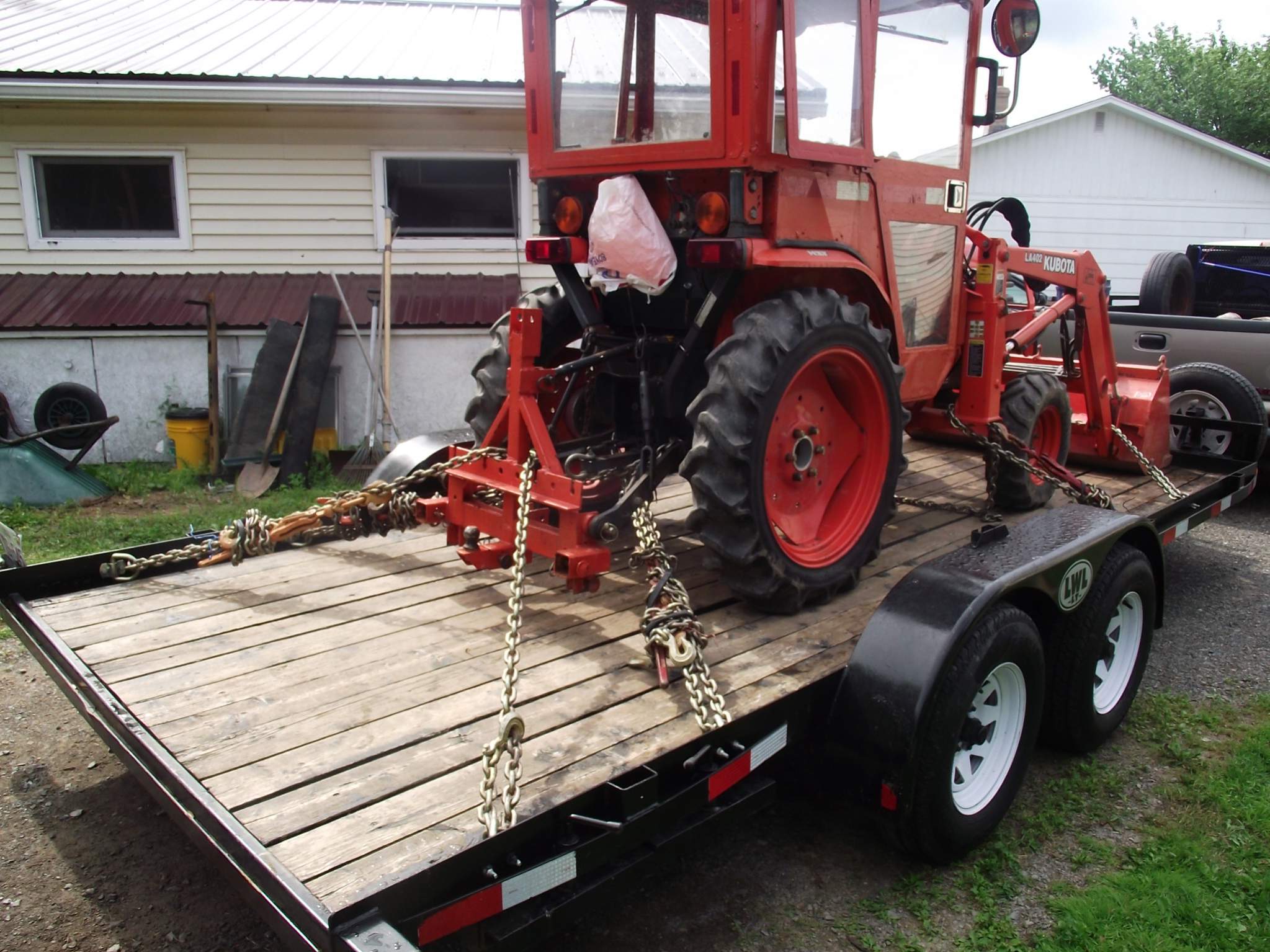

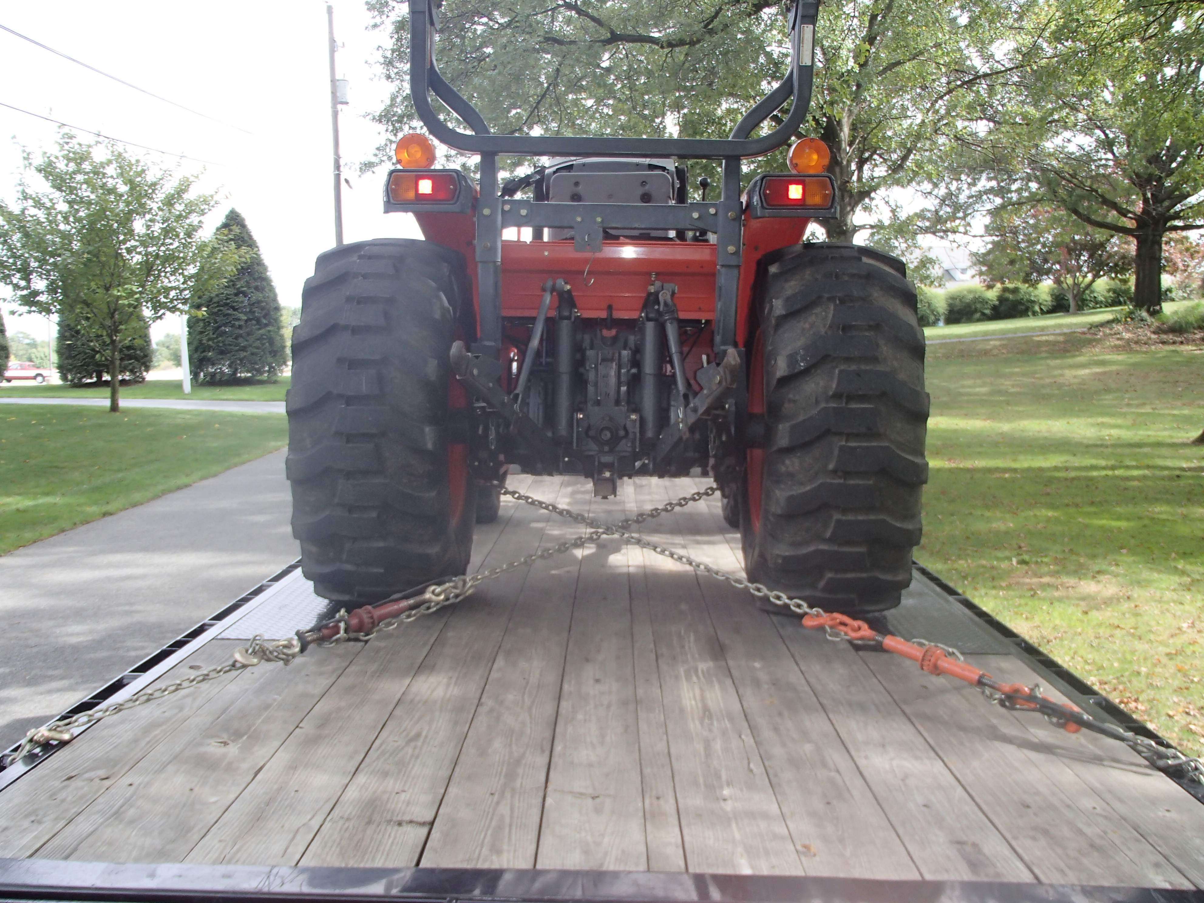

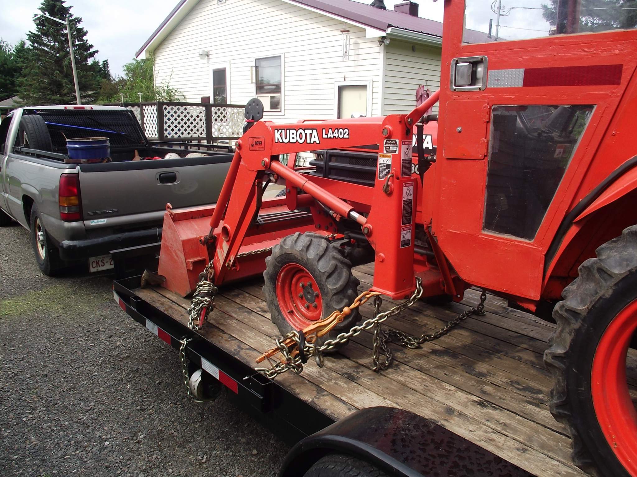

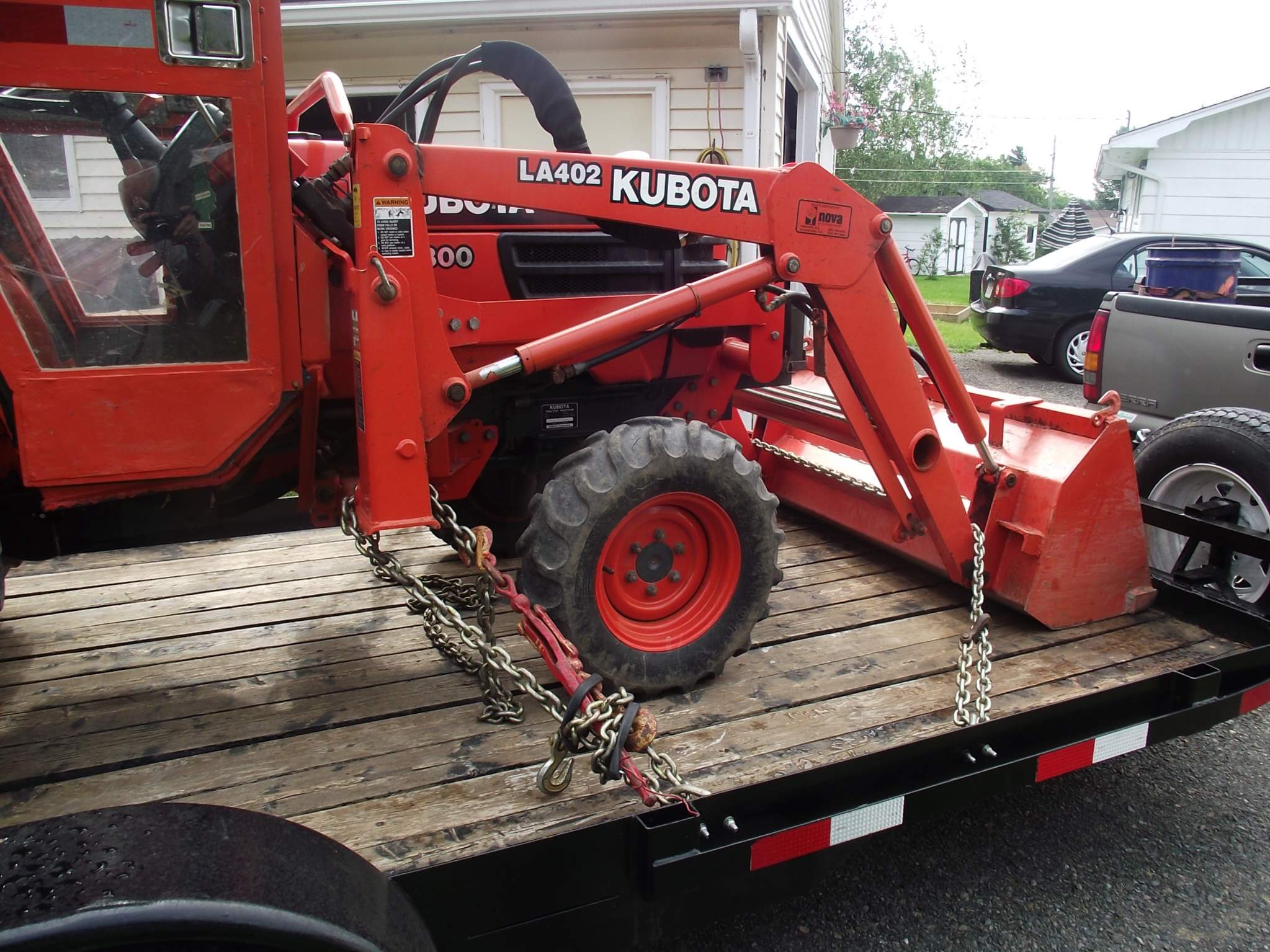

/ So how do you fasten down #5
Some may consider this overkill, but this is how I chain down my B7800. It weighs much less than 10,000 lbs. (I'm guessing about 3200 lbs.) but I secure it as if it did weigh 10,000 or more. Commercial Vehicle Enforcement is active around here and I don't want any fines, not to mention I don't ever want to lose a load. I have chains and binders from when I used to own and operate heavy equipment. All chains are G70 (all 3/8" except one 5/16") and all ratchet binders are 3/8" with the appropriate working load limit (WLL) for the G70 chains. All tie downs on the trailer are WLL rated to match the chains and binders.
At the front I secure both sides through the FEL tower mounts, using a single chain acting as two with a binder on each side, plus an additional chain and binder over the loader. At the rear, I secure to the TPH cross shaft, using one chain and binder on each side with the chains crossing (left to right and right to left), plus a single chain and binder over any implement mounted on the TPH. All loose chain is wrapped around the binders and secured with rubber tarp straps to prevent accidental release. I also cover the SMV sign while in transit.
I do have two ratchet straps mounted permanently to the trailer, but I never use them to secure the tractor.

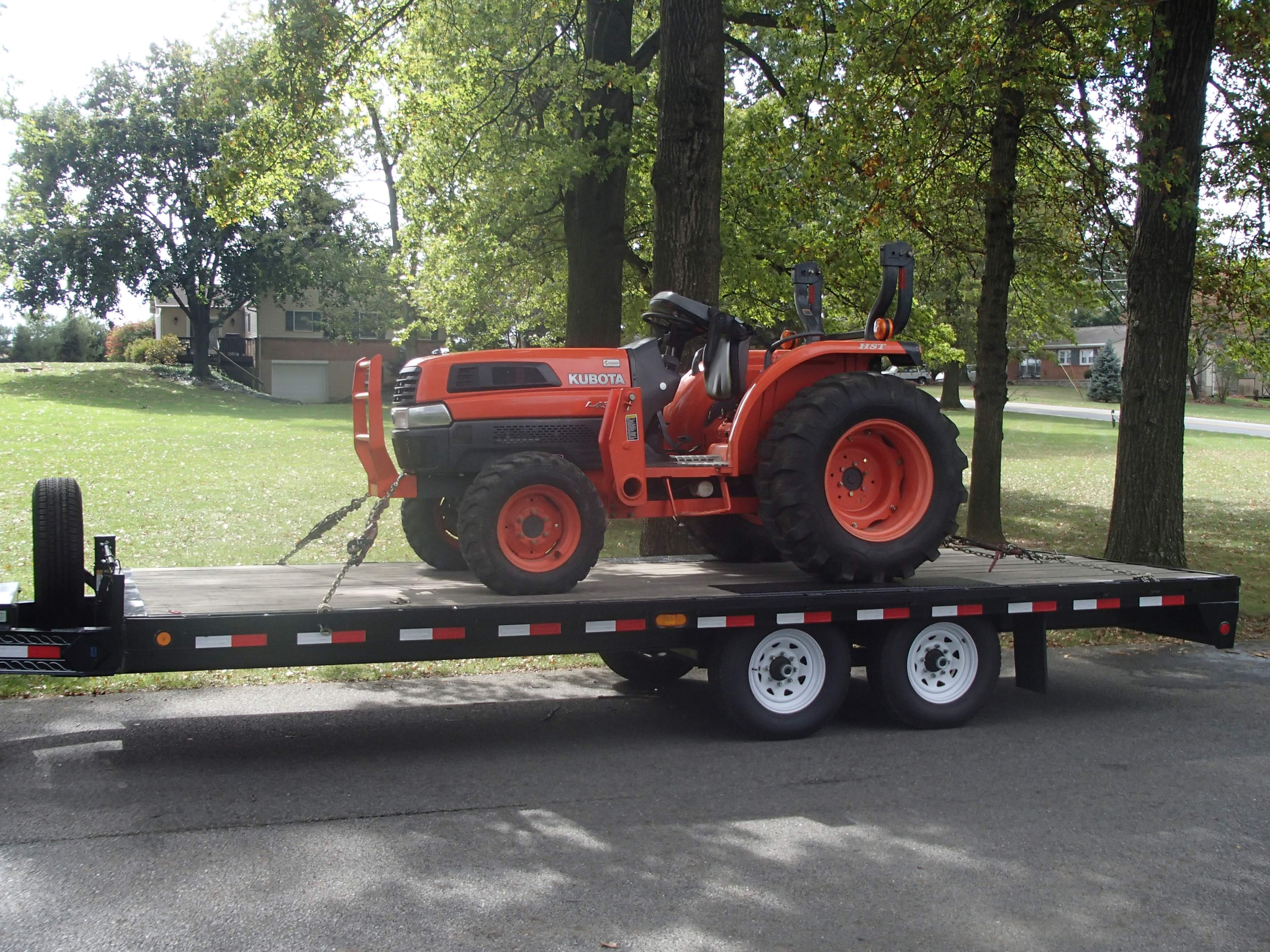

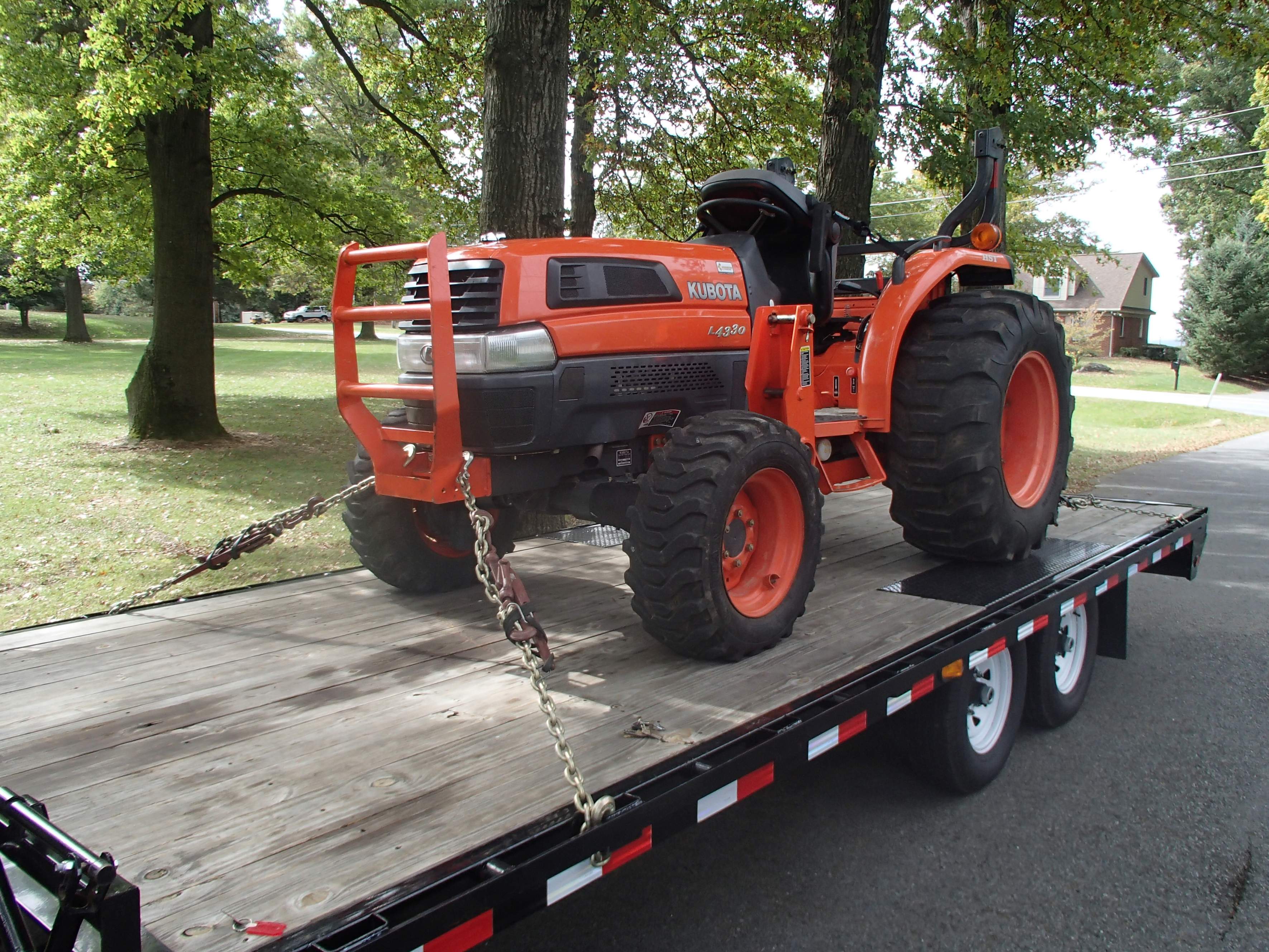

/ So how do you fasten down #6
I use chains. One on each corner, and one for each attachment.

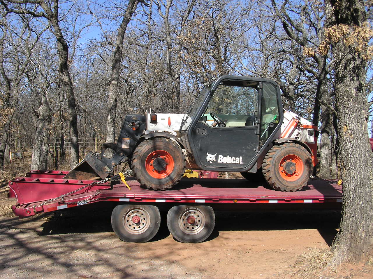

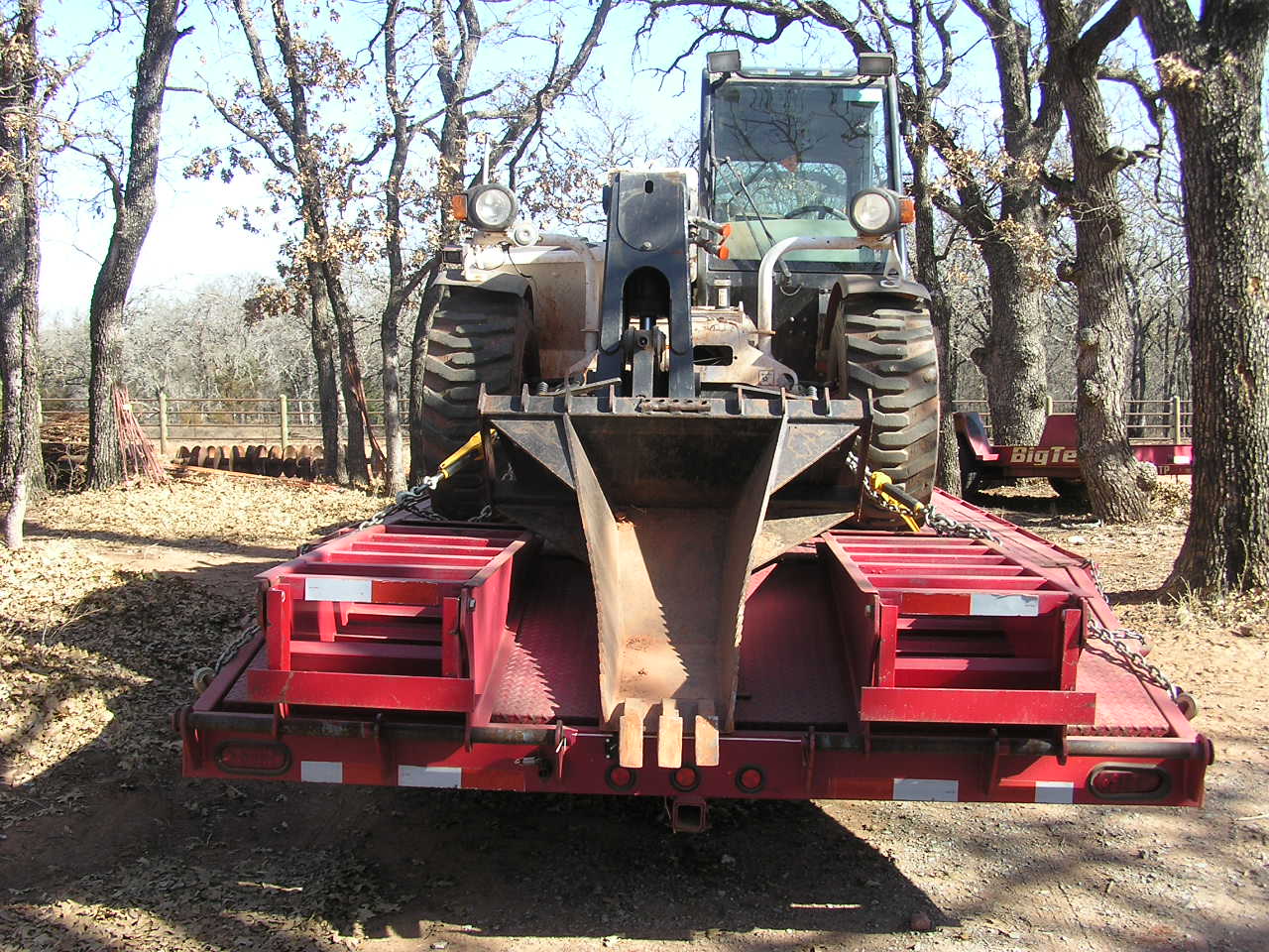

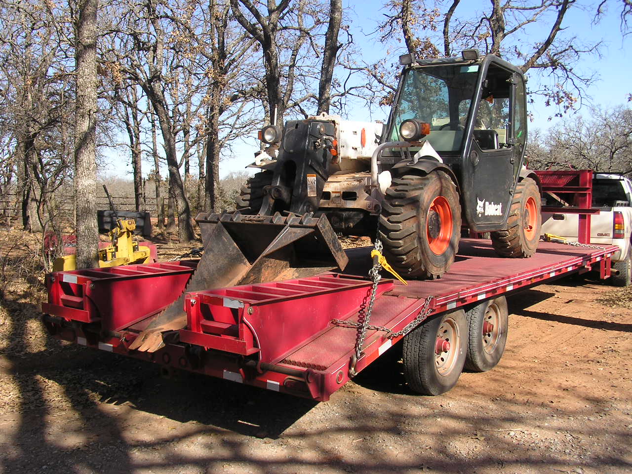

/ So how do you fasten down #8

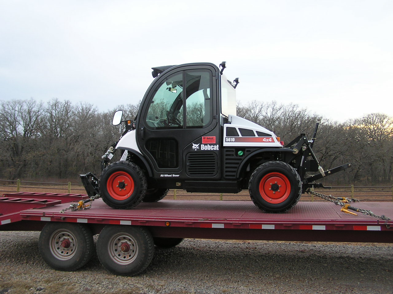

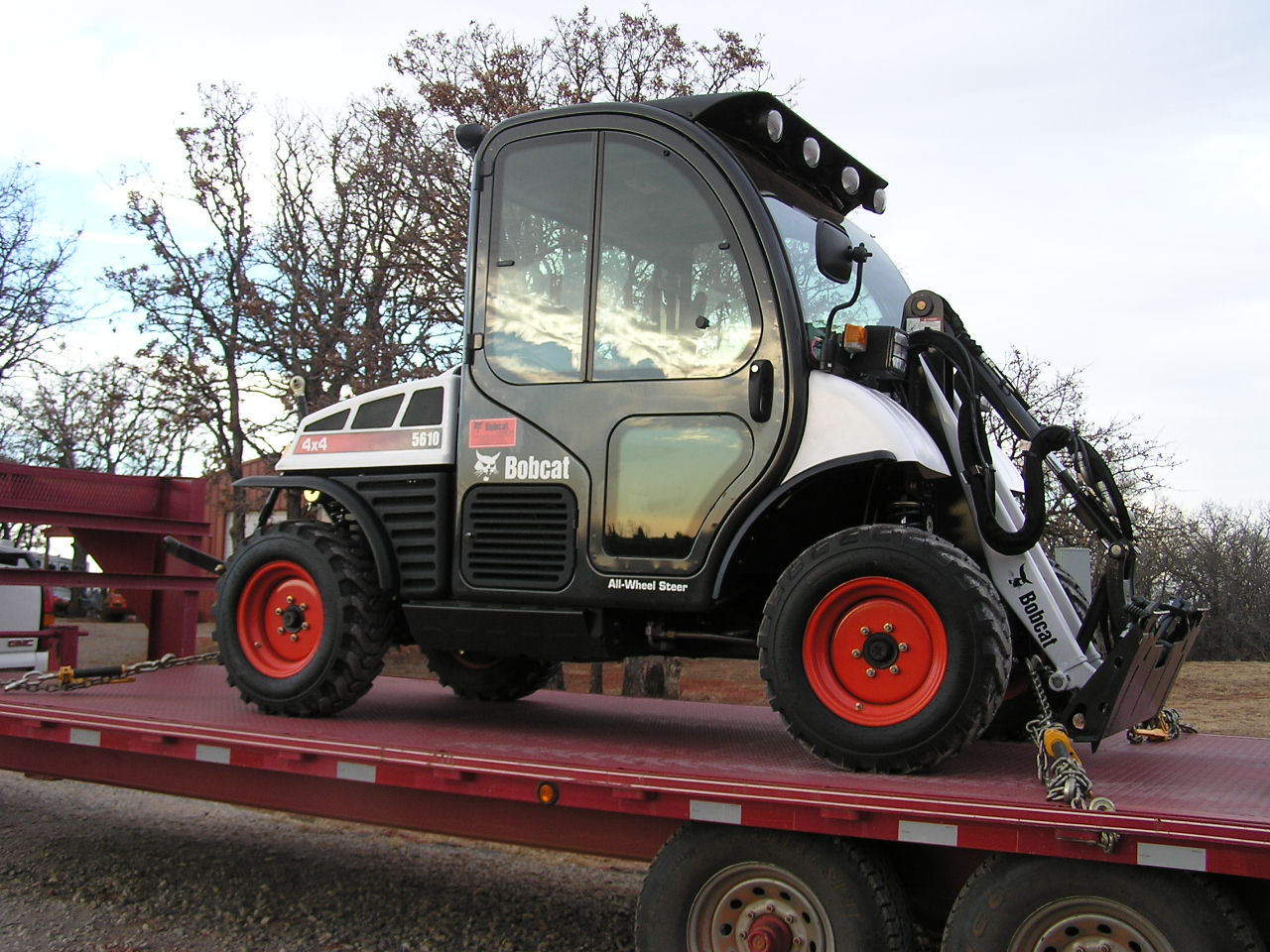

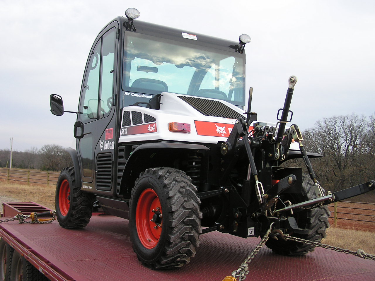

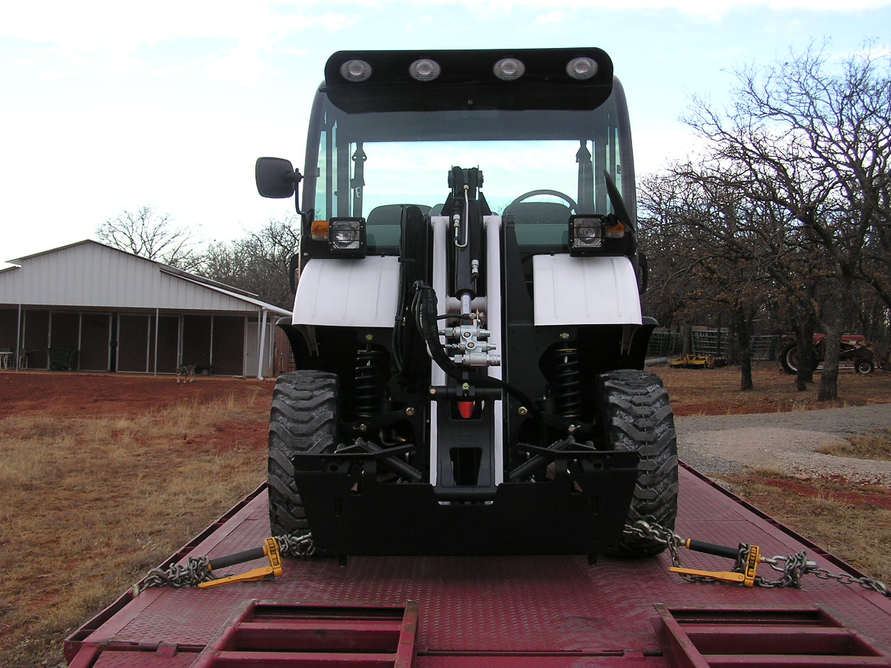

Re: So how do you fasten down the Toolcat?
I use 4 chains and ratchet binders from the trailer to the tie down loops on the Toolcat. :thumbsup:

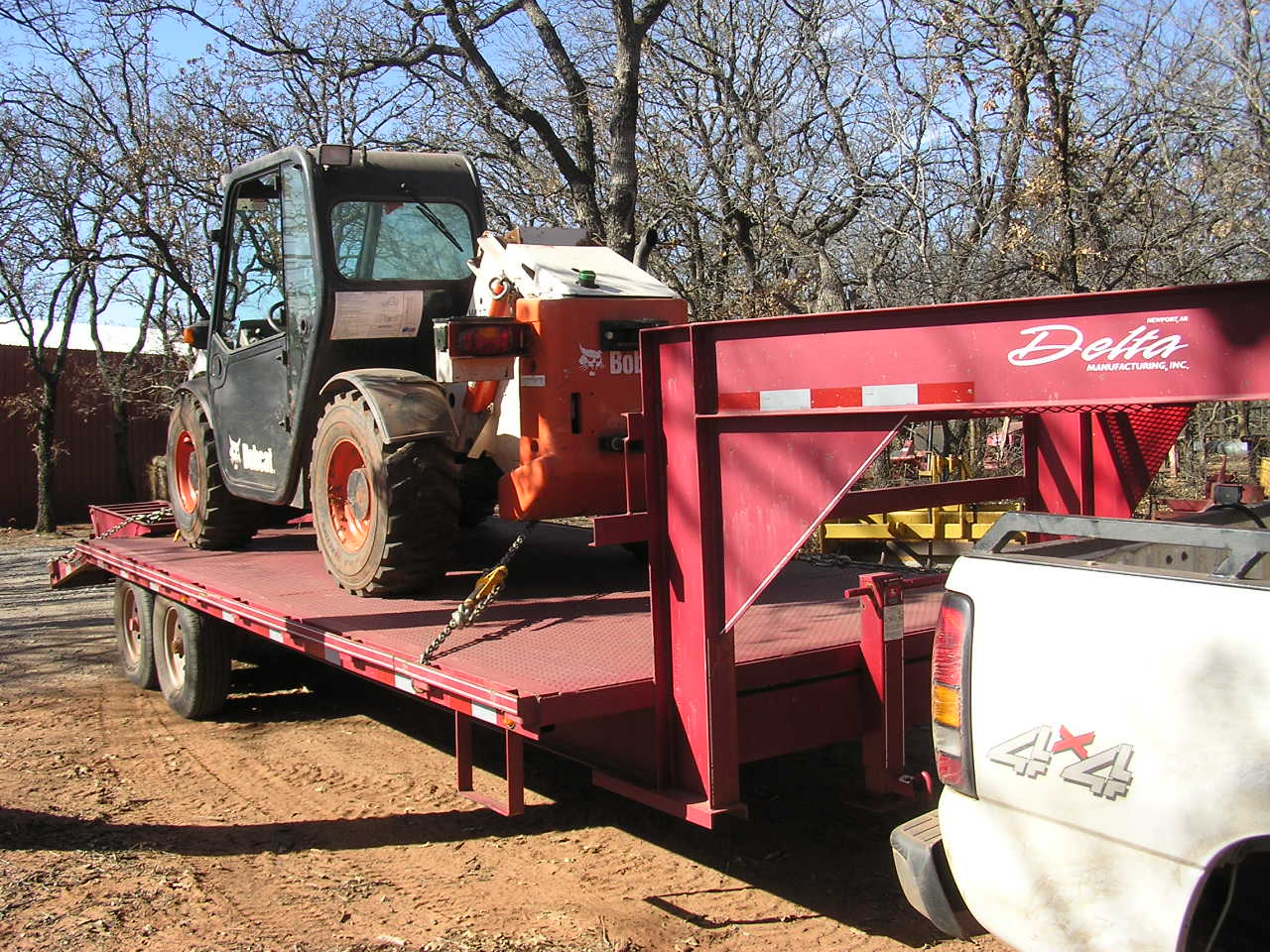

/ So how do you fasten down #9
Re: So how do you fasten down the Versahandler?
I use same 4 chains and ratchet binders from the trailer to the tie down holes on the Versahandler. :thumbsup:

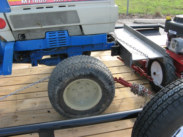

/ So how do you fasten down #14
(5) or (6) chains, with lever-type "over-center" load binders:
This is for a 1,400 lb tractor.
By the way, I have noted that some government agencies prohibit the use of "lever type" load binders on their own vehicles.
