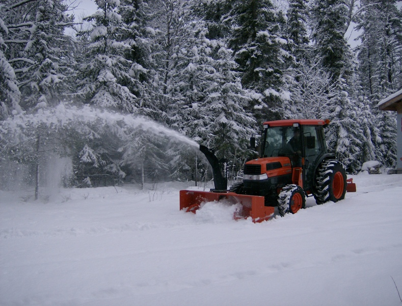

With 1 km of camp road to along and another 2 more to help other people to main road rocks is a problem. This is my first winter with tractor as I bought it new in the spring

Well, you're going to love that. Keep the shoes high. Private road? Get a box blade to level it over summer. You look like your up off Hwy 11. Nice ride!:D
   / Snowblowing rules of thumb #34
Off 17 up 101 past Wawa. yup it a private road with camps and some live year round. I will in 3 or so years when I retire. Tractor is my retirerment prensent to myself.
