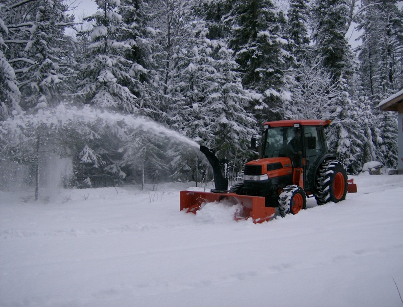

When blowing snow on the road to my camp I am breaking main auger drive chain instead of shear bolts. Any others is this a problem. I have a GL4630gstc with 72" front mount blower. I was expecting to pick up some rocks the first couple blows but first time broke chain and shear bolt and second time just chain.

I thought they would be like on walkbehind blowers. But the orginal bolt with orange paint had no groove.
