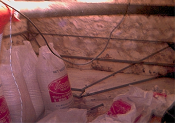

I dont know if you have ever heard of heating a house with corn, but thats how we heat our house here. Its called a central furnace. An auger feeds the fire with corn and you only have to fill the hopper like 2 times a day and it puts off alot of heat. My dad wanted me to build a bin to hold corn so here are some pics of the frame, its not done yet but when it is il be sure to post more /forums/images/graemlins/cool.gif

another pic

and last one
