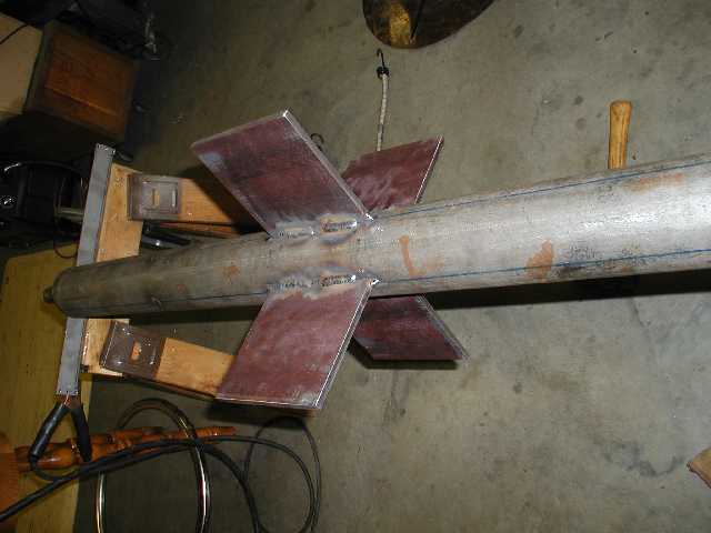

And the next step, the paddles are fixtured and tacked onto the tube. Four paddles, each is fed from one peice of flighting. The two flights from the right hand end feed paddles one and three, the flights from the left hand end feed paddles 2 and 4. Should run smoother than the two paddle versions.

Here's the fixturing removed, paddles welded on lightly. Lots of parts get added yet, so no sense getting too carried away. Balance is perfected again after this step. The paddles were sawn out and then milled on every side for a size match. Then the one edge had a 12 degree bevel milled on, since the paddles actually are attached with a slightly "backwards" lean (compared to the rotation), to promote snow shedding.

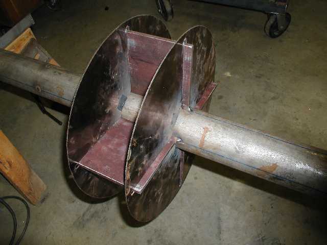

Here's a pic of the "cups" which are added to each paddle, opposite of the paddle ends that will have flighting connecting.

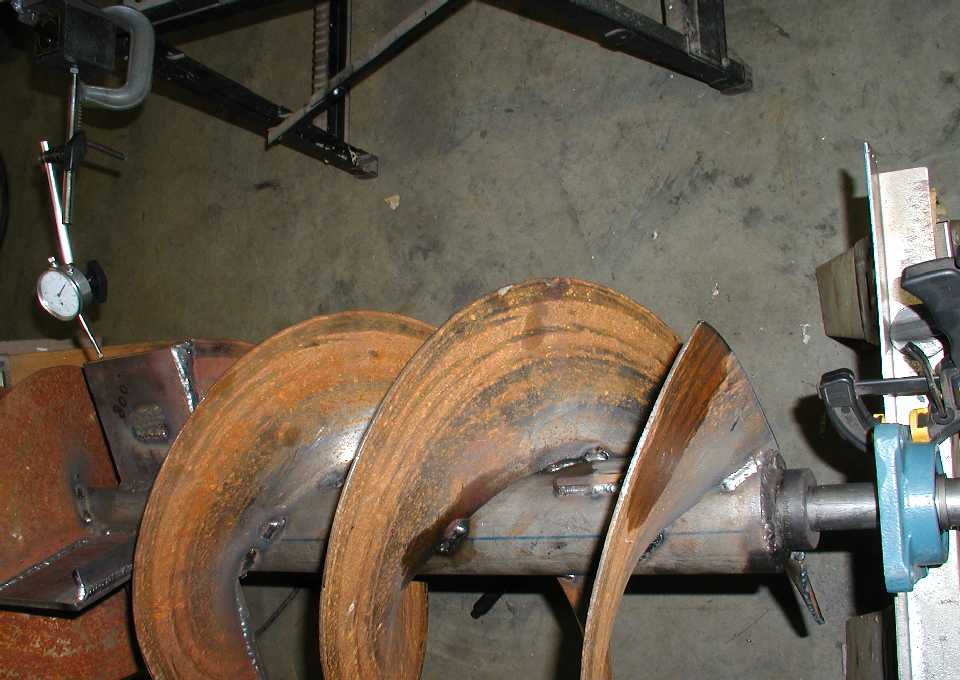

#35
Here's a pic from last night. After finishing welding on and cutting the ends square for the last two pcs of flighting, I was having trouble getting the assembly to static balance again. It occured to me that there was probably some welding distortion going on. So I set up what you see in the photo to evaluate it. Initial measurements showed one paddle was 0.149" further from centerline than the one opposite it. The other two were pretty close at 0.079 and 0.085. So I welded on the high side, rewelding existing beads to keep it from looking too messy. Three sessions of welding and letting it cool and contract did the job. It was fun to have the dial indicator on there and after welding watch the needle creep along at about 0.001" per three seconds. Final results: no more than 0.005" difference between paddle sets.
Then, I static balanced it by adding more welding in the proper areas to make the thing just laze along on the knife edges, with no particular heavy side. Impeller is finished!
