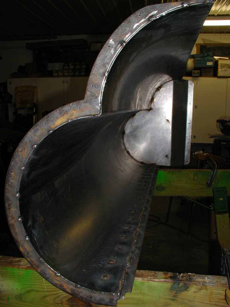

Here is one angle iron stiffener. There will be four of these, one on each end, two spaced out along the middle length of the housing. The two on the ends also serve as convenient faces to bolt through to hold on the end cap plates. The four of these stiffeners are built identical, and that is also what keeps the housing in shape across its width.

No, I didnt roll them, they were rolled by some kind of special pupose machine. I found about ten of them in the industrial junkyard near my house. They had an 18 inch diameter when I found them. I had to modify them to 15.3" diameter. To do so, I drilled thru the ends so I could stretch a pc of threaded rod across the ends, then tightned it down a bit, and hit the free leg on the anvil to stretch it. Then tighten, then hit to stretch again. 20 minutes of cold working with the flat of the 2 pounder made them look pretty nice, comparing to a pencil line on paper. I finished a second one last nite, two more to go. I will be glad when that step is done.

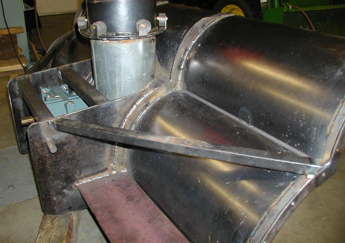

Made a bit of progress. Here's a pic of the housing. The rolled angle iron pcs are tacked on each end. I have made two more that will go in there approx mid-span sometime. Also visible is the cutting edge, plug welded and edge welded on.
