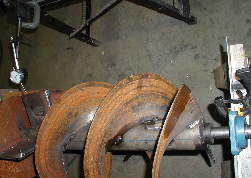

Here is a closeup of the final reduction. The tensioner is not yet mounted. It is on the slack side of the chain. Its tough to see in this pic but I added a channel on the lower side of the chain (the tension side), lined with snowmobile Hyfax mat'l.

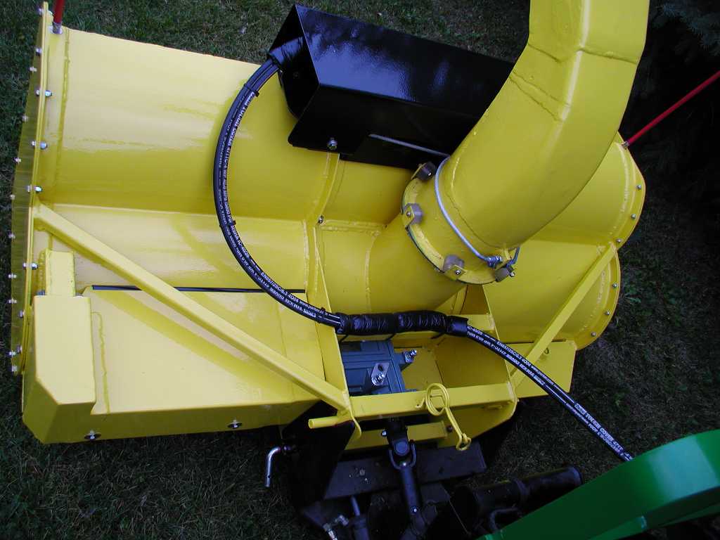

Chute rotator is now complete (see attached pic). It works better than expected, providing smooth rotation thru over 270 degrees. Yes, I can almost blow snow into my face from either direction! This design is based on a picture I found of a John Deere design on their small front-mount 47" blower. Also, I found Meyer truck snowplow feet at my local Fleet Farm and installed them for my height adjusters. Everything is working well, tested thru several snows, and reblew every bit of snow all over the yard just for fun. It certainly is enough blower to harnass my tractors power. Good thing its hydrostatic. Left to build: a chain/shaft guard, and a deflector for the center of the impeller, to deflect the snow downward if it comes all the way around and back out the front ( a common effect on single-stage throwers). Should be ready to sandblast soon. Have local body shop lined up to paint it. John Deere yellow of course. /forums/images/graemlins/cool.gif

/ Snowblower plans? #67
The chute rotation on the JD using the same mechanism is only about +- 80 degrees for a total of less than 180 degrees.
I upgraded mine by adding another trip around the pullys to get about 270 degrees.
It is nice to be able to throw the snow "over your shoulder" at times.
- Rick
/ Snowblower plans?
#68
The chute rotator: When I studied the original owners manual photos (very small pics), I thought I understood the mechanism to provide a two-to-one advantage. In other words, an inch of hydraulic stroke would move the chute two inches. I then sized the hyd cylinder stroke for 180 degrees. After testing, it became apparent that I had misunderstood the leverage, its actually three-to-one advantage. That's how I got a bit over 270 degrees of total rotation. And, yes, it is nice to throw it over your shoulder sometimes.

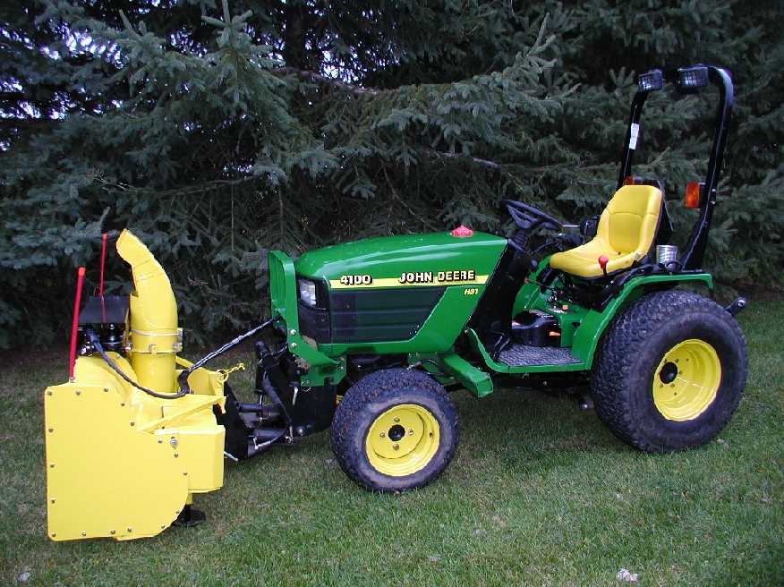

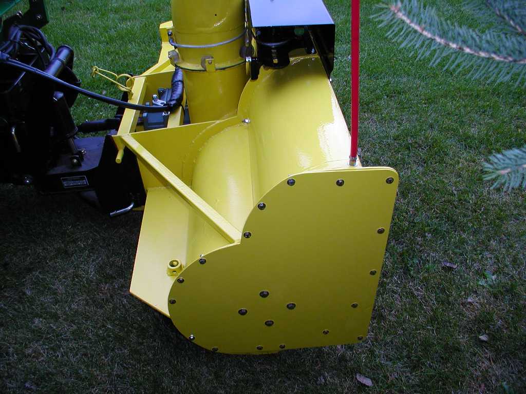

No winter available yet, but here's a pic in the front yard. Too bad there isnt a way to post a little low-res video. I made one last winter blowing snow before I painted it but you get the idea.

/ Snowblower plans? #75
Thanks Jim,
Real nice paint job also! You could bring that rig up to Vt and give it a workout last week. We had 7 inches! Ive been a modelmaker/ toolmaker all my life, and if I could figure out how to weld like you Id be tempted to give it a try! We are standing by for some snow pics /forums/images/graemlins/laugh.gif /forums/images/graemlins/laugh.gif
scotty
