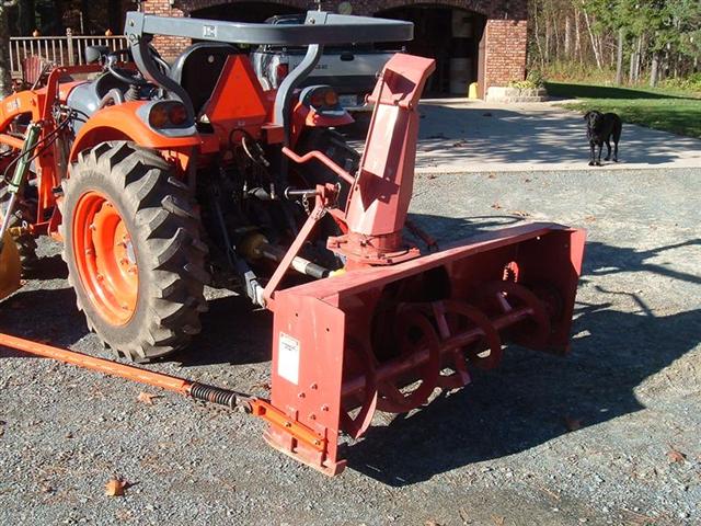

My tractor is a little smaller, and I don't have a blower on my 3PH. I wonder if it could be tied at two points in the back- down low just in front of the rear tire, and maybe at the base of the ROPS bar. I worry that I'd ruin my 3PH...
Did you make the blade from scratch, or cut down an existing one?

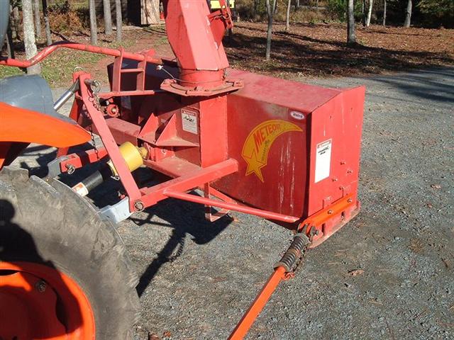

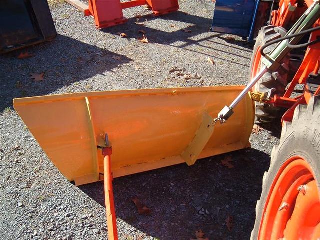

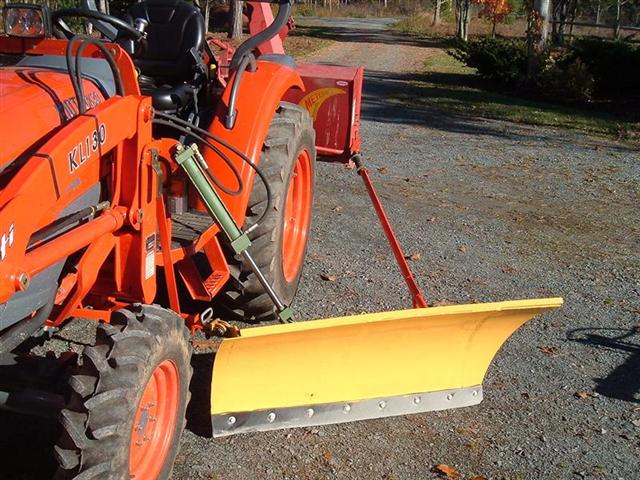

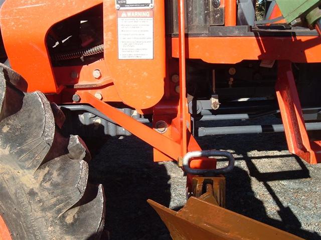

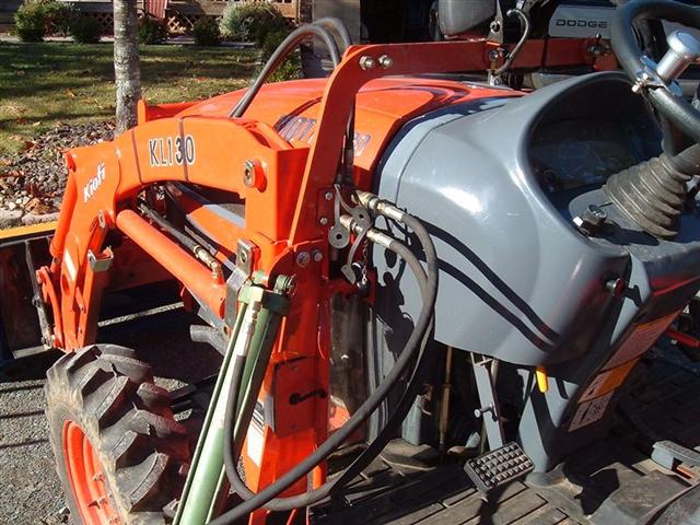

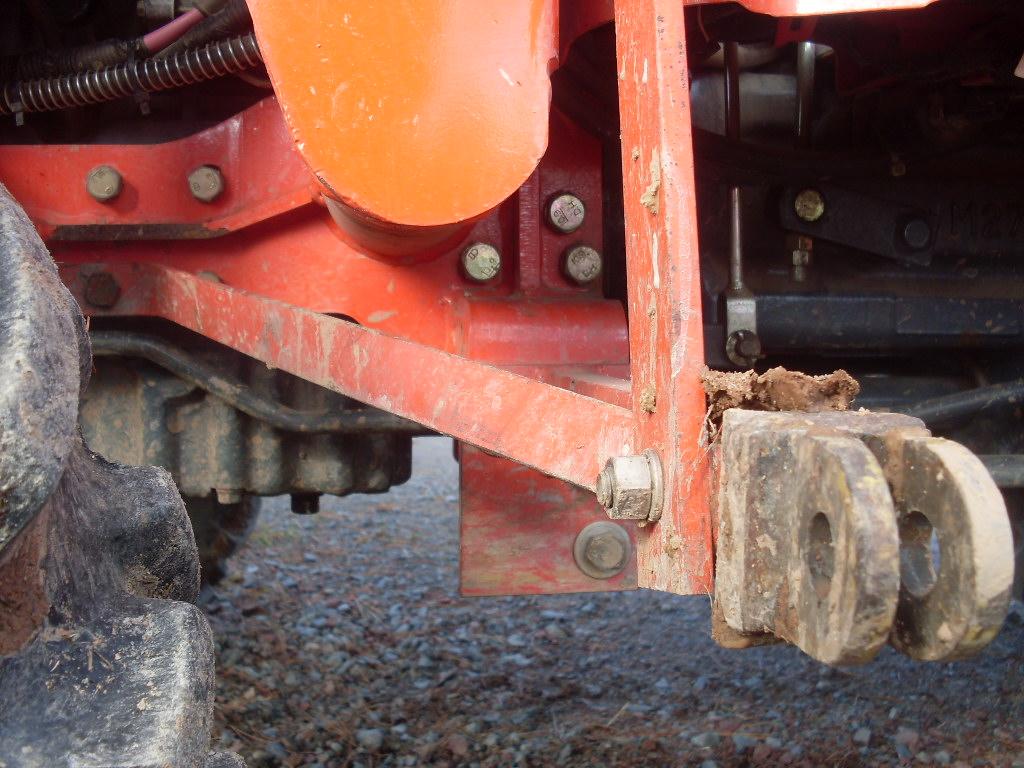

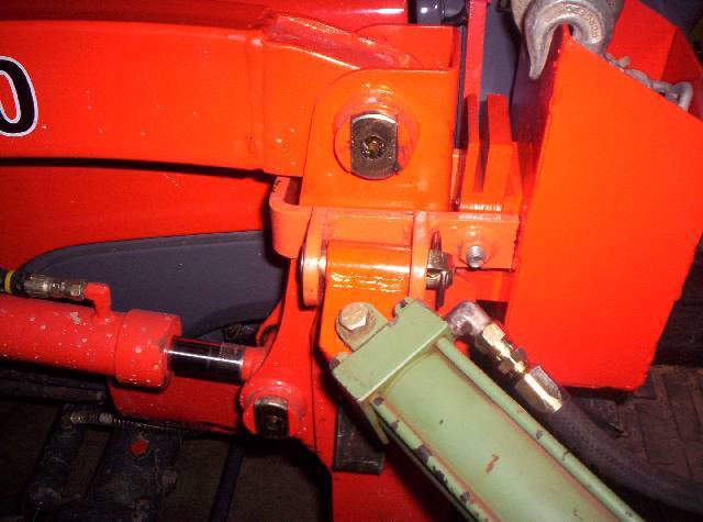

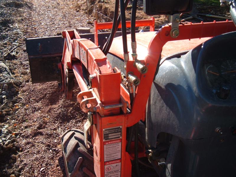

Here are all the pictures I have of the wing set up. Any questions I'll try and answer. Some are from the CK20 and some on the CK30. This setup has not damaged anything on either tractor to date. In my eyes, side pressure with this setup cannot be much worse than if you are using a backblade and hook something with either corner of the blade. There are springs on the rear support to take some of the snap out if I do hit anything. I probably put 20 to 40 hours a year on this setup depending on how much snow we get. I use the wing whenever I can as it is much faster than the blower. Blade, less than an hour to do mine and the neighbor's driveway versus the blower at about three hours. Total plowing is about a half mile or so.
Steve

Thanks for the post did'nt mean to hijack the other thread. Nice set-up looks like it does a good job, would love to see a frount pic of it. What's the width between the frount blade and wing work out to. Thanks again.
/ Snow wing
#39
If front blade is angled to that side, it's somewhere around 3 or 4 feet. I don't usually use both front and wing at the same time as they are both on the same hydraulic circuit and it gets a little too much side push if using both at once. I try to get some speed up when pushing or your banks build up quickly because the snow will not roll over fast enough if you know what I mean and I've had it happen a couple of times where to much side load steers you to the ditch pretty quickly as well.
Steve
