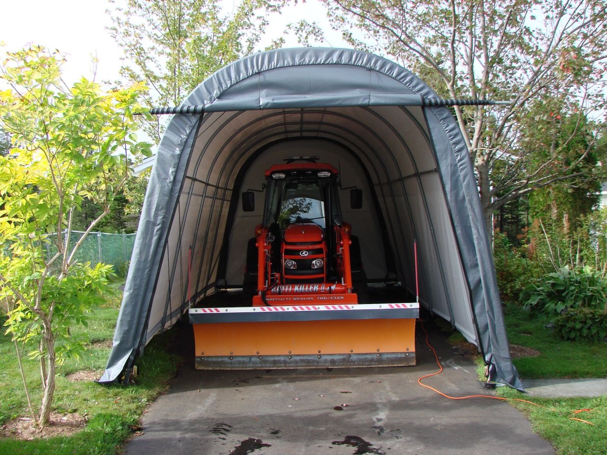

Sorry to hear about your shed. I've got one that's been up two years and survived three tropical storms.

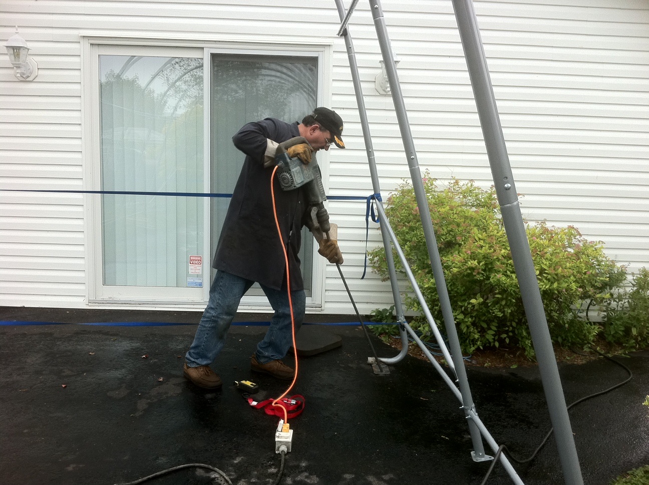

Mine is made by Shelterlogic. I purchased it from Canadian Tire. I went with this design because its shaped like an egg and the snow don't hold up on the roof. It's planted on pavement and I used over 20 lengths of 40" rebar to hold it down. I used a ground rod driver to put them down and it stayed. Never an issue and I've seen the neighbours 30 year od trees topple down and the shelter stayed up. It's says you can put one of these up in a day well it took me three working on an off but again, it stayed.

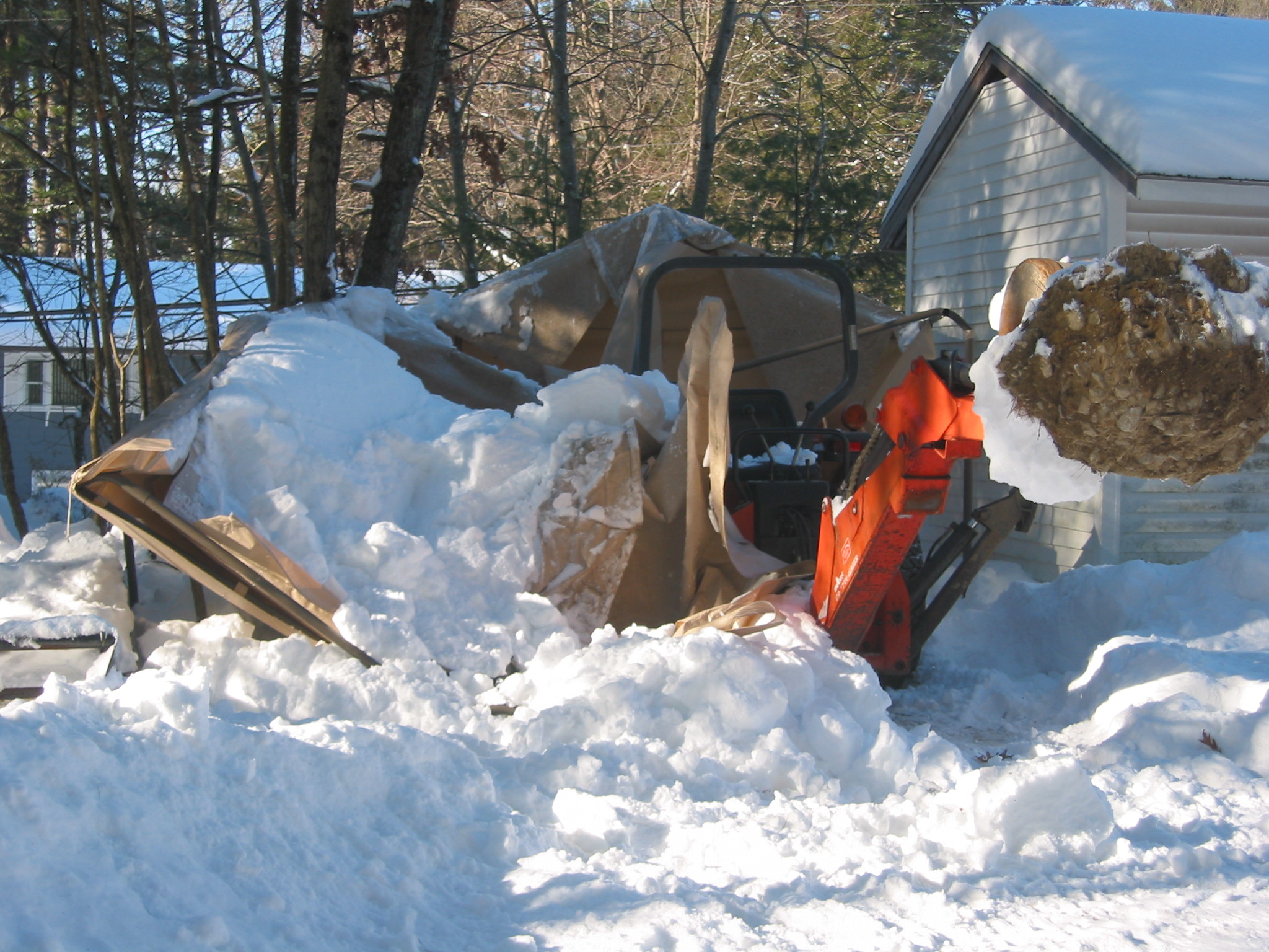

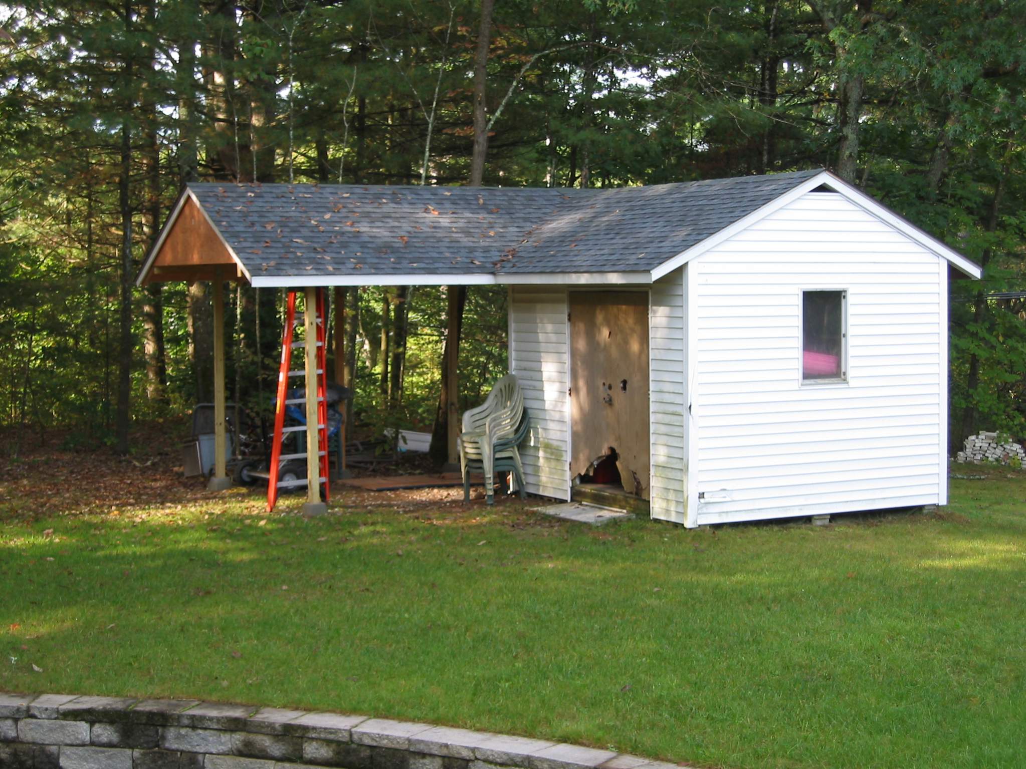

I replaced my tent with a roof addition on my shed - pic attached. I pole-barn roof can be put up for roughly tent cost (a good tent - not the Cosco special that I had) and it should last pretty much forever. Stand alone roof would be easier and cheaper than the addition I built.
